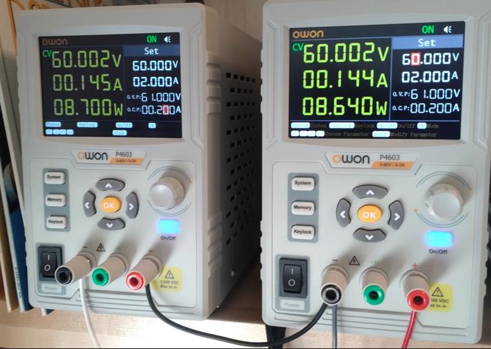

OK, powered the channel up (from power supplies) - nice and slowly starting from 40V gradually increasing to nominal 60V.
Seems stable, idle current is adjustable.
Screenshots ar from state of 10mV across emitter resistors.
Time to tidy it up and see what happens when powering from its main supply.

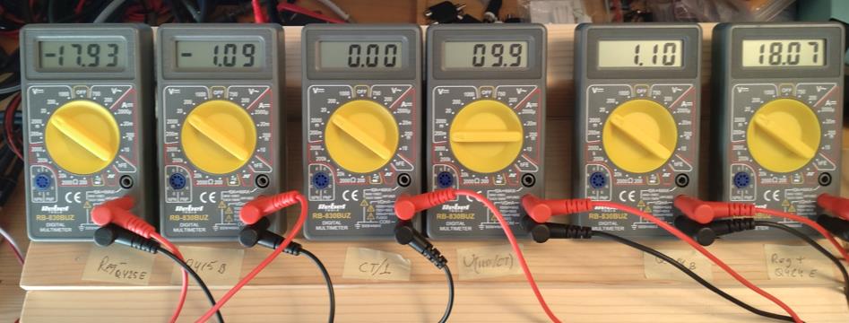

Ok, tested the rectifier and main capacitors under power - everything seems ok.
Connected the main capacitors to the amplifier board (rails) - and the channel output sits on a rail.
No smoke though.
After some quick measurements (when powering the amp for some seconds at a time) it surfaced the -18V of regulated power is missing:
https://www.diyaudio.com/community/threads/onkyo-m-5030-burnt-channel-rebuild.408391/post-7581007
Probably 2SK246 (Q423) is open (zener D408 both ends have the same potential).
Bridging Q423+D408 combo with 4k7 resistor (as has been done also in other Onkyo models) brought back the negative voltage and also the output voltage returned to zero (speaker relay activates now normally).
B1 is +/-60V, 2SK246 is 50V by datasheet - should I replace (as precaution) also the other ones in the similar function i.e. is it a disaster waiting to happen?
