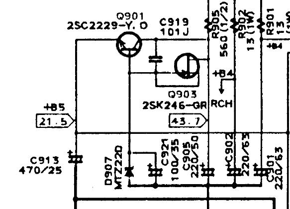

Why not use a variac or DBT?
The VAS stage gets itself powered via regulatros which do not work with lower mains voltage (Onkyo dropped that complexity in later models and did not use it earlier if my memory serves me correct):

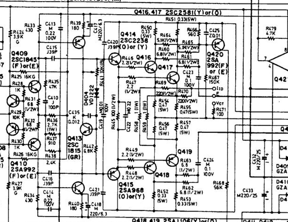

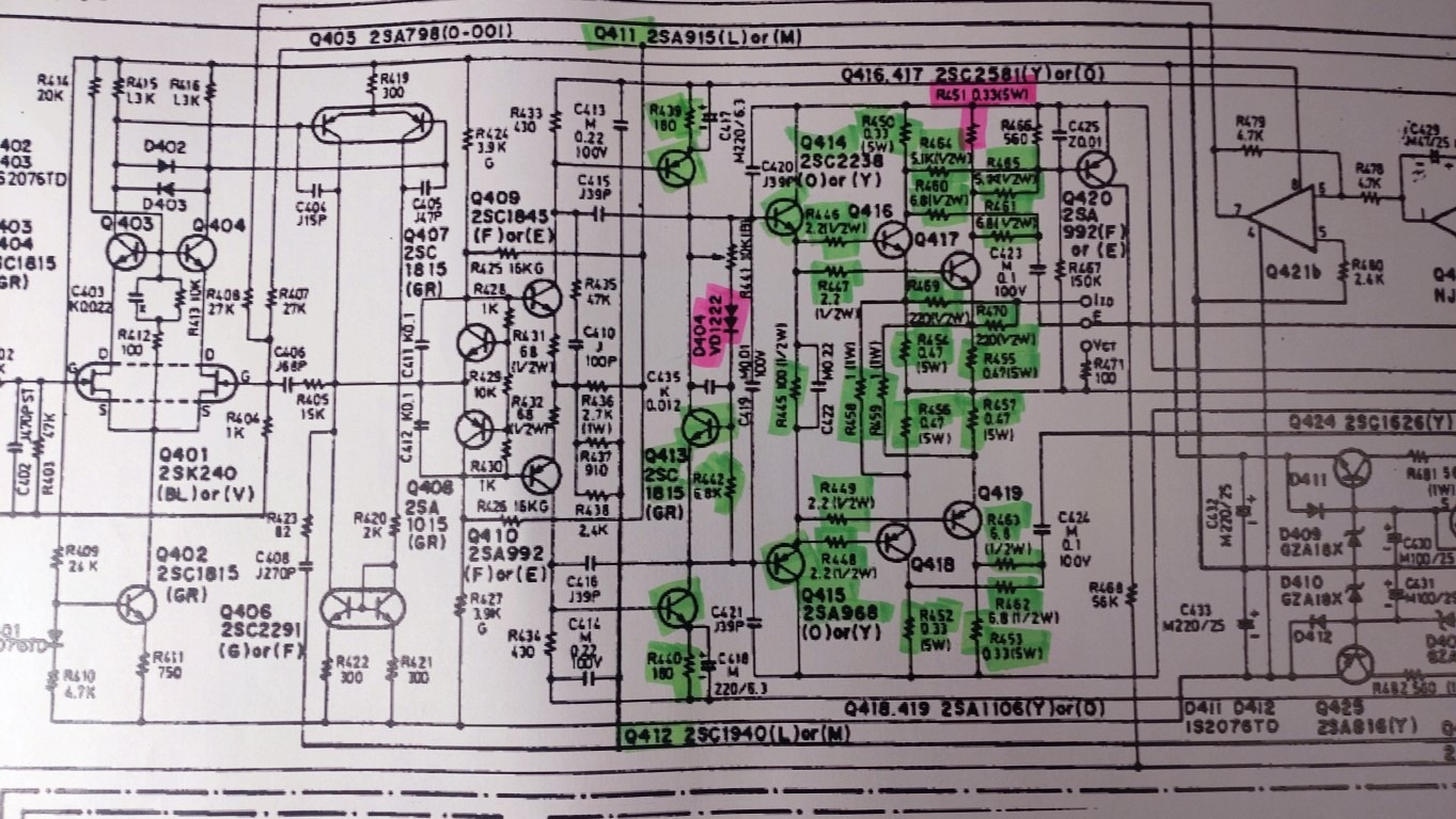

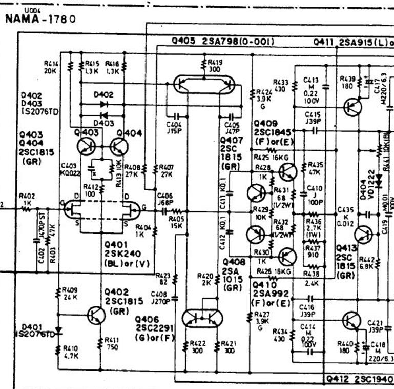

Yes, there was nothing alarming. Also the transistors did not heat up abnormally - I monitored them with an infrared thermometer (and also with a finger tip).Did you measure the rails with the 100R resistors in place?
You need output transistors not from ebay!
Use equivalent modern transistors from Mouser or digikey,replace the drivers too.
A common fault reason is the Q404=VD1212 in the bias circuit.This is here for temperature compensation but if this fail, (resistor jump) bias is full and outputs burned.
The current set is modern, also the drivers if I remember correctly.Use equivalent modern transistors from Mouser or digikey,replace the drivers too.
I will unsolder them all and check.
Please read D404 not Q404.You need output transistors not from ebay!
Sorry.
No problem, I will just start checking the components, it will take some time. All resistors in the output stage need to be checked too - last time I found a couple of defective ones which had no visual indication of being damaged.Please read D404
I believe this is an Onkyo specialty.last time I found a couple of defective ones which had no visual indication of being damaged.
I have often had this happen and at Luxman too.

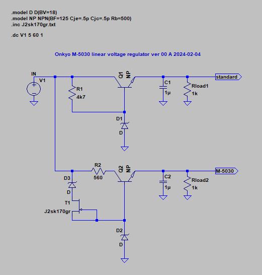

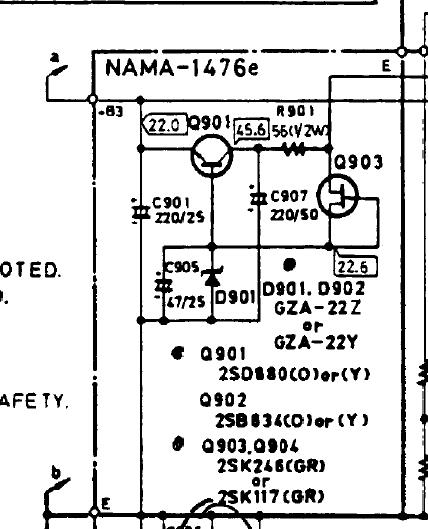

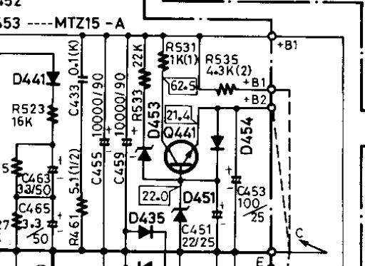

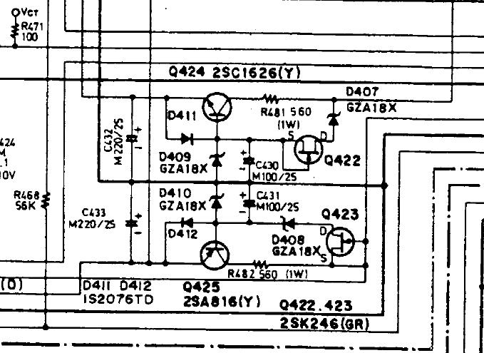

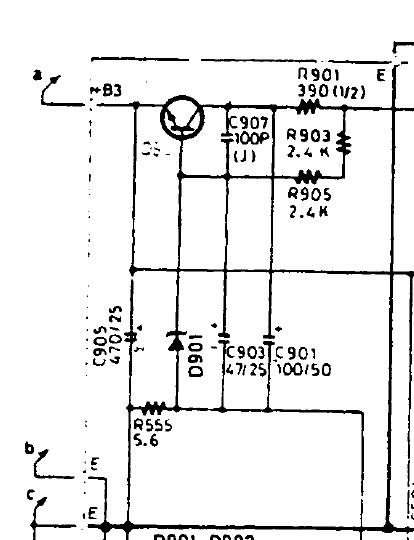

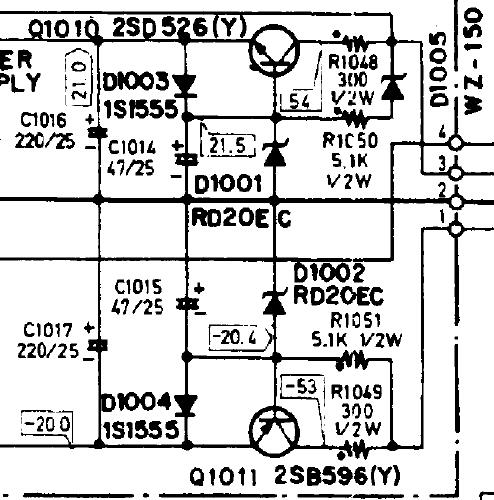

While checking components a question:
should I replace the zener and fet (from regulator transistor collector side to base)
with a resistor like in A-8250:
so that I could use variac and DBT while testing?
Onkyo seems to have solved this circuit in very many ways in its different models - with a resistor, with a fet, with a zener, with zener and fet (amples are in the attached images)...
OK, finished component check in the outpt stage.
As suspected by thimios, D404 is open.
Other transistors and resistors (except a cracked ceramic 0,33R resistor on one output transistor collector) are fine.
Question: what should I use for replacement or could these diodes just be eliminated?

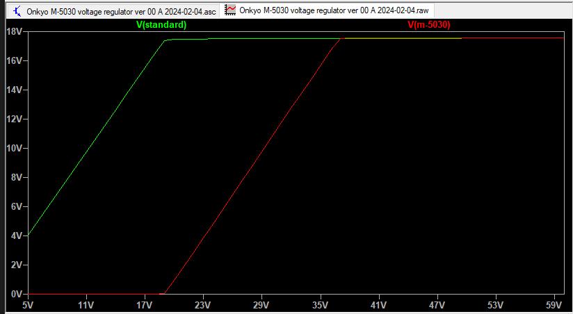

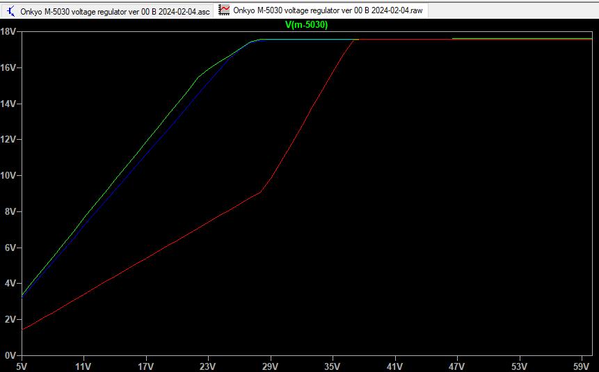

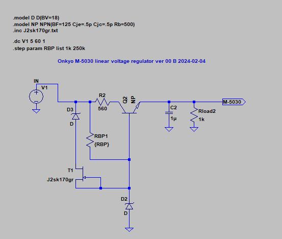

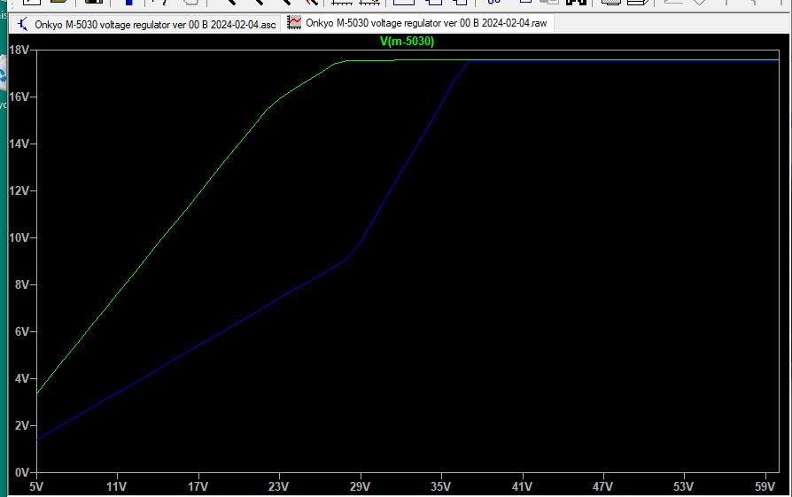

OK, did a simulation in LTspice - seems that I need ca 40V as B+/- in order to have proper regulated voltage for VAS.
Question is - is 40V (on rails) a safe starting point (when using a variac)?

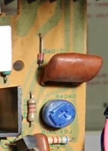

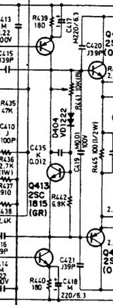

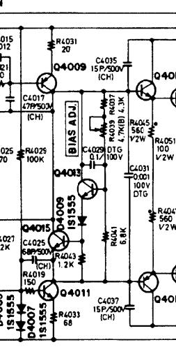

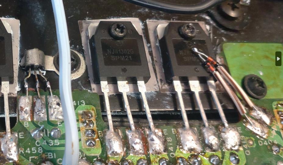

About thermocoupling D404 to the output transistors:
M-5060 is a predecessor of M-5030 (as far as I could learn from the net) and similar diode D4009 in Vbe multilpier:
is located on the board (Q4013 is mounted on heatsink):
In m-5030 Q413

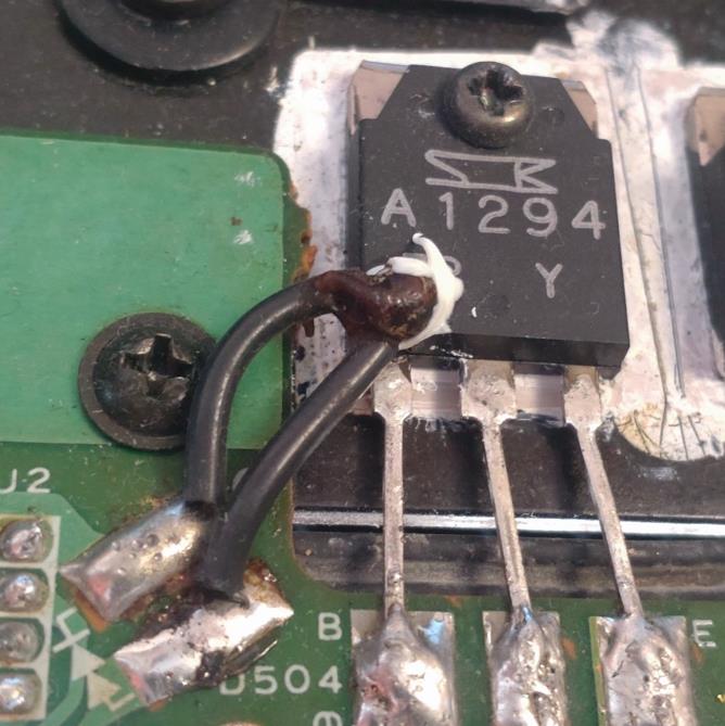

is mounted on heatsink (i.e. thermally copled to the outputs) while also D404 has originally been glued to the collector ping of an output transistor.
After replacement of the outputs in one channel I glued (with thermo-glue) these diodes to the plastic body of the output transistor:
So with replaced diodes it would look like this:
Is such an arrangement really necessary or is it over-engineering from that time?

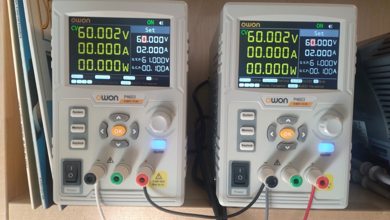

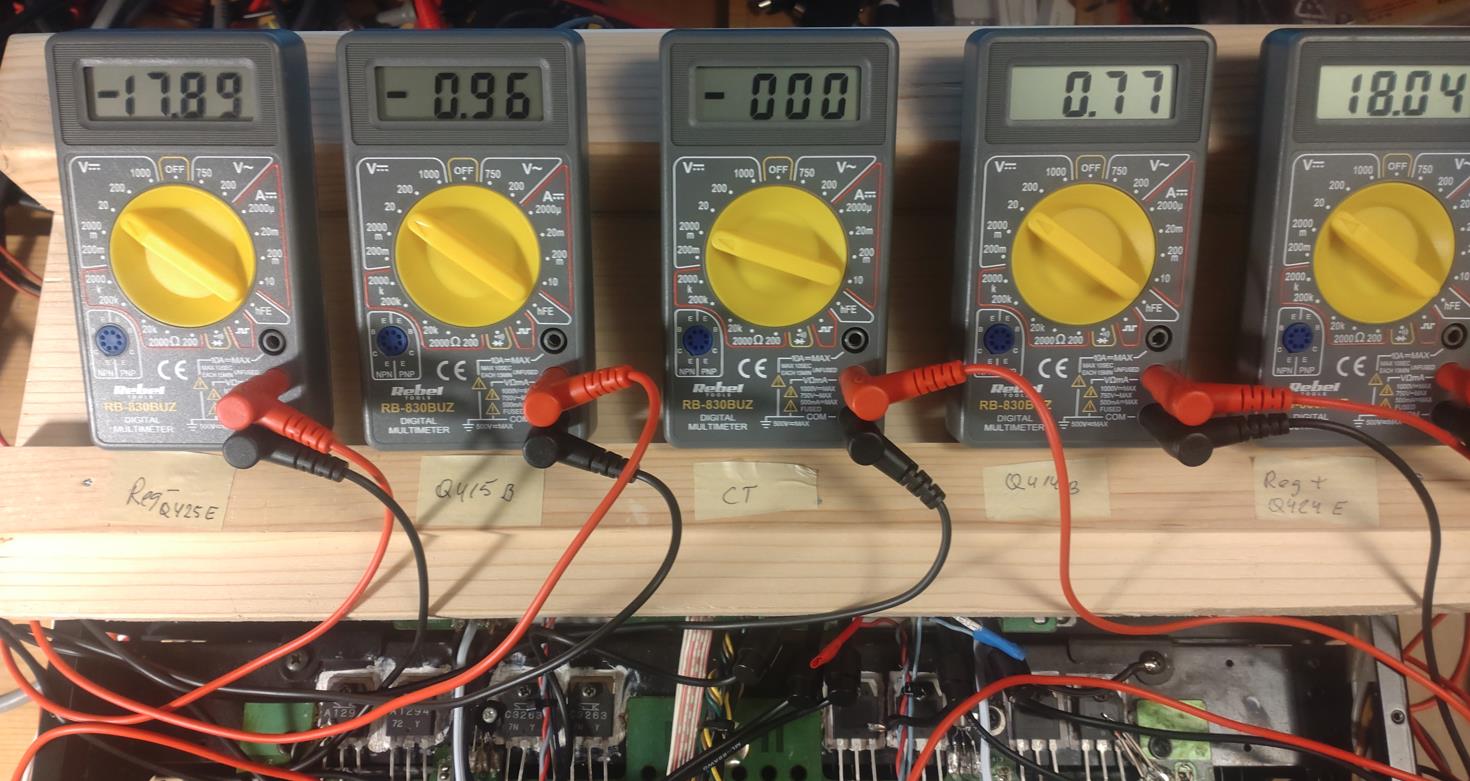

Powering up - step 1:
B+ and B- to output transostors, driver transistor Q414/415 bases shorted and overcurrent sensing tranistor feed resistors R464(465 lifted - 0 mA current @60V , at least it is not smoking or burning...
Powering up - step 2:
B+ and B- to VAS and Vbe stage (these have separate wiring from main capcitors than output transistors and their drivers).
Regulated voltages reach nominal values at 40 V, current draw is stable around 50 mA @60V:
So far, so good.
So far, so good.
