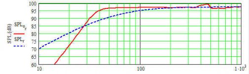

The BMS is a poor choice also, though for a different reason. Today's prosound drivers have very stiff suspensions to keep Vas as low as practical to keep box size user/shipping/storing 'friendly', which yields a similar underdamped response as the high Qt drivers, though if you stuff the vents its response is somewhat better overall Vs the high Qt drivers. Still, it defeats the point of building an Onken, so why bother?
To keep the vent length <35 cm, a n = 18.4! was required, another consequence of the driver's relatively small Vas.

I start to believe that an Onken is a good thing for a midwoofer, but not ideal for a sub. In the last Hobby Hifi they had a Linkwitz style dipole sub with 18" drivers, quite simple correction and very good frequency response. You have to move some air to make the acoustic short-circuit become irrelevant, and obviously this also works with large surface, not just with shwabbly 30mm excursion drivers.
Yeah I don't think the Onken would be my first choice for performance below 30Hz unless I had a lot of room..
According to my simulations the Eminence Delta Pro 15A will work well provided that you keep source impedance under an ohm or so. There are several other eminence drivers like the kappa pro which I think might also work ok. You may find several less expensive Eminence drivers that will work with the right rg in series with them.

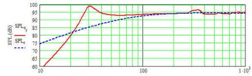

I designed my cabs to work with a number of drivers, with some compromises for some choices. Cabinet/port dimensions are fixed, only n and rg can be varied. Within those limits several drivers work well. The Iconic is the best match to the box, and despite its really high price tag is what I am getting.
I suspect it might be easier to design using an inexpensive 15" which is probably less expensive than even two inexpensive 12". Surface area of 2 x 12" is pretty close to that of a single 15" as well.
As GM states I will be using a fair amount of series resistance to get the low frequency performance I am looking for.
My cabs overall volume is about 11 cu ft. N=5.7 and -3dB right around 38Hz. Efficiency about 97dBspl estimated.
