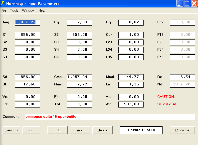

4X eminence delta 15B Ripol low up to 200Hz. http://www.eminence.com/pdf/Delta_15B.pdf

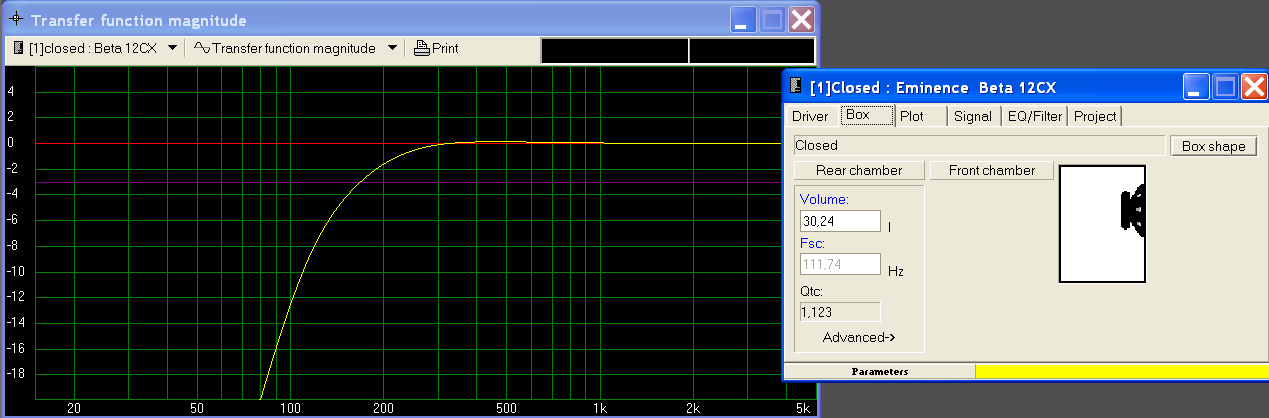

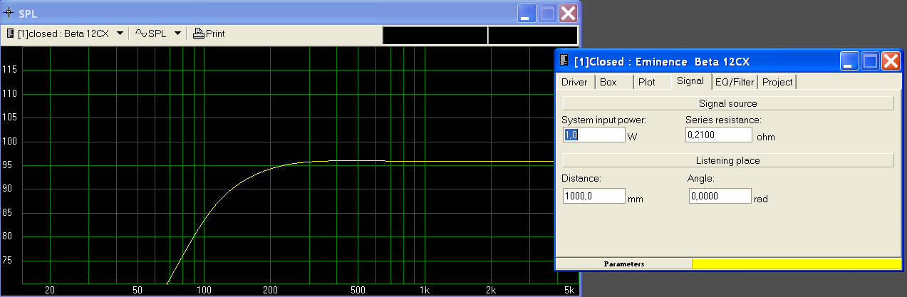

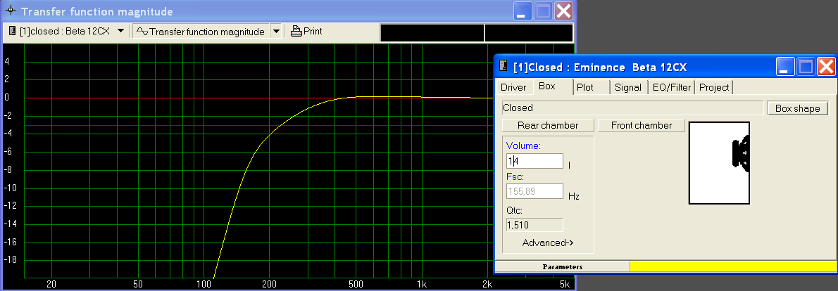

1X eminece beta 12cx coaxial unit in a closed box.
http://www.eminence.com/pdf/Beta_12CX.pdf

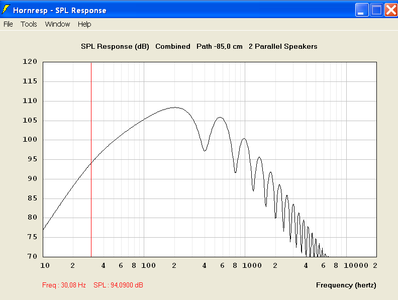

This system will make a 96-97dB 1Wmtr 30Hz-20kHz with right placement even 20Hz -20kHz 96dB 1wmtr is possible with the room gain.

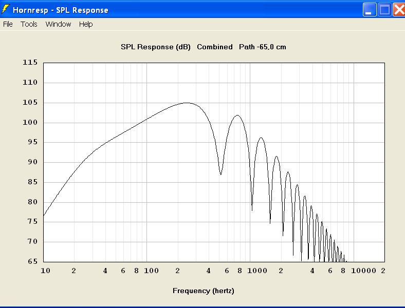

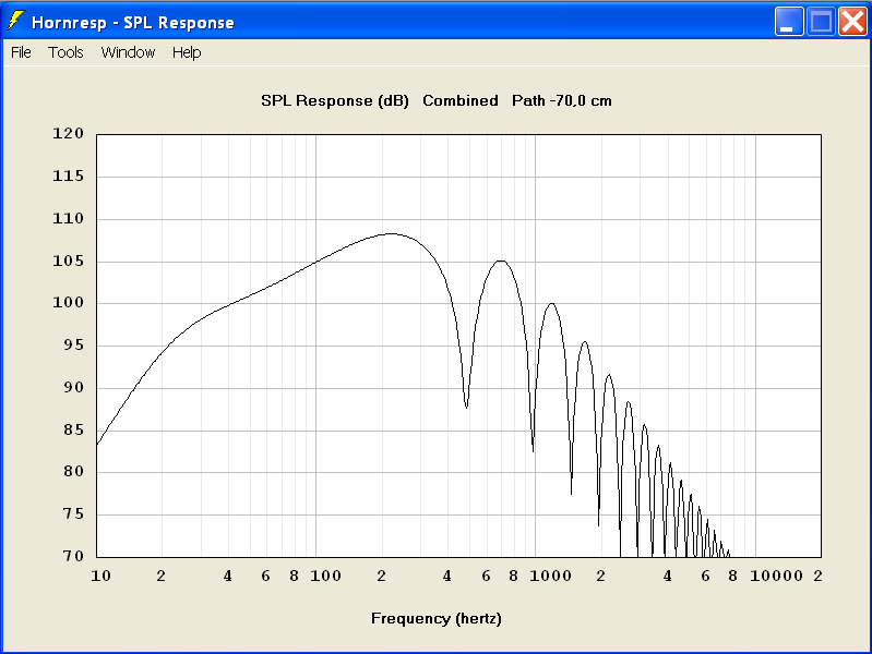

See attached simulations of the ripol. This is the response without correction with a choce you make the response flat 40Hz-300Hz

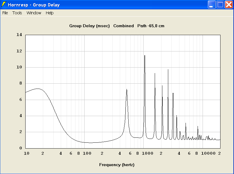

Simulation of the group delay is even better than most closed boxes. You do not need to compare it to BR.

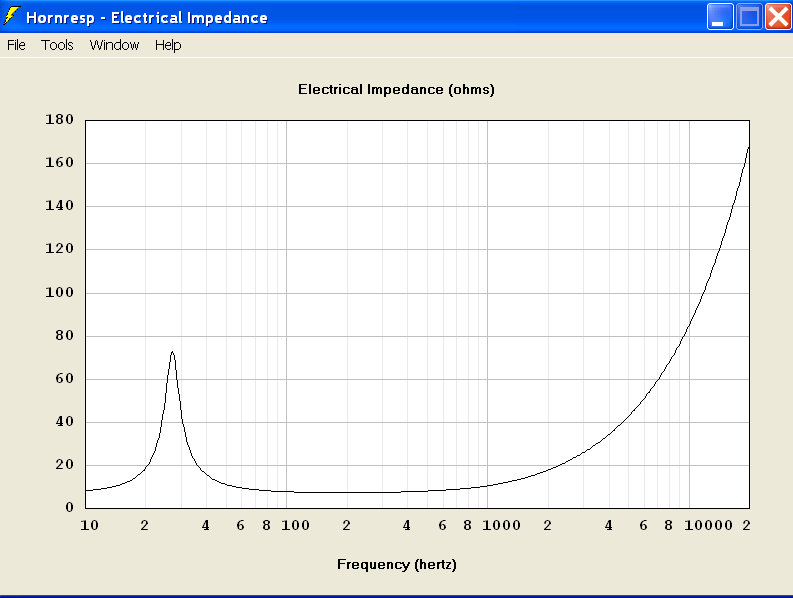

Efficiency at 1W with corner placement. Look at 40Hz because from there we make the response flat. It shows we can have 100dB at 1W.
So I predict a efficiency of 100-96dB (depending on placement) at 1Wmtr 8OHM 30Hz-20Khz. With super groupdelay and subbas extension down to 20Hz. That in a super compact design of 45X40X83 cm 150liter. XO 200Hz-800Hz.
You will need about 15mH R=0,7 Ohm choke to make the response flat.
