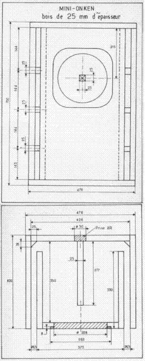

About minionken, it is published in l'audiophille, I don't have full text, I have only pictures. Box is designed for focal 10c01, but it is suitable for two more drivers, one is lowther pm6c and other i forget. If I get complete text from friend which has it i will post a scan. Noe I have only box dimensions and design, I attached picture.

Thanks, don't recall seeing this one, but now I know what drawing Dave began with for his mini-Onken. 😉

GM said:but now I know what drawing Dave began with for his mini-Onken. 😉

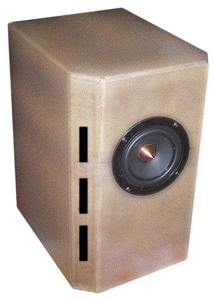

I don't know that i have seen that one before. My miniOnken was inspired by the Solo 103, and aan Onken bass cabinet published in a late 70s Audax publication. The angled bits at the front are all mine,
The 1st one out the gate (below) was a cardboard mockup (BTW, the insides follow the golden ratio).

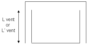

L is the acoustic length and L' is its physical length (shorter of the two).
