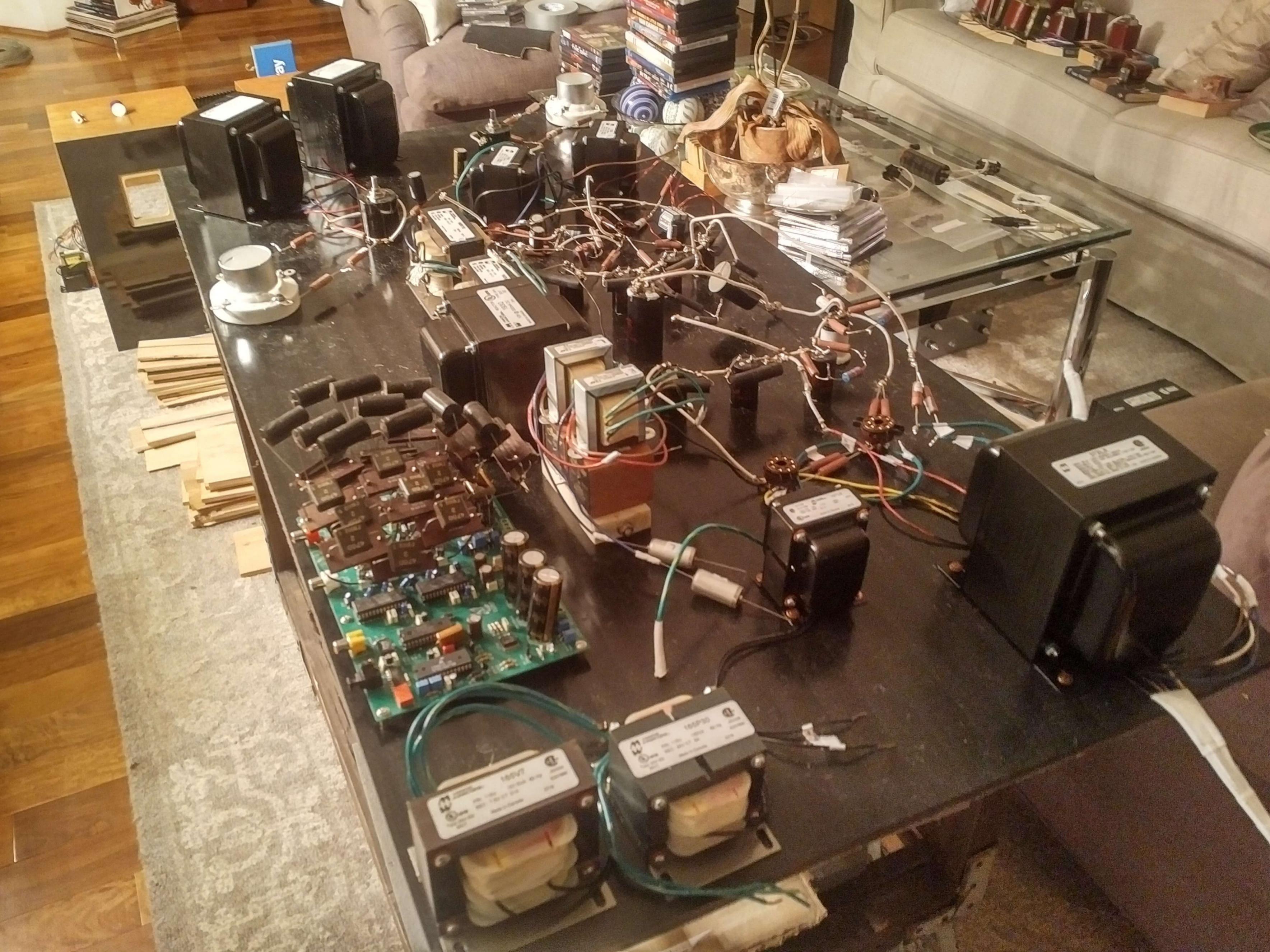

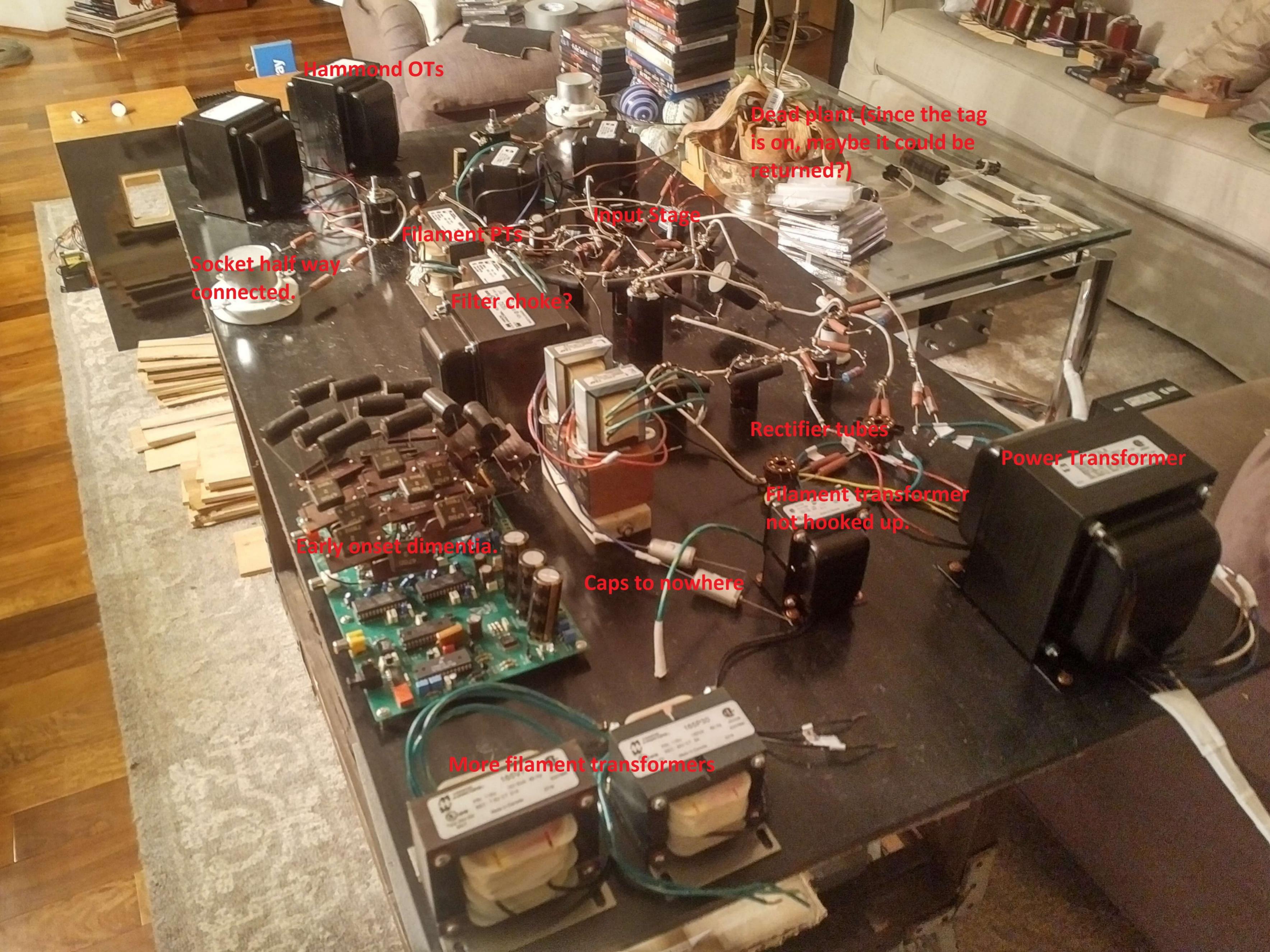

I did not make my post to criticize or scare you away. I, and others do not understand the references to car parts, or why they would be here at all. Everything I could identify in the original pictures seemed to be new parts that could be used in a 211 SE amp, except for the opamp board with all the extra caps.
Some of your posts in other threads have left everyone wondering what you were talking about. I really thought that you might have been using Google translate to convert from another language.
The clearer picture from the other side of the table does seem to reveal a power supply with a choke in the ground side and one channel of the driver circuitry. I can't follow enough of it to know if it matches the schematic I used.
As with my build, I would test one stage at a time starting with that power supply. Use a dim bulb tester on first power up to avoid expensive surprises in case something is not right. Remember that this amp used a lethal level of voltage and one mistake could be your last.

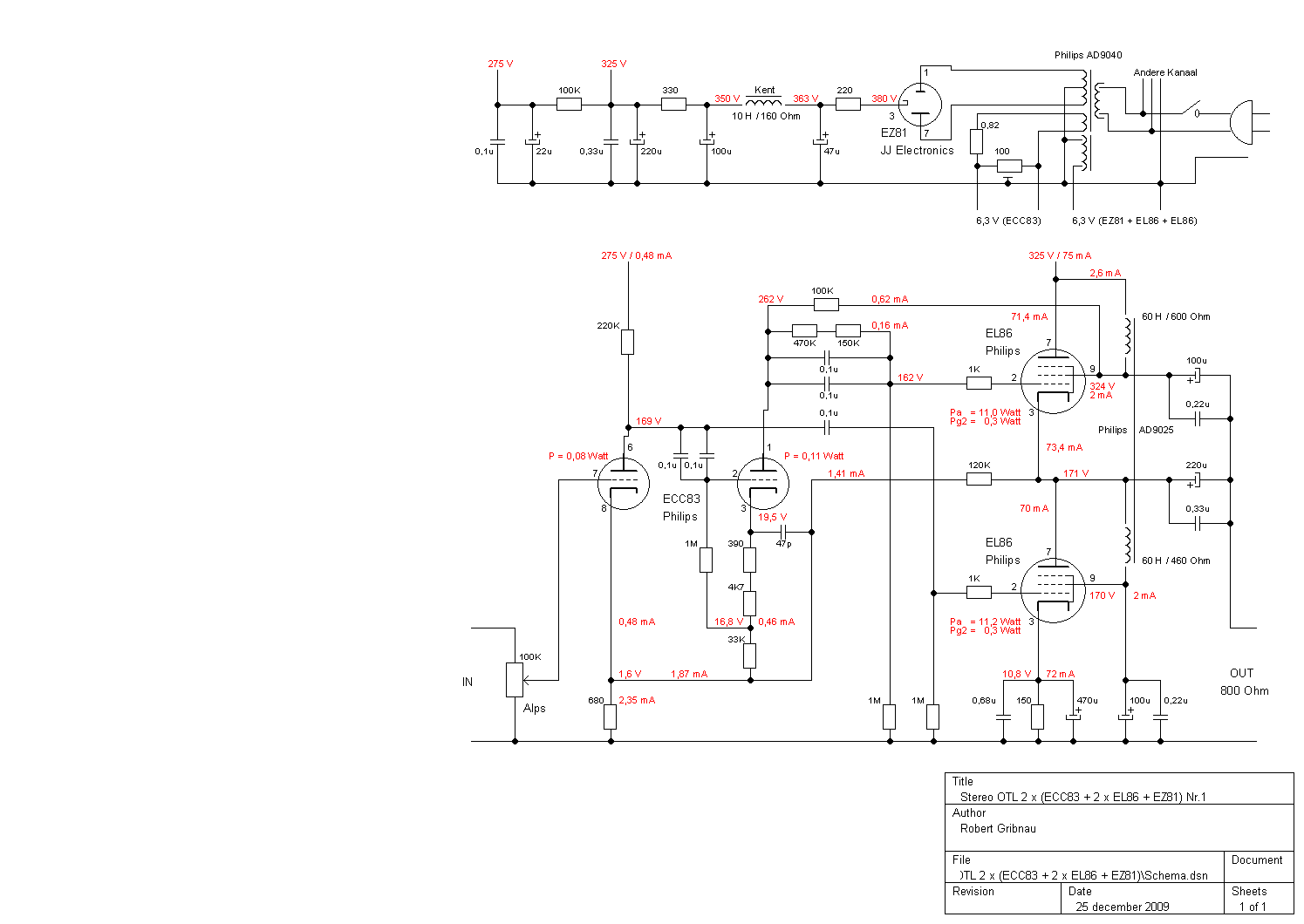

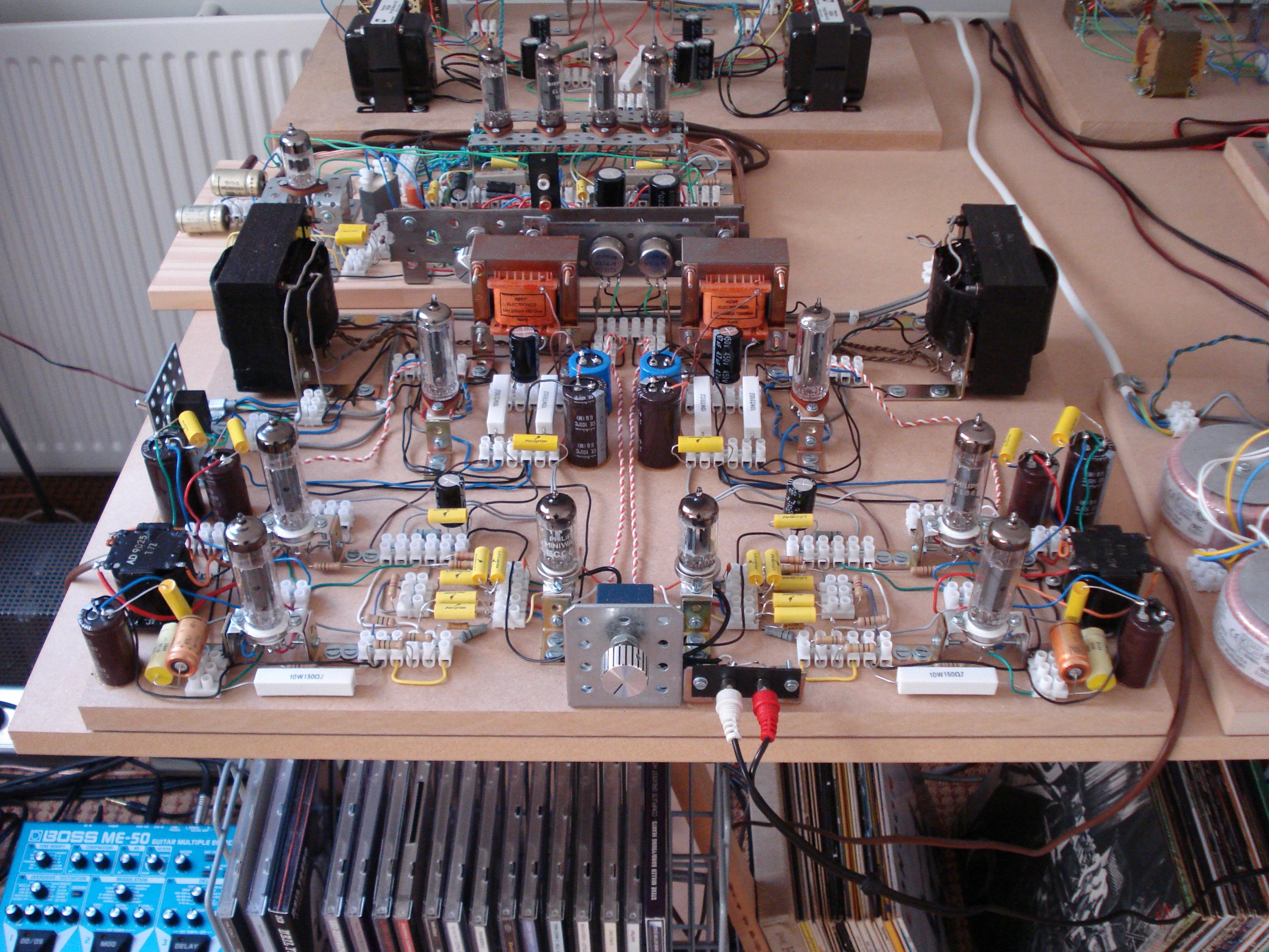

You can build on planks though. Here's an otl amplifier for 800 Ohm speakers I have built some 11 years ago (a proven design by Philips). Works fine. No noise or other issues, even though there's a lot of both positive and (more) negative feedback going on.
Nothing directly. But since this thread became one in which the way of constructing the (or any) amp also plays a role, I thought this was relevant enough.
Nice work there PCL200!
