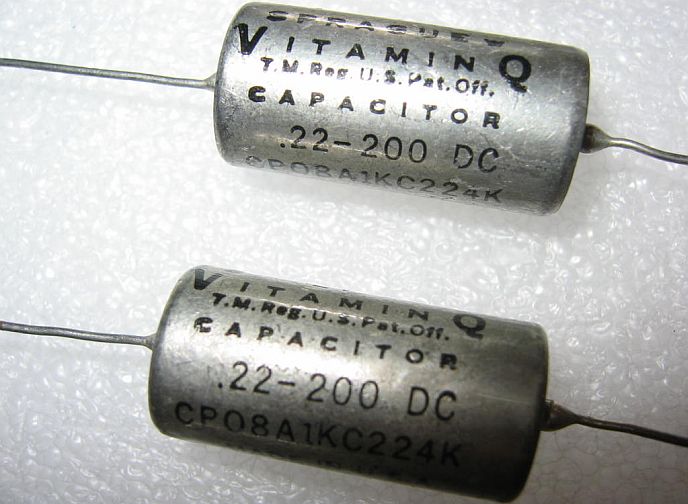

that is a good lookin amp-
4325565 vitamin Q
