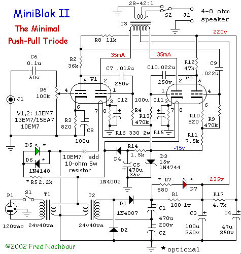

Thanks, I also finally got to making a schematic for exactly what I'm using now. With the turntable, I needed to add a 3-prong grounded cord to get rid of hum almost entirely, plus I redesigned the voltage-divider-based, hum-reducing filament circuit so that it seems optimal now. Running from a CD deck it seems as quiet as a rock.
I based it on the Max Robinson design, as mentioned, but used two 6AV6's, and added a few tweaks. I only have 125vdc and 75vdc on the plates, respectively, and it's not super powerful, but does the job well, in my opinion, so far. I don't think I need to push the voltages any higher for more output, but opinions are welcome.
It can be built for only around $85 or so, with all new parts.
I made the drawing using Open Office Draw and the symbols from here:
http://library.thinkquest.org/10784/circuit_symbols.html
which I kept in a background browser window, and saved the ones I needed one by one, then resized/flipped/etc. the ones I used as images. Seems to be a good "draw" app, for free, hard to line things up at times, but I'm new at it, in the past I did everything by hand. So here's the schematic:

Were it me, I would probably place the pot in btween the stages, because you can use your guitar volume on the first stage. I would get rid of the NFB in a guitar preamp... ( the 220k resistor running from the output to the cathode of the first tube)
do 1.5k on the first cathode and add a .68 uf cap...and replace the .0047 cap with a .047, or your bass will be very limited.
look up ax84's high octane or P1 for some similar schematics . Also note that some of the old kay/harmony/silvertone line operated amps used a 12av6 as a preamp.
Thanks Dude, I made a note of those mods for guitar amp use as this question comes up too. It seems well suited for hi-fi the original way.
What effect would the .68 uF cap have in parallel with a 1.5k resistor at the first cathode?
Anyway, without the NFB it's a clean 2-stage rather than an interdependent, and that's a good design as well.
I've been looking for a "series" gain block like you mention with these 2 tubes.
Actually, I'm using a .047 instead of a .0047 for the cap you mention is off a bit, hadn't noticed that, good catch. There was a typo on the verbal description from where I got the original idea for this, and which I used when making the schematic, mentioning a .0047, so I'll have to repost the pic, hopefully have it fixed as we speak...

the resistor changes your gain, the capacitor keeps a fixed bias voltage on that stage. You will notice a little better bass performance, although not much with that size cap. A larger cap will bring out more bass, but could cause blocking distortion if being used as a high gain pre. I'm confused, is this being used for guitar or hifi pre? You mentioned in your earlier posts that a guitar didn't have enough signal to drive your amp...
BTW: NFB in guitar amps is typically tapped off of the OT of the power amp, as in a later champ circuit. Here is an example:
