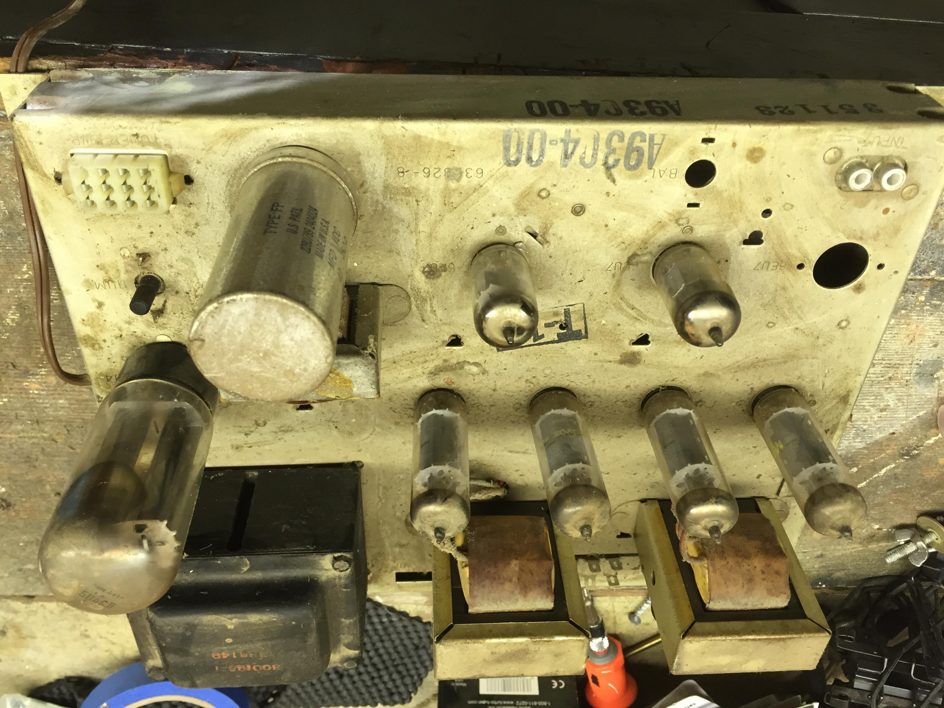

It certainly looks like a typical symptom of a bad coupling capacitor.
How difficult is that going to be to replace? Is it something I can do on my own using the resources on this forum?
I'll try to get the amp pulled out tonight so I can look under the hood.

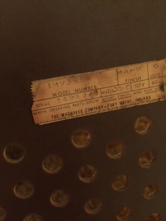

searching with the model number you supplied turns up references to replacement stylus/needle.
can you confirm that that is the model number for your console?
I noticed that as well. However, the attached photo shows the label that is found on the rear pressboard panel of the console. Also, searching for "1MV358R" ('8' instead of '9') turns up a "Magnavox Imperial 1MV358R console TV".

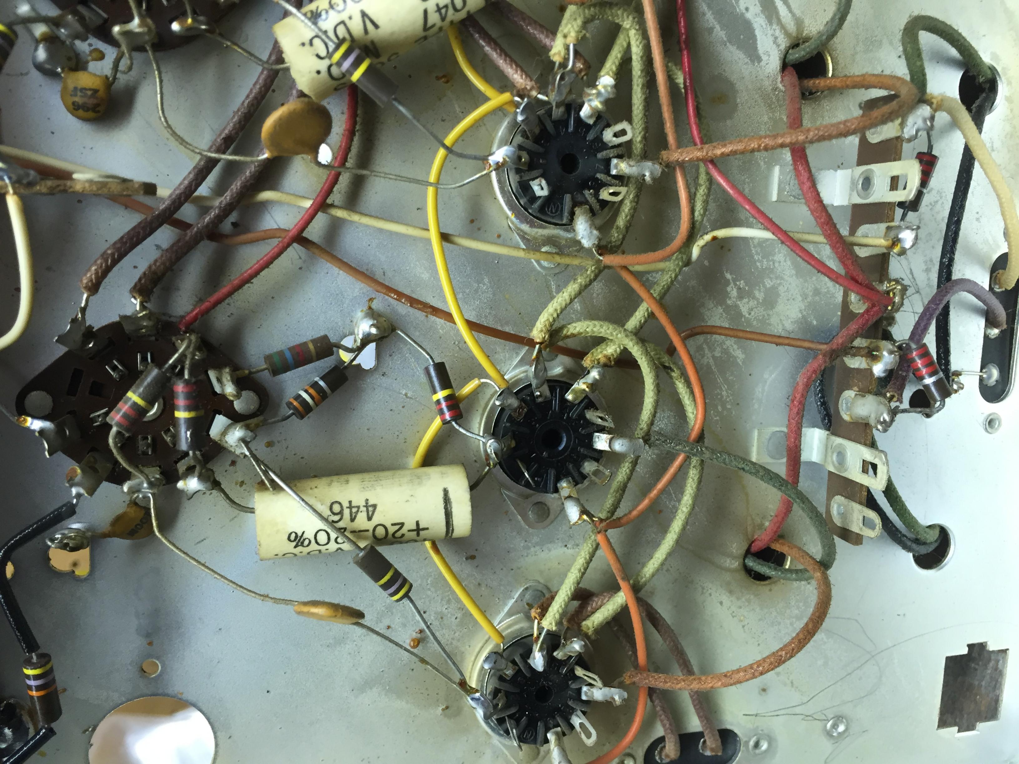

so with all the output tubes removed measure/test for voltage at pin 2 on the sockets (check all sockets) there should be nothing there.
It is pretty simple to replace the faulty capacitor.
It will most likely be the yellow ones. You can cut the old one out and solder the new one in its place.
Check the voltages with the four output tubes removed and make sure all the pin 2s are at zero volts.
Replace the capacitors on any that are not zero volts.

When you wrote "yellow" ones, were you meaning the caps with the yellow stripes or the the ones that looks like orange (dirty yellow?) discs? Also, what does "pin 2s" mean? I'm guessing it means the second pin (clockwise in the photo) from the empty slot on the black ring where the tub sits? It seems obvious, as they have the caps attached, but I want to be sure before doing anything. I'll be asking a lot of questions.....
The "yellow ones" would be the big ones, on the lower of the two you can read 446.
Pin 2 is the one these are attached to.
Got it. Thanks. I will try this as soon as I get home from work tonight.
let's reference the schematic the capacitors in question are labelled C104,C105,C204,C205 (note that the values for the positive half are 0.0015 mfd and the ones for the negative half are 0.047 mfd)if you pick any output tube (V2,V3,V5,V6) find pin 2 and follow the line back towards the input you will find them.
in the photo we see three of the output tube sockets and yes going clockwise (from the gap in the pin spacing) pln1 no connection pin2 the grid (input) tracing out from here on each socket you find the cap's in question, pin 3 (cathode with no tube installed you shouldn't see voltage here) pins 4,5 heater/filament (6.3 Vac) pin 6 n.c. pin7 (plate (output) CAUTION high voltage B+ here) pin 8 n.c. and last but not least pin 9 (screen/suppressor grid H.V. caution)
my money is on the big white 0.047
OK here's the part where my ignorant shows. I set the multimeter to DC voltage and put the leads on each side of the large yellow capacitor. The display shows around 170-190, but if I take the leads back off, the display does not go back down to zero immediately. It takes quite a long time to whine back down to zero. Both of the large yellow caps were in this range. Am I doing this right?
