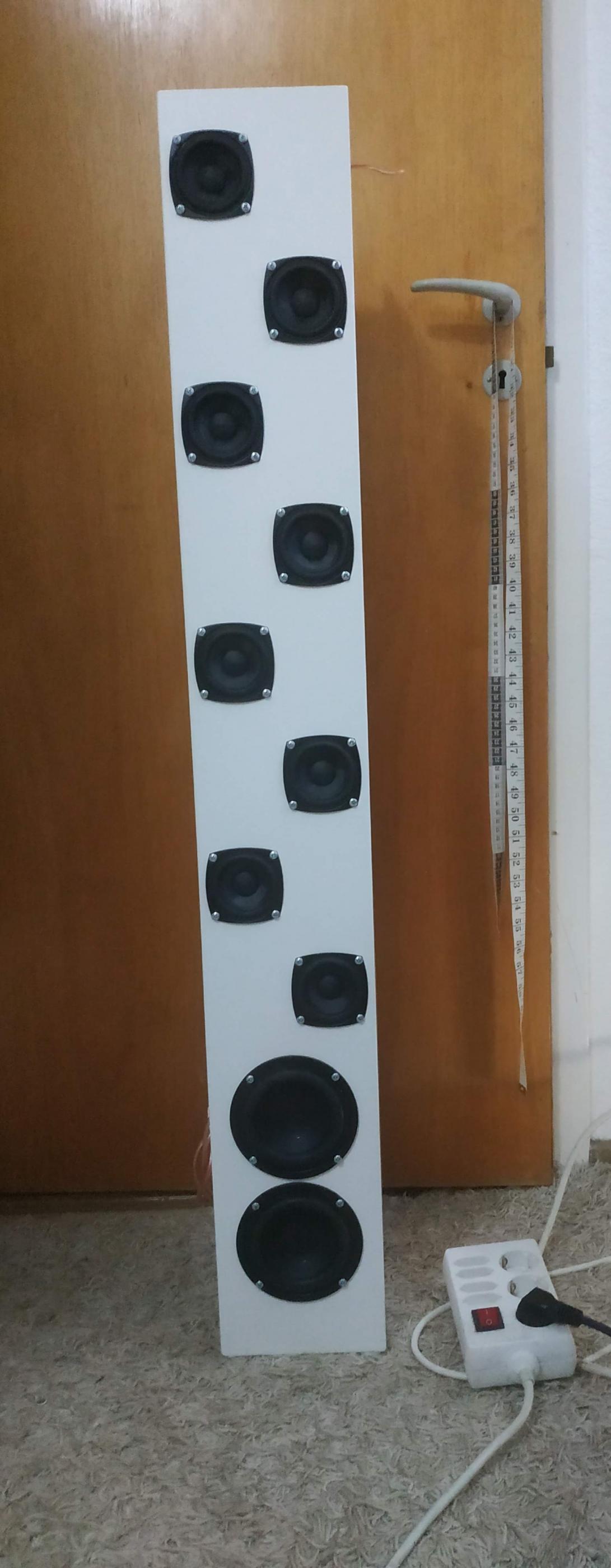

Hi all, I'm new here and I need Your advise on my "one person speaker" budget build, I look at it as a large BT-speaker I can wheel around.
It's been 25 year's ago I build my last speaker and I hardly remember anything... 🙁😛
I want to build a tall "personal" speaker, about (in metric) H110xW15xD25cm where the 8 full range drivers is installed in two vertical rows, 4+4 (L+R) on the top front. The subs hidden in the box in a vented configuration.
All driven by the built in amp and tranny linked to below, no filters wse...
All 3 channels running at 8ohm or if you think I could run the sub in 4ohm, if that for any reason would be better...
I am trying to keep a tight budget and wonder if this configuration is fair, does it seem alright to you who are way more experienced?
Any comment/suggestion in the right direction is warmly welcome!
My English isn't what it use to be so sorry if I making things hard to understand.
