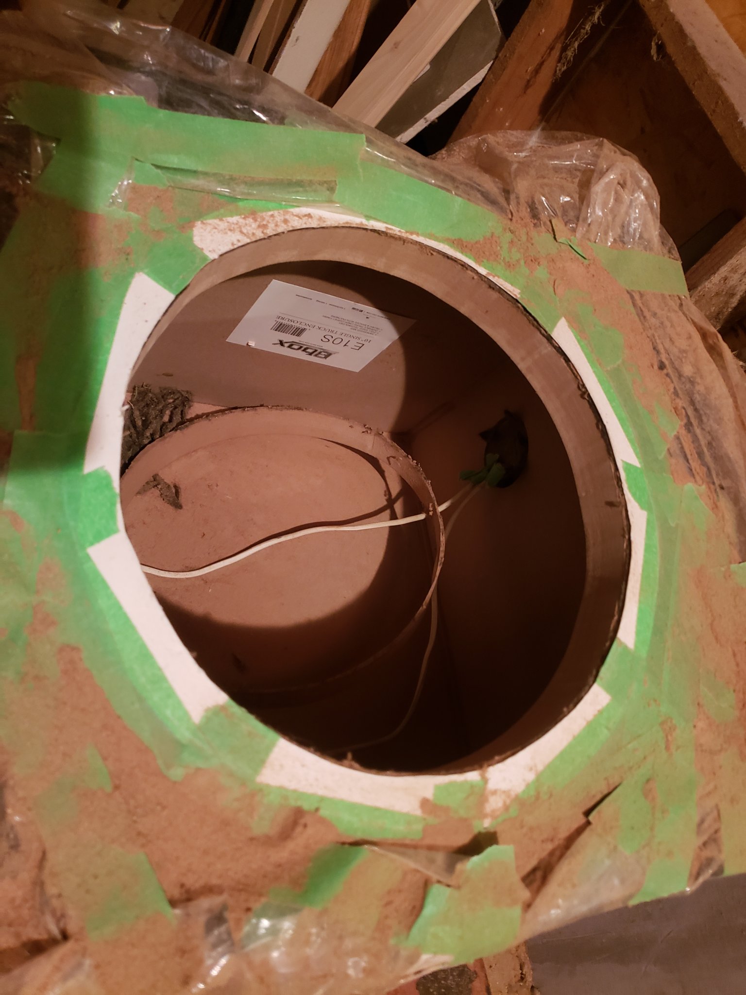

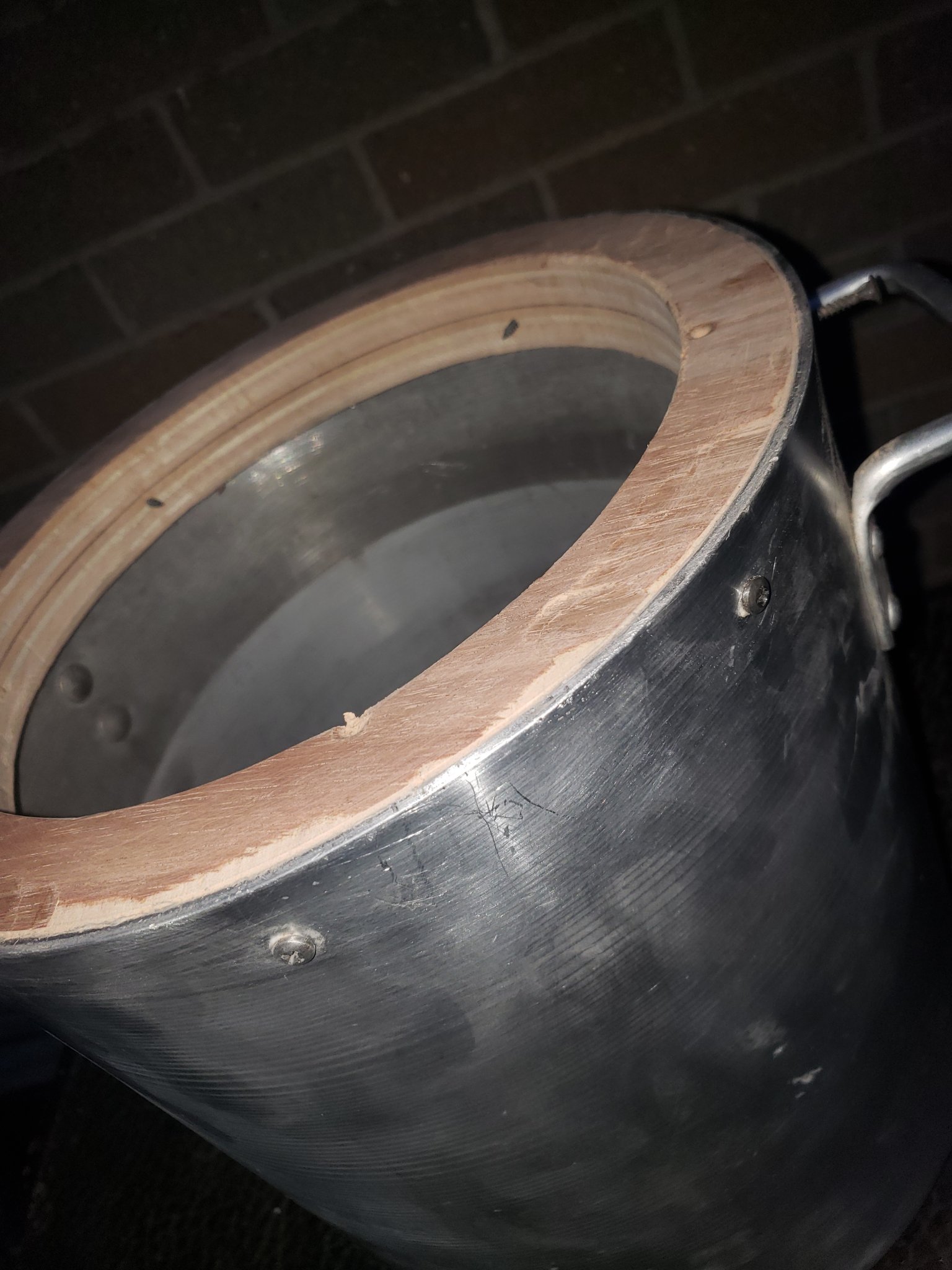

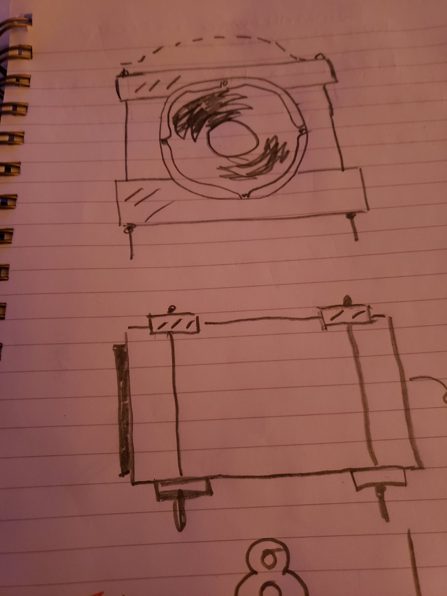

The flange is entirely encased in rubber, it makes a good seal without a secondary gasket.
I won't do another one without some precision guided cutting device.

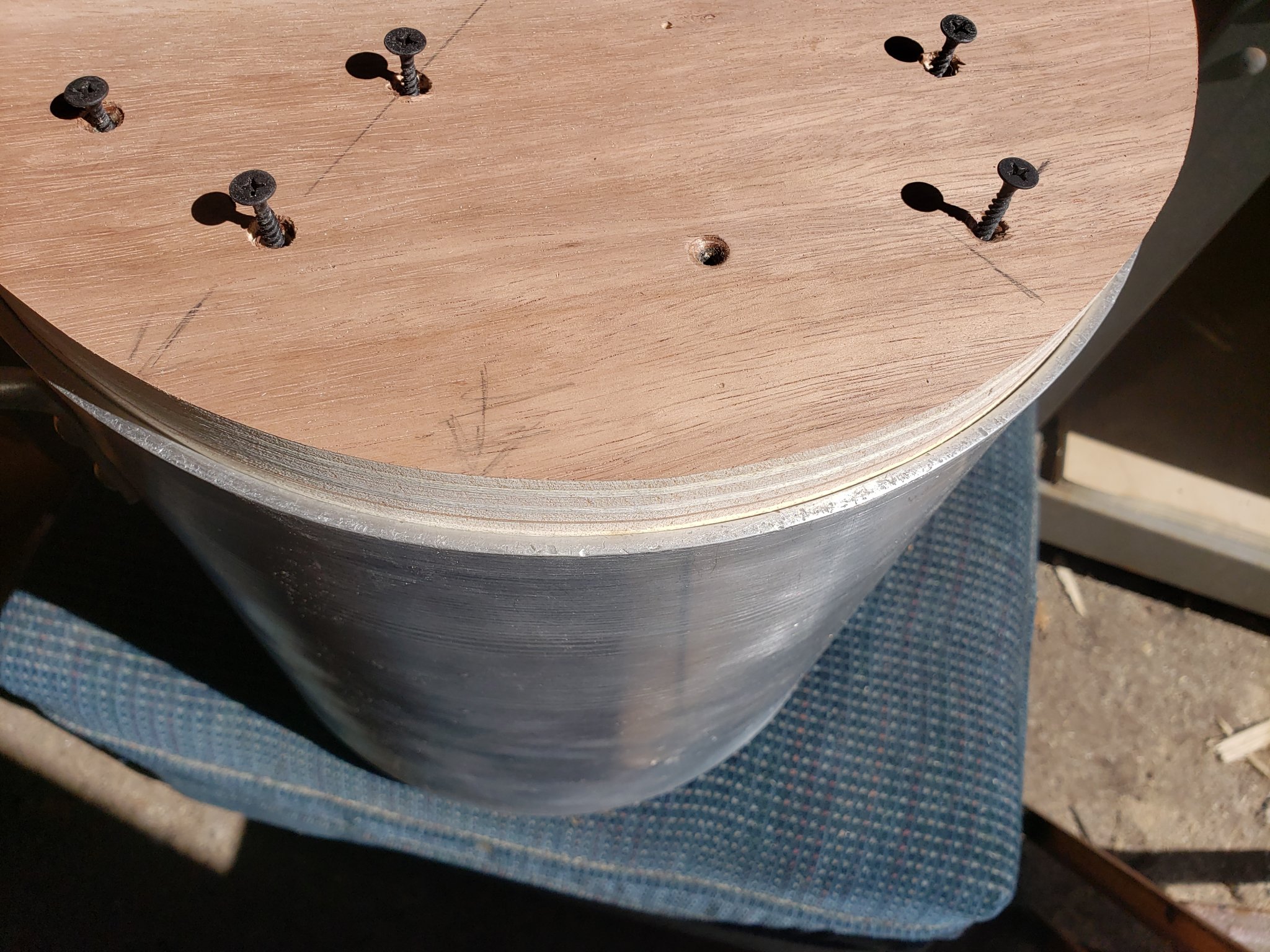

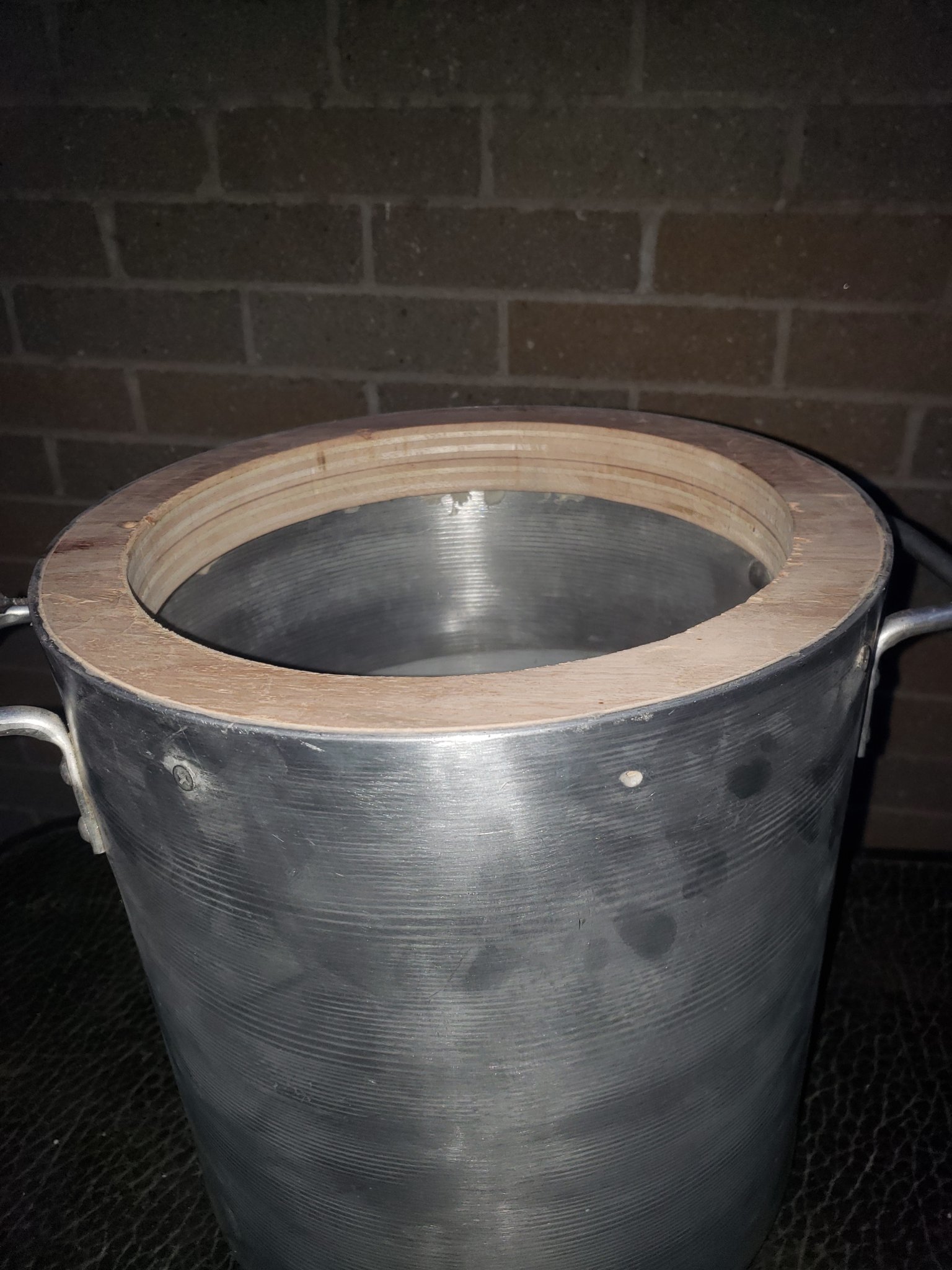

Tolerances should be within thousands of an inch, if you want it to perform well and also not look sloppy. Accomplishing one baffle with hand tools felt like a feat. of backyard engineering in itself. It took the good part of a day to make one baffle and two jigs 🤔
Well, I had to make two rings then sandwich them together, since I doubled up on the 3/4" stuff.

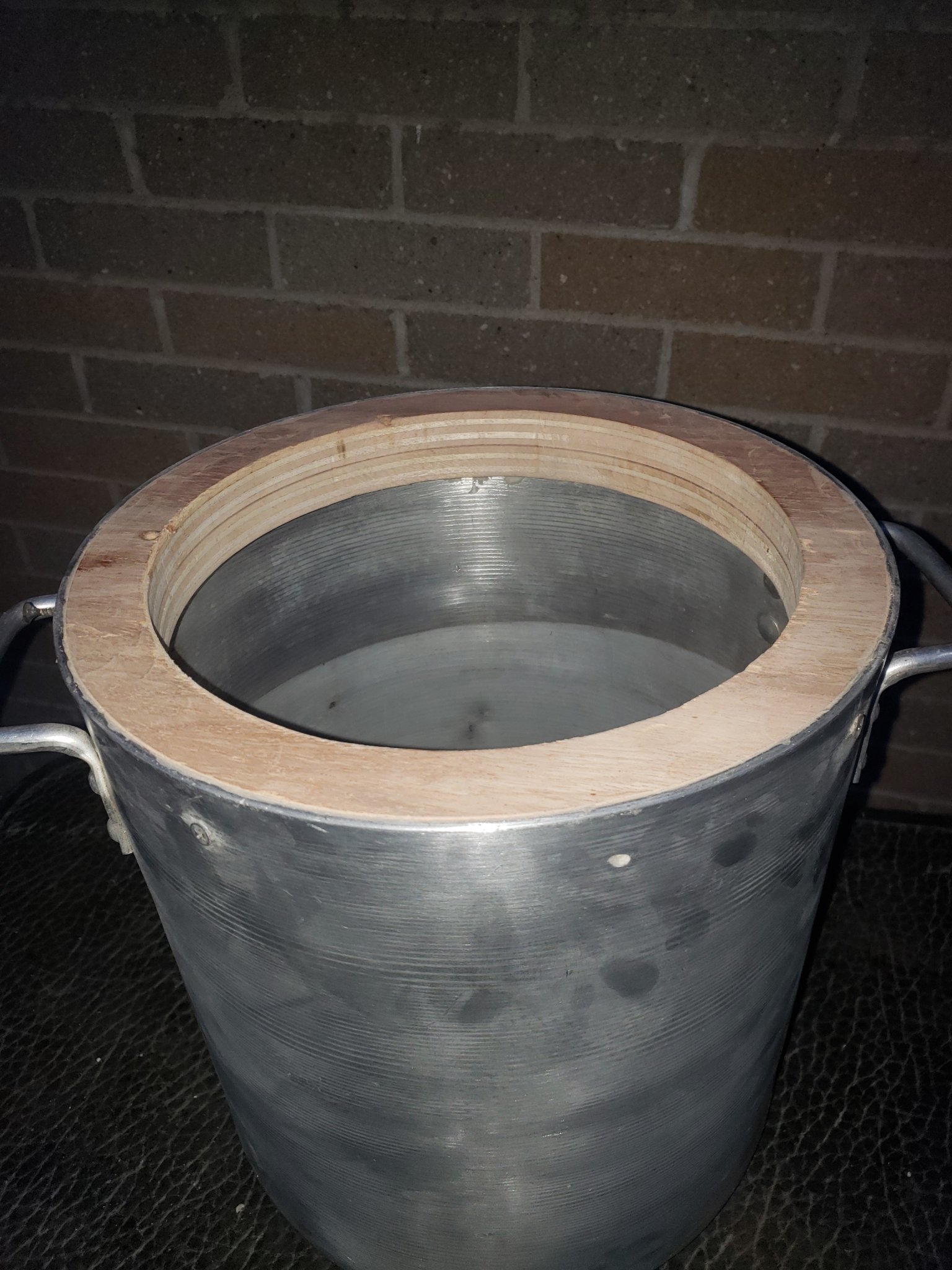

I linked the sub back there somewhere,
But here's how the gasket looks..
I could of used somethings else but prefer the look of stainless. And for its high tensile strength, it offers very little to no give. I used it for bracing. Those also suspend the sub a couple inches up off the floor. The footers will bolt directly to the bottom of that. Salamanders would look sleek on it. I'm good with results so far. Though I still want to frost finish the aluminum and shoot it with a clear, but I also must replace my sander first. I'll upload updates a bit later that can explain better than description.

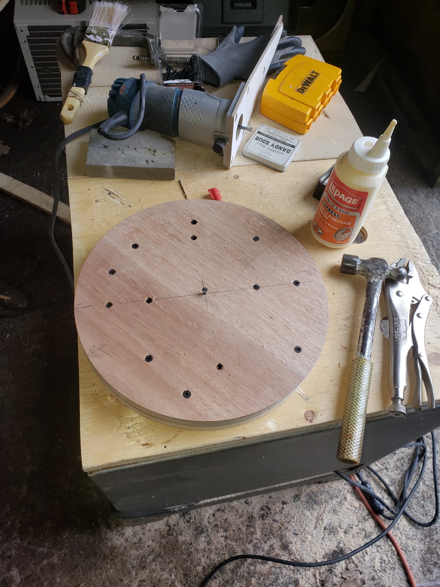

I got another baffle mounted. They take me about a full day from start to finish. I still have sanding to do, + + +. There is still a lot to do. I will press along with some form of Gallo Reference copy cats. It should be fun to build. I won't repeat the mistake on this one. I hope the hammer welts all sand out, and should. I should of removed a touch more material. Alsp I dimpled the metal when drilling, I bet the baffle hung up. I failed to clean those points better. By that point I was obligated. I had to pull out my steel machine hammer to seat it the rest.

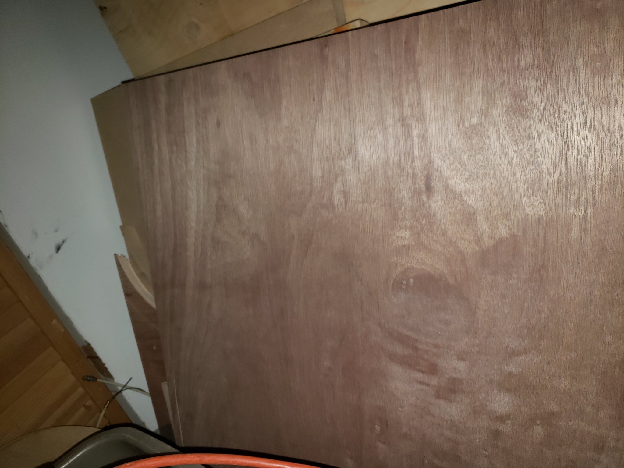

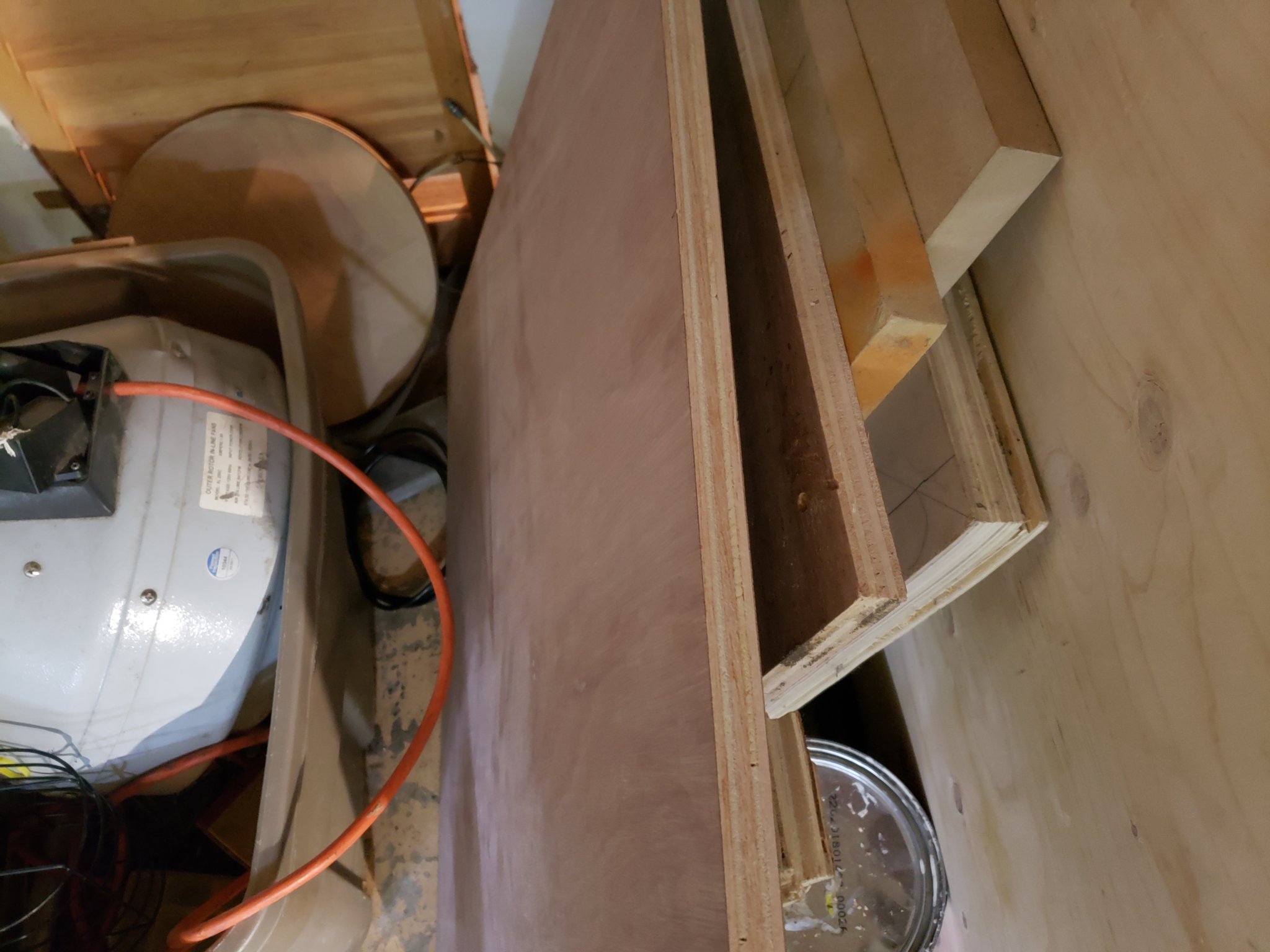

This is the hardwood walnut stuff I was mentioning jm (outer piece). I may not quite have enough for the entire cabinet, I have three x whats shown. The centre has a double thickness ply sheet all the way through. Sandwiched between several thinner. It makes a good solid thud when you knock on it. My understanding the guy I get some of that comes from diseased trees.

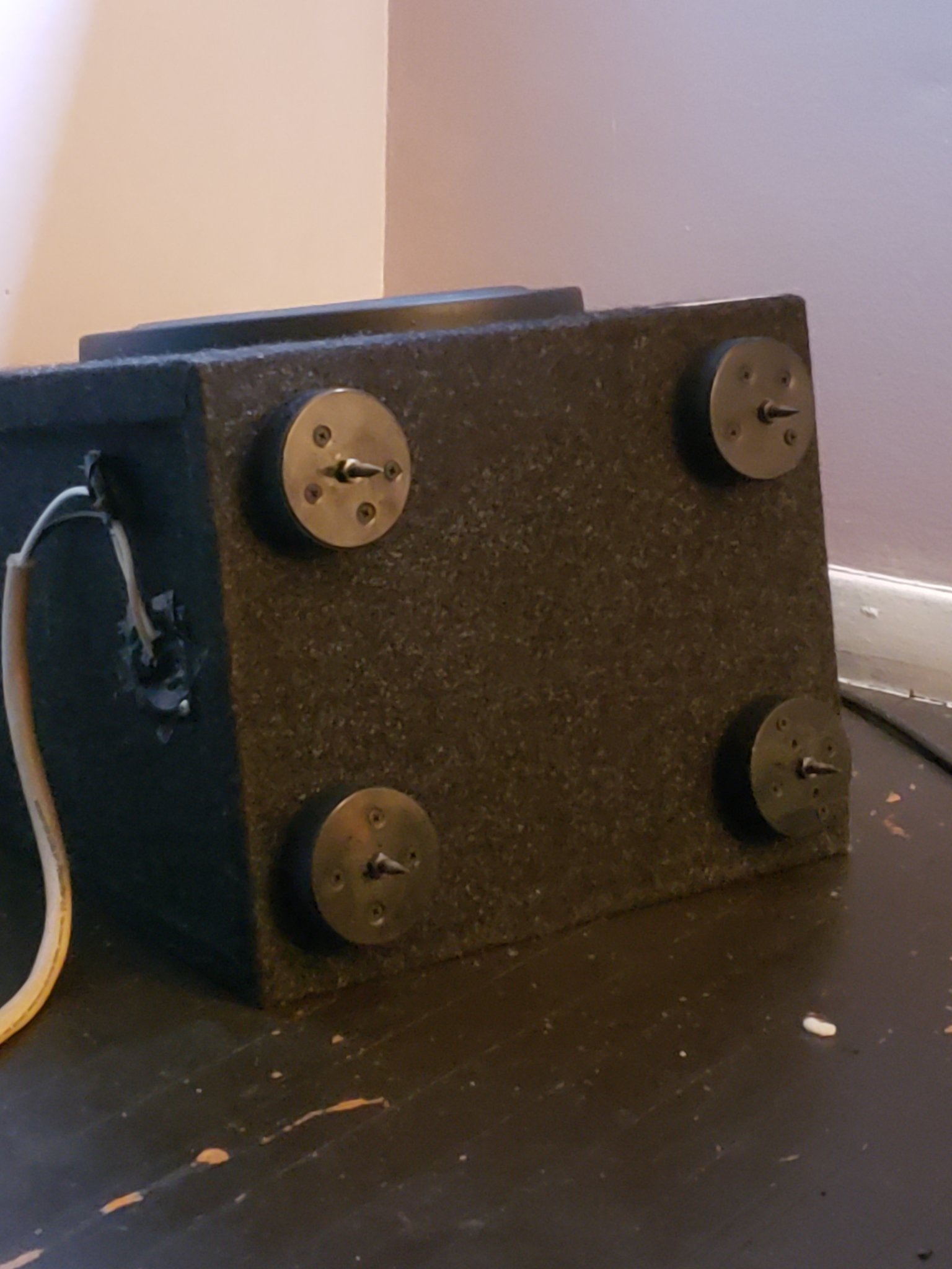

Those are the same pucks you pictured as something they else 😉
They actually do work pretty well.

Looks like good plywood to me. I've never bought plywood from the wood store, just the home store, but I've always been curious about it. I'm sure it will do a great job. Glad your using nice ply and not mdf.
I think I understood how the feet worked after you showed the screws, the first ones I didn't see holes though the puck so I was confused by that.

No good j, the puck carbides. They get ripped out after they take a good hold and sink in to the hard oak floor. From adjusting it too much works them loose. It is ok though, I have a better idea.

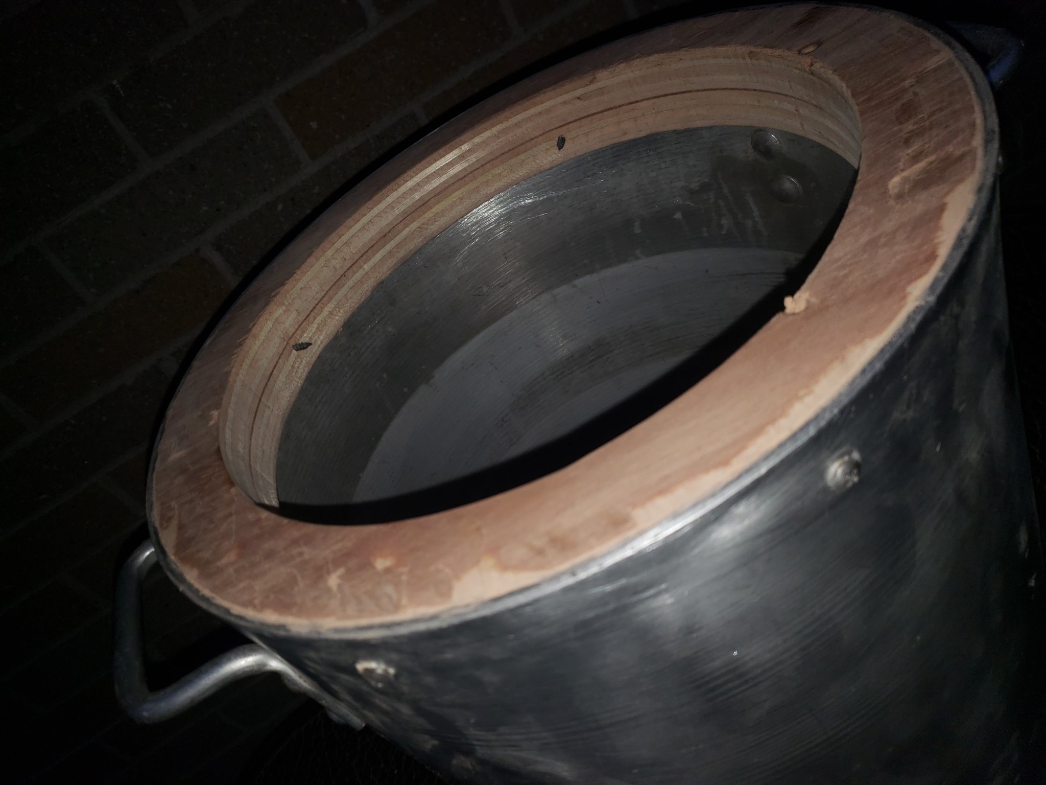

I averted back when I mentioned. But this is where I left off. I like how the lip turned out on the better half, the seam is nice and clean. My screw up with the pilot holes resulted in destroying the walnut veneer. Only a small strip will be showing with the driver mounted but I wanted it that way for a reason. The up right columns would of been the same colour/veneer and I wanted that detail as small as it is.

Its not very complicated to copy the main structure. The upright columns that hold everything up will consist of four laminated layers of plywood. Cut to size and shape with a roller guided router that follows a pre formed mdf template. IMO the upright columns will be easier to make than the bucket baffles were.
