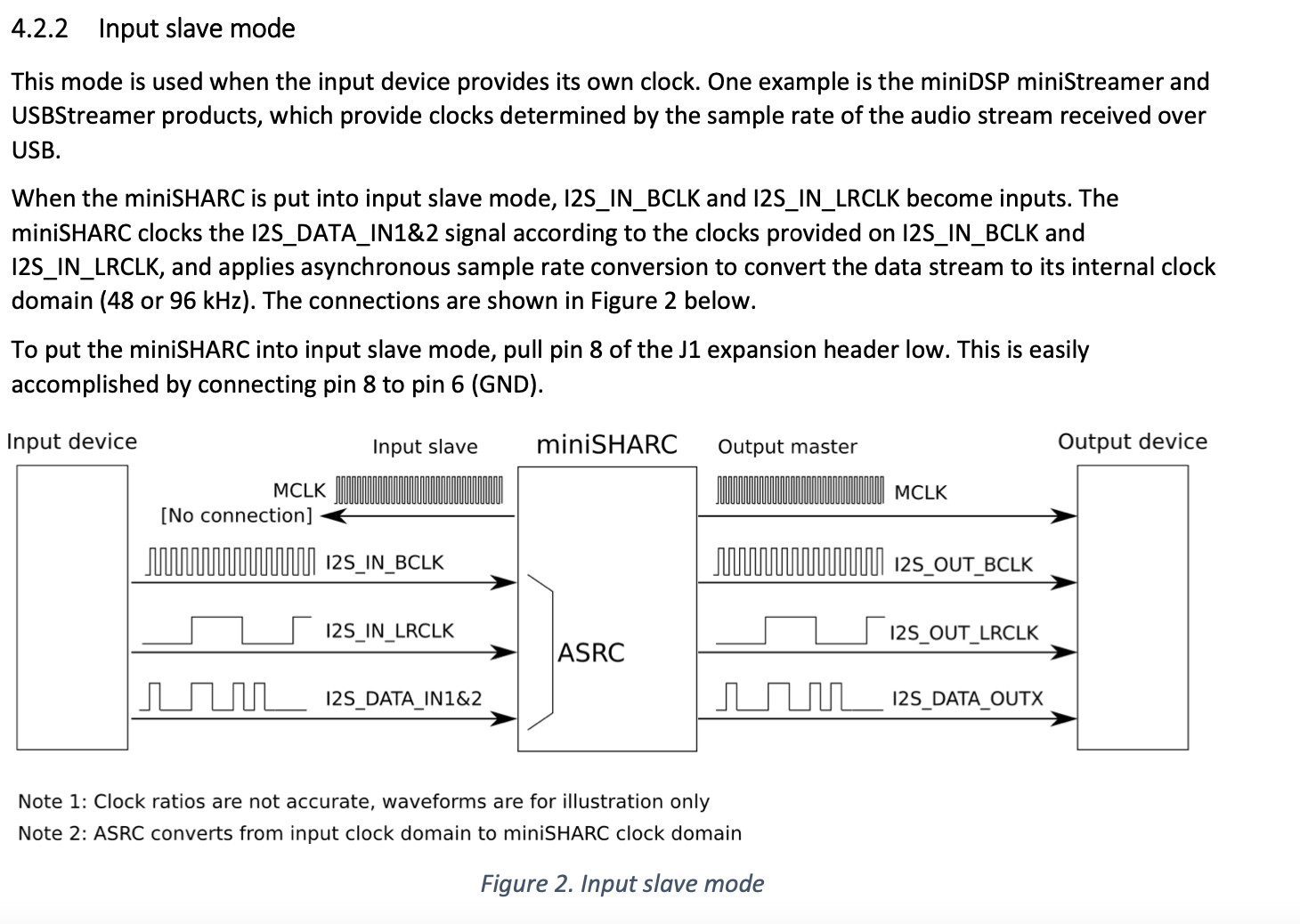

The AES/EBU or SPDIF receiver cannot do that. It gets the clock synchronous to the incoming audio data by recovering it from AES/EBU or SPDIF signal. The transmitter combines master clock and data into a single data stream and the receiver separates them. The sender and receiver need to be in the same clock domain. That being said' you can break that link with an ASRC which can bridge clock domains making the output domain independent of the input domain. As the DDRC-88D uses such a device on the input and out of the DSP chip I don't suppose a third set would make much difference.

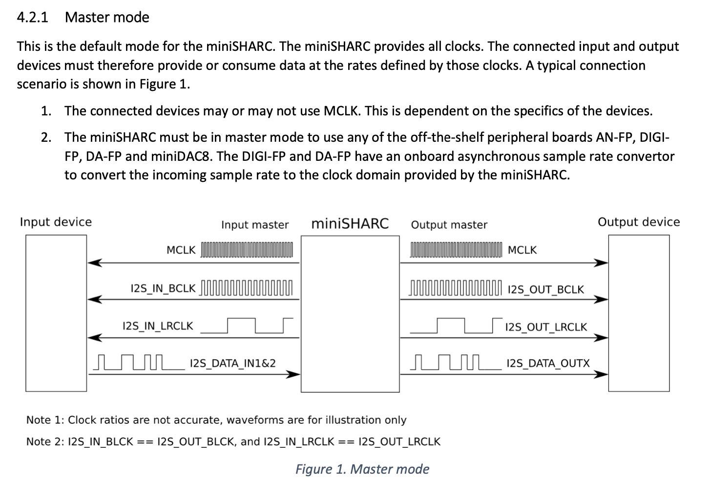

I have a good amount of experience with the miniSHARC and have personally used it in "Input Slave Mode" where the internal SHARC ASRC is used as well as "Master Mode" where clocks are provided by the miniSHARC to the DIGI-FP board which uses a SRC4382 for ASRC.
Again, the DDRC-88D is a bit of different beast with custom firmware but I've attached the relevant sections from the miniSHARC manual for reference.

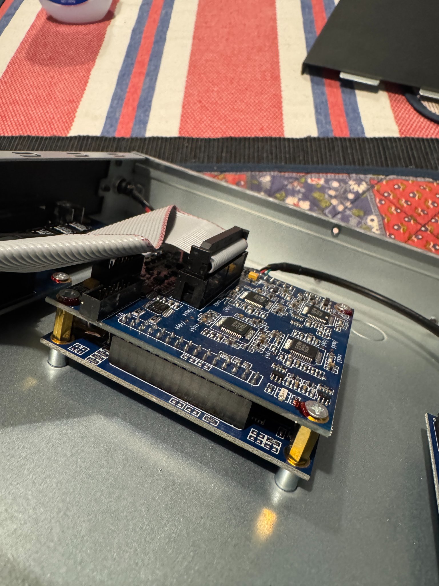

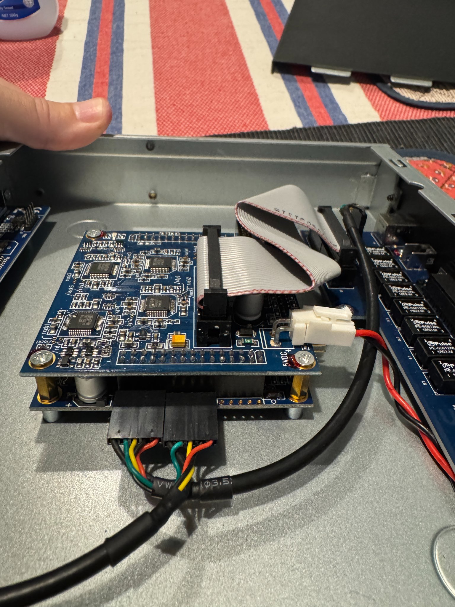

I popped the 88D open to have a look. The built quality is pretty good.
The miniSHARC board is beneath what I expect is the SDIF to I2S and vice versa board. (It has four SRC4382 chips on it).
I couldn't split the two boards - I took the (riser) screws out but the boards are solidly connected. I expect they are bonded together in some fashion.
The I2S jumper (J2) is the near one in the second photo.
For the preliminary scoping of accessing the I2S signals coming from the miniSHARC:
- can I leave the top board intact while I connect to the four sets of miniSHARC I2S outputs at the exposed pins in the top board?
or
- no, the miniSHARC's I2S outputs need to bypass the top board.
What is reasonable electronics pratice?
Ultimately, I'd go to I2S on all my 88D inputs and remove the top board altogether.

MiniSHARC I2S outputs are single-ended so they are not intended for long connections so you should probably switch to I2S LVDS between devices. For this you would need I2S LVDS transmitters on all I2S outputs and receivers on DAC I2S inputs.
So it easily gets quite complicated without any guarantees for improvement.

In my experience the biggest challenge when using the miniSHARC I2S output with multiple DACs is that it only has a single output for MCLK, BLCK and LRCLK. This is fine for a multichannel I2S input DAC but does not work well for multiple DACs as you need to split MCLK (if needed), BLCK and LRCLK.
I've had some success splitting BLCK and LRCK with short runs to two DACs, but I wouldn't recommend that approach. Using the McFIFO / McDualXO is a good solution for the miniSHARC as it acts as a fan out buffer for MCLK, BCLK and LRCLK, this makes interfacing multiple DACs with the miniSHARC very easy. However, the penalty is long, variable latency (from the FIFO) which is not good for audio / video applications.
