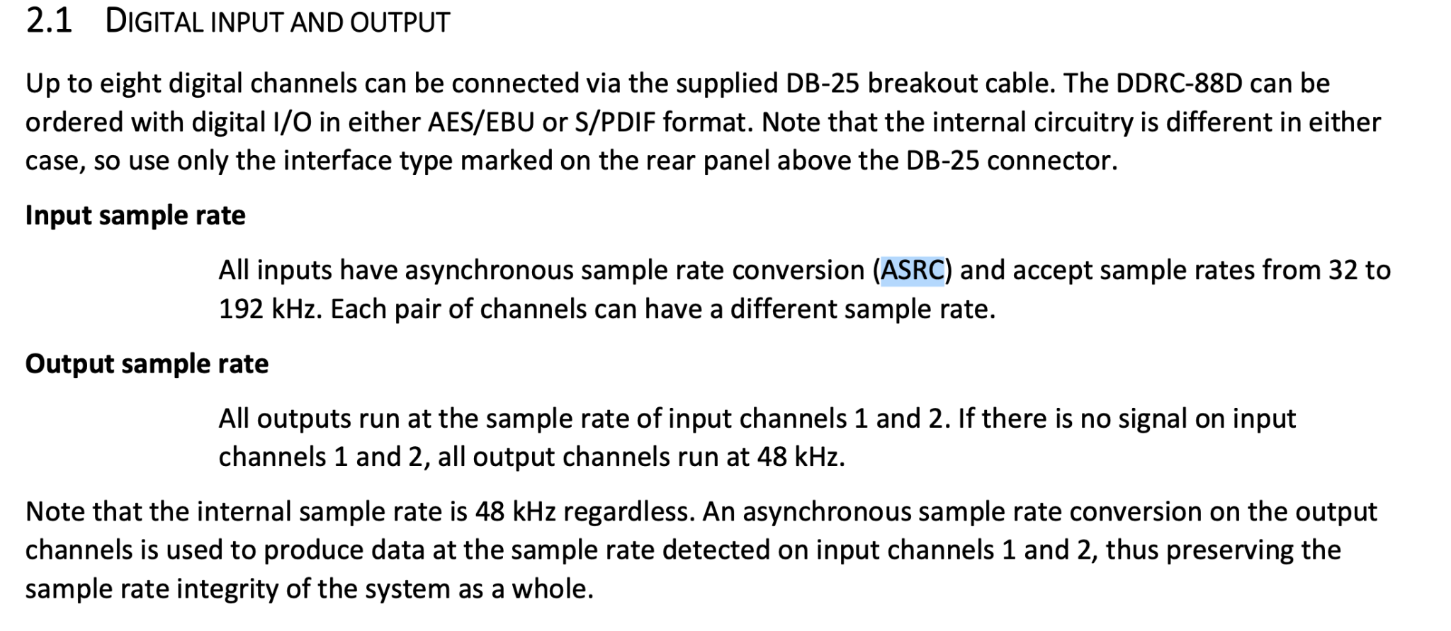

The AES/EBU or SPDIF receiver cannot do that. It gets the clock synchronous to the incoming audio data by recovering it from AES/EBU or SPDIF signal. The transmitter combines master clock and data into a single data stream and the receiver separates them. The sender and receiver need to be in the same clock domain. That being said' you can break that link with an ASRC which can bridge clock domains making the output domain independent of the input domain. As the DDRC-88D uses such a device on the input and out of the DSP chip I don't suppose a third set would make much difference.I mean accepting an MCLK input from an external clock and applying that clock to internal operations.
They are an integral part of the SHARC ADSP21369 DSP processor used.I imagine ASRC is handled by the SPDIF I/O board
Are you sure? Have you taken one apart to verify?
Others claim that it least has 4x TI SRC4382 -> https://www.minidsp.com/community/threads/dirac-ddrc-88d-aes-clocking-questions.19550/. This would be consistent with how miniDSP implements ASRC when using the DIGI-FP on products like the OpenDRC-DI.
I have a good amount of experience with the miniSHARC and have personally used it in "Input Slave Mode" where the internal SHARC ASRC is used as well as "Master Mode" where clocks are provided by the miniSHARC to the DIGI-FP board which uses a SRC4382 for ASRC.
Again, the DDRC-88D is a bit of different beast with custom firmware but I've attached the relevant sections from the miniSHARC manual for reference.
