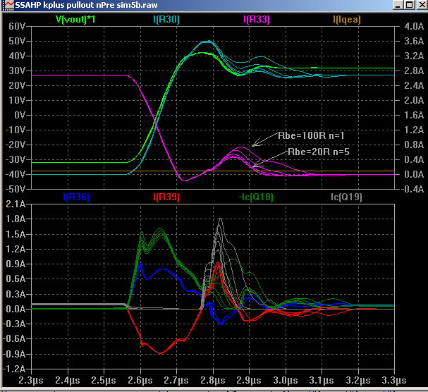

Agreed. Here's perhaps a better way to speed-up the CFP driver's turn-off. Reduce the value of the driver's base-emitter resistors.
With 25 ohms they turn off as fast as my previous base-base capacitor method. And there is no rail coupling issues with lower base-emitter resistors. But the pre-driver now dissipates 4 times the power. So I propose 4 existing pre-driver transistors in parallel with a 10R emitter sharing resistor for each pre-driver. Each driver dissipates the same power as the original circuit (~300mW).
A simulation (attached) shows 4 in parallel gives the best improvement for the number of extra parts. The plot below steps 1,2,3,4,5 pre-drivers, and Rbe is stepped 100R,50R,33R,25R,20R respectively.

Yes, the main danger is overheating, usually the power transistors, but also drivers. High cross-conduction currents can reduce the FT and slow them more causing a sort of thermal runaway.
Yes, according to these sims, cross-conduction is only going to occur when you do an extreme bench test like 100kHz full-swing with 4 ohms. Maybe leave 2 ohms to simulations.
Cross-conduction is still worth minimizing even if you amp never gets tested at 100kHz because there will be reduced amount of cross-conduction at 20kHz which can potentially increase distortion at 20kHz (depending on what other mechanisms are creating distortion at 20kHz).
Re identifying cross conduction:
Using Plot in Post 643 http://www.diyaudio.com/forums/attachments/solid-state/685242d1528275513-top-solid-cfa-amp-design-ssahp-kplus-pullout-npre-sim5b-1-5-pre-drivers-png (copied below)
Power transistors are the top plot I(R30) & I(R33). Up to 2.5us the output voltage is negative and R33 (lower power transistor) has the current and is to be turned off next. R30 ramps up while R33 ramps down but goes negative (-0.2A) due to base pull-out current. (Notice R36 and R39 have 0.6A (at 2.7us) which is split into the 3 power transistors base current). So far no undesirable cross-conduction.
Between 2.8us and 2.9us R33 current for the power transistor should go to zero (since only the upper transistor should conduct for 30V output) but there is some ringing caused by the delayed feedback signal via the input stage. R30 shows the lower power transistor is starting to turn on again causing unwanted power transistor cross-conduction (peaking at 0.8A with about 70V across the lower power transistor) ... and the driver stage is a bit slow at changing it's state and the upper driver (NB Q18 in my circuit) stays on while the lower driver (Q19 in my circuit) tries to control the power transistors and this means Q19 has to supply gobs more current, up to 1.8A peak with 70V across it ... quite an ask for a driver transistor even if it is only for 100ns.
Notice the effect of changing the driver transistors base-emitter resistor speeding up the turn off of Q18. EG at 2.85us Q18 has 1A peak cross-conduction with 100 ohm base resistor and no cross-conduction with 25 ohms, and the effect of this is seen in the power transistor cross-conduction reducing from about 0.8A peak to 0.4A peak which is helpful.

If you have a driver that is as fast as the pre-driver then use it. It seems that drivers are usually slower than pre-drivers (is it due to die size?).
If I'm not wrong, lowering driver's BE resistor even more provokes higher distortion, despite of multiplying predriver transistors.
If faster transistor means higher FT capable, I never saw such power transistor more faster than currently used.
Predriver and driver transistors are equal in speed in that regard, only cob differs due to die size.
