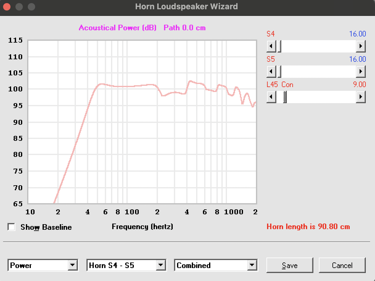

Plus, it models very nicely in a TABAQ MLTL enclosure.

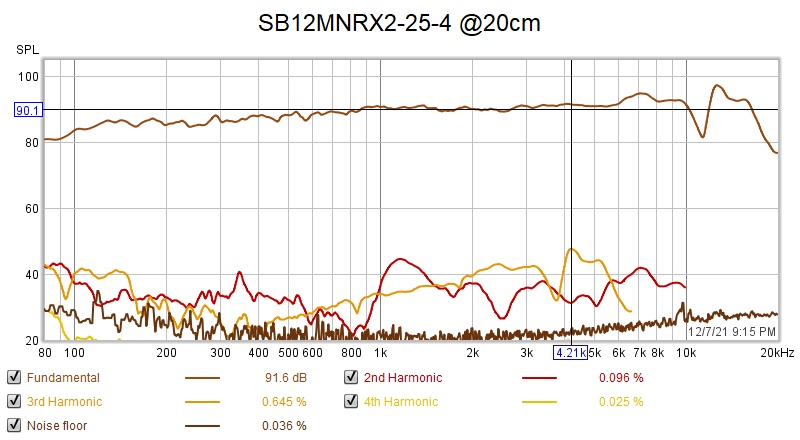

Measurement
Bare in mind this test box is 13" deep with a foam cushion stuffed in it, about 5.5" wide by 9 inches tall, and the front and back tacked on with an air gun...not exactly sealed. I don't usually measure anything in these boxes, just make different baffles to burn in drivers playing in the shop while I'm working.
Mic is 20cm from the driver to get a decent measurement considering it's not in a great spot and it is not countersunk either.
Considering all this, the worst of it would be a 3rd harmonic peak at 4200hz. That peak however is around 43db down...0.6%. 2nd harmonic hits about 0.5% at the break up point. Pretty damn clean and smooth.
Glad I trusted my ear and bought more, with a proper design these will shine. They sound laughably good right now considering what they're in.

Had to wait for the website redesign to see it.
The redesign is a bit harsh but as with everything, we'll get use to it.
Thank you for sharing the distortion numbers.
I will be ordering a pair next month and have a little fun. For me, the first thing will be to try them in a MLTL. That's my go-to design. Just love them.

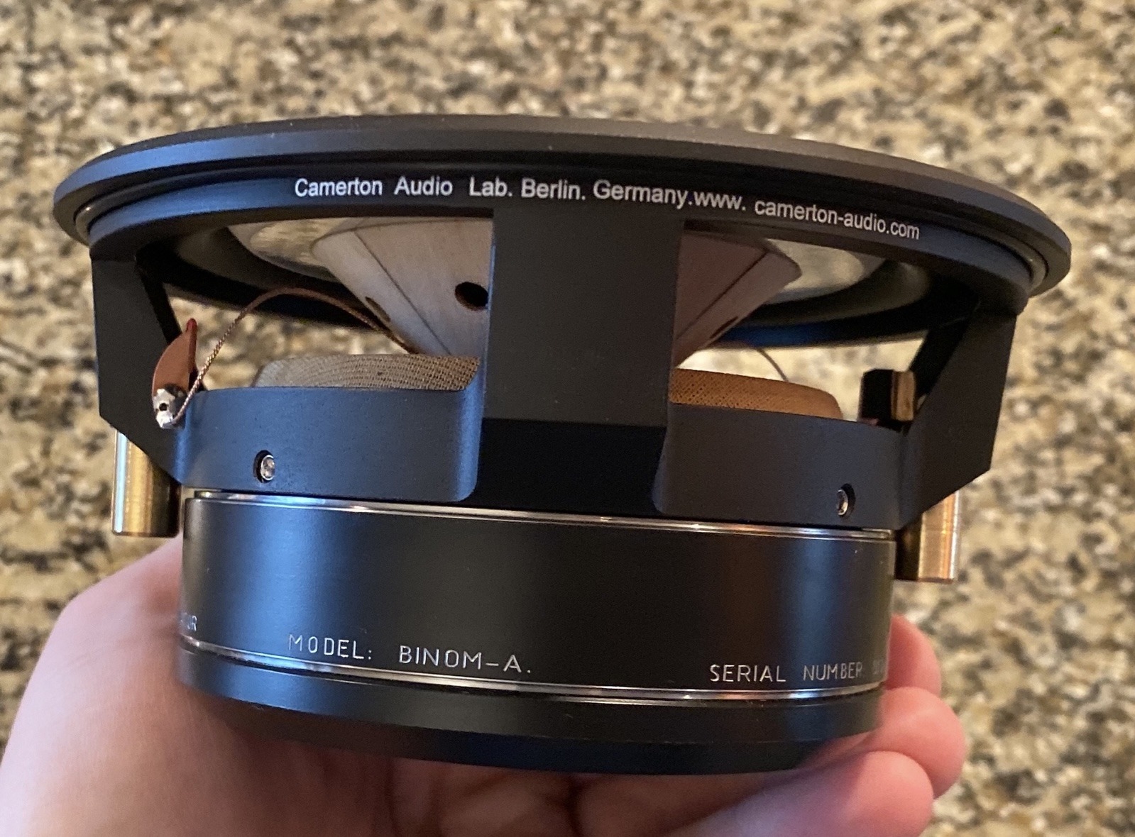

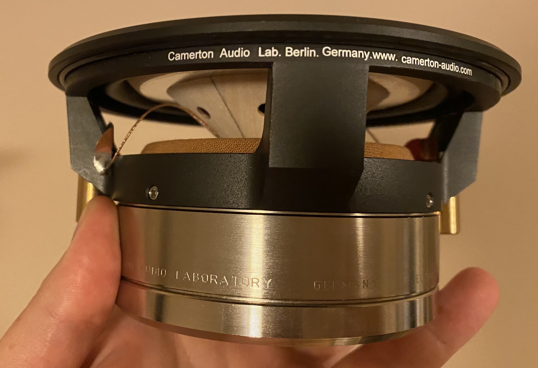

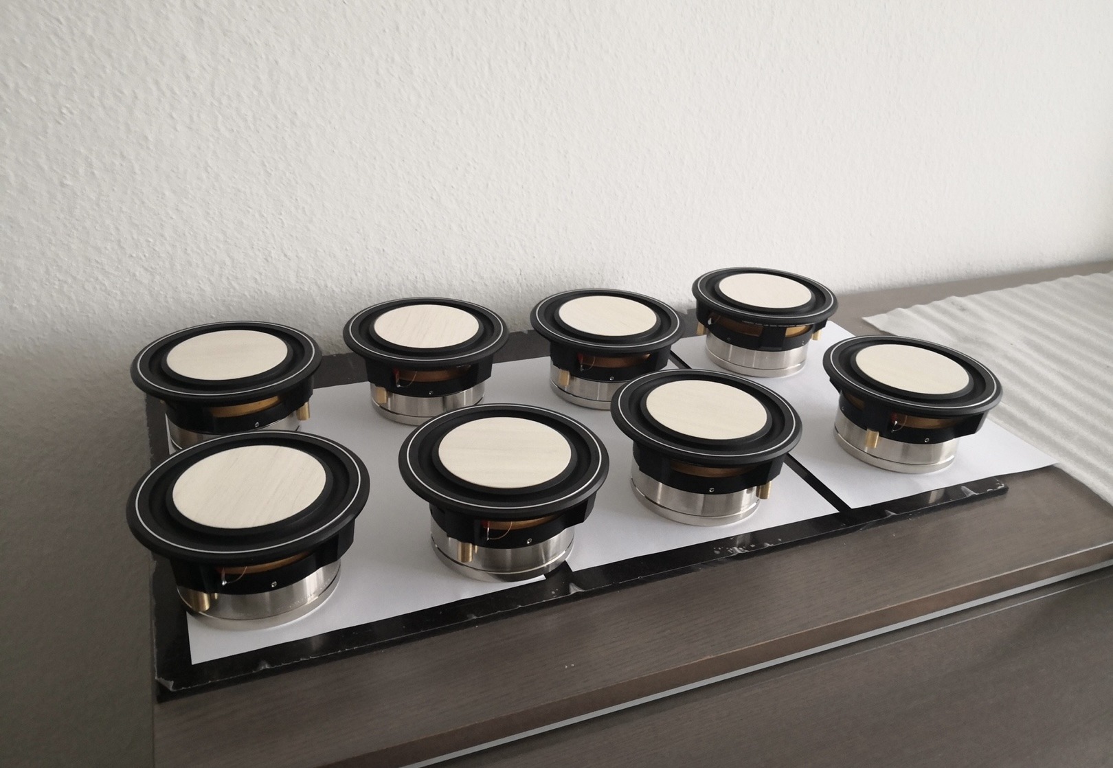

hmmm.. I'm guessing it's sarcastic?
at over 7,000 euros a pair, that'd be $42,000 for a dozen.... it is out of the reach of most DIYers!
The pair mentioned in this thread are about $120 !
Normally I'd be weary of the marketing pitch of a 5" driver covering 35Hz to 28kHz... even though 6moons seems to like it, I still have my doubts.
I guess I will never know, as I am not going to order a pair anytime soon! 🙂

Ah, Ye Olde Balsa strikes again... See the Dr. Carl Pinfold driver described in Wireless World around 1980.
Still curious to learn what a more modern Balsa coned driver does this time.
Could you present SPL measurements (ARTA/REW/CLIO or whatever) on a 5dB/Div scale of that Camerton Driver on 1 meter on axis?
