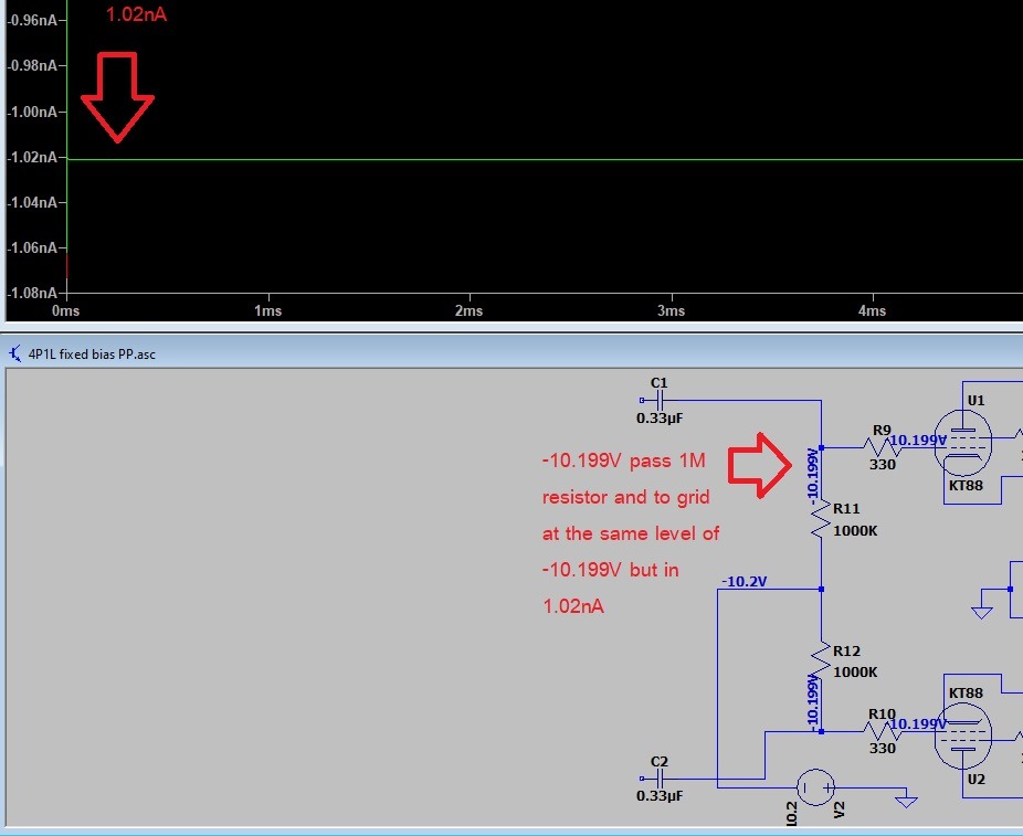

1 tube of 4p1l fixed bias is -10.5v 4ma then 2 tubes fixed bias is -21v 8mA right? If screen grid resistor 1M feeding -21v the current will be too low? 0.02mA not 8mA?
"1 tube of 4p1l fixed bias is -10.5v 4ma then 2 tubes fixed bias is -21v 8mA right?"
No.
Each /paralleled/ tube fixed bias is -10.5V.
There are -practically- no DC current (uV region) trough 1M (FET gate) bias voltage resistor.
No.
if feeding -10.5V through 1M bias resistor, only some uV will pass through the bias resistor and current will be very low at 0.01mA.
Then, what 4mA screen grid in Tube data sheet related to? Thank you.
No.
https://www.bartola.co.uk/valves/2016/03/10/russian-pse-in-steroids-01a-into-4p1l-part-iv/
from website of Mr. Bartola https://www.bartola.co.uk/valves/2016/03/10/russian-pse-in-steroids-01a-into-4p1l-part-iv/
the screen voltage is -24VDC (not uV). However there is no 1M bias resistor and 330R grid resistor.
That is the point I do not understand why if feed -10.2V to 1M bias resistor there is no DC (uV only) but another -24VDC has no 1M bias resistor and feed -24VDC instead of uV.
If are you read carefully, these numbers are valid at penthode mode, at specific Ua, Ug, Us values.
The linked (made by Ale) schematic contains triode connected pentode tubes, with other subject to conditions.
Triode connected pentode tube's -summed- anode current contains both currents (Ia, Ig2), so at development -in itself- does not need to be considered Ig2.
No.
I borrow KT88 PP fixed bias in this forum and try to test -10.2V pass through 1M bias resistor.
the result is voltage is little drop from -10.2V to -10.199V and current is about 1.02nA. Is it correct, Mr. Euro21? Thank you very much in advanced.

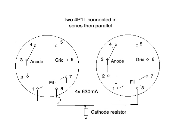

I haven't used the 4P1L for several years but I'm revisiting it. Not filament bias this time, just ordinary cathode bias.
I'm just checking that this pinout for 2x 4P1L in triode is optimum, so comments welcome. The two 4P1L are connected internally in series, and then in parallel so total filament is 4.2V at 650mA. Anode, grid2 and grid3 connected together, no added resistors. 250V on the anode and 35mA each tube.
Is this how you would do it?
I prefer to parallel wire the 4P1L, to reduce the skewing of the bias along the length of the filament -> sounds better.
Filament current is now 1.3A total, so if you are heating them with my regulators, you can compare the parallel pair to a 300B without changes to any parts.
