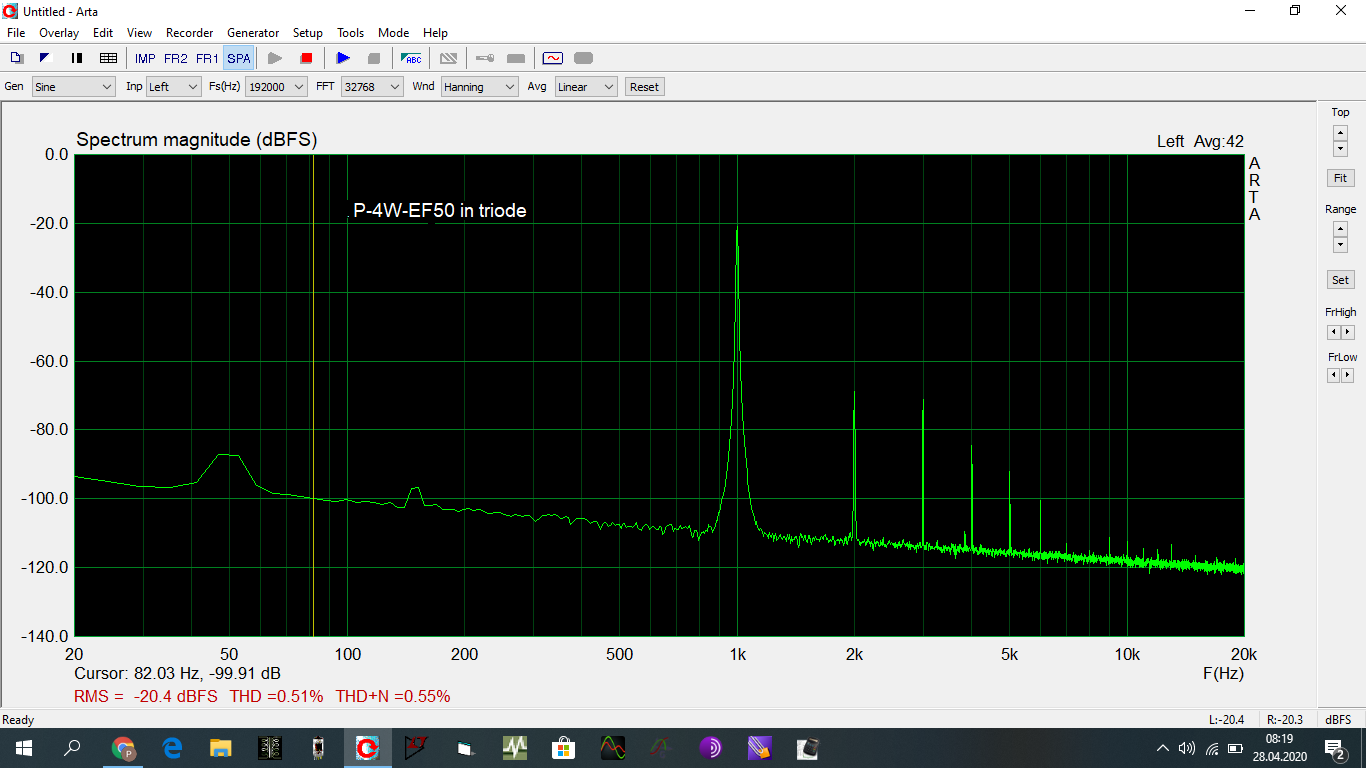

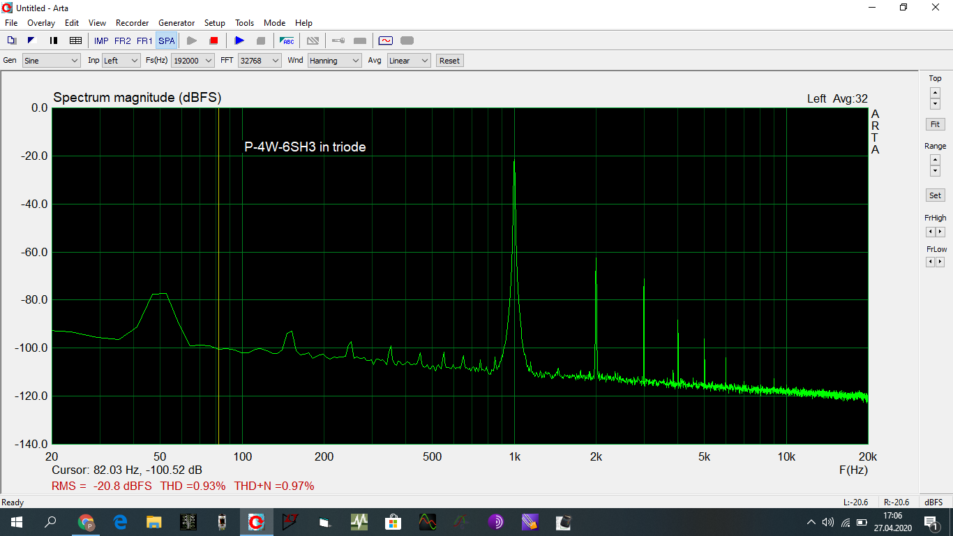

Hello.
Only in the middle of the week I will carry out "blind tests" of the amplifier because apart from tube 3A5 I still have EF50 in triode and 6SH3 in triode. I will write the results.
Piotr
Piotr

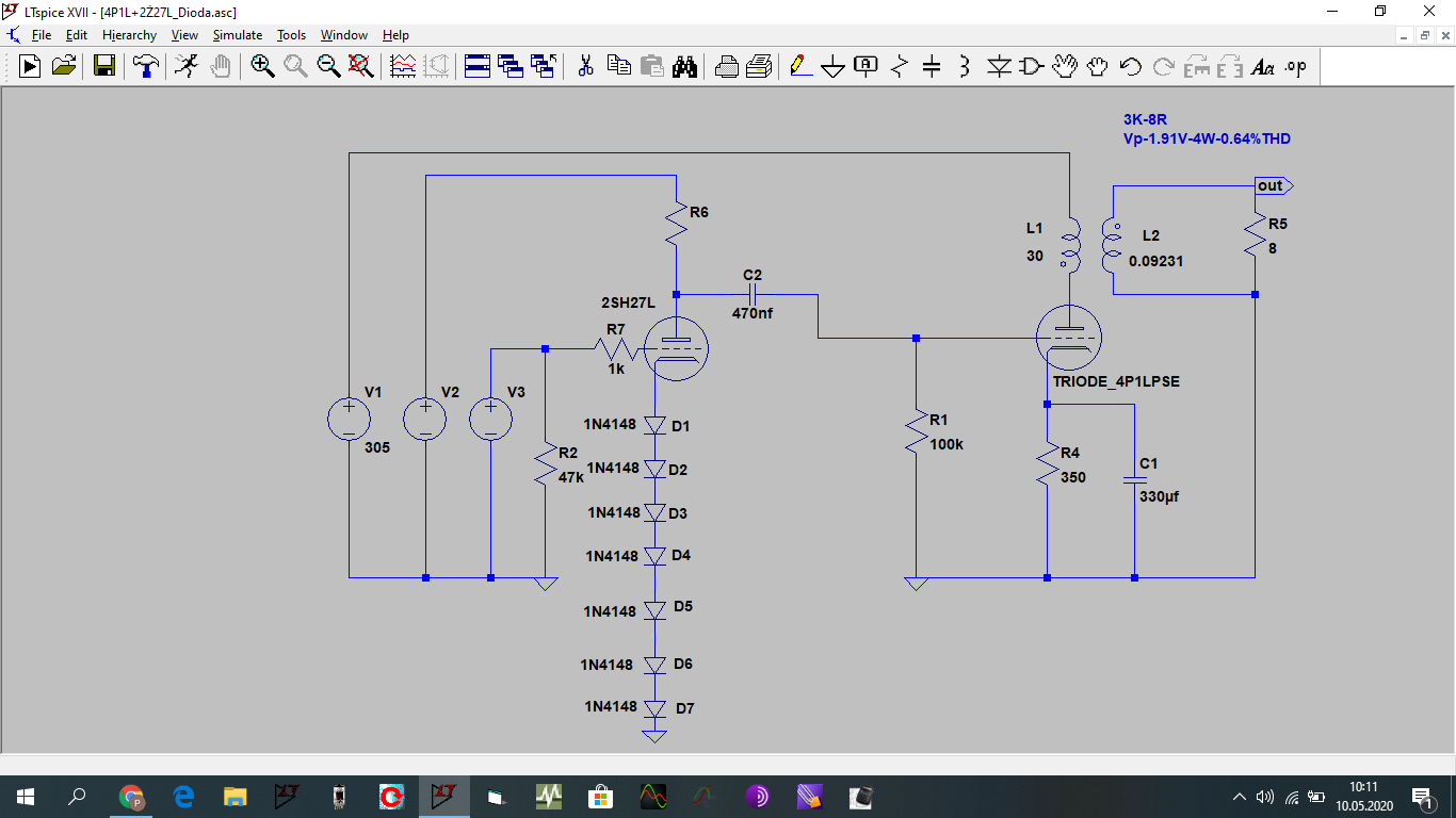

Hello,
PSE4P1L+2SH27L (2Ж27Л) in triode.
Piotr
Piotr

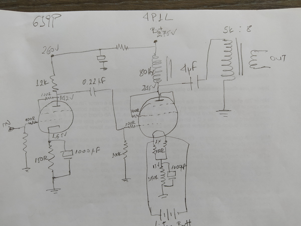

Going back to the 4P1L, I built a driver stage using the Hammond 157G as a plate choke with FT-2 output cap. It sounds pretty nice to me. The 157G is used in the Hagerman Tuba headphone amp using an EL84, for instance. It's 30H and 40mA.
This raises the possibility of using one or two 157G in parafeed for a SE or PSE output stage. I can't remember if we've discussed parafeed on this thread. There are other plate choke choices, for instance these:

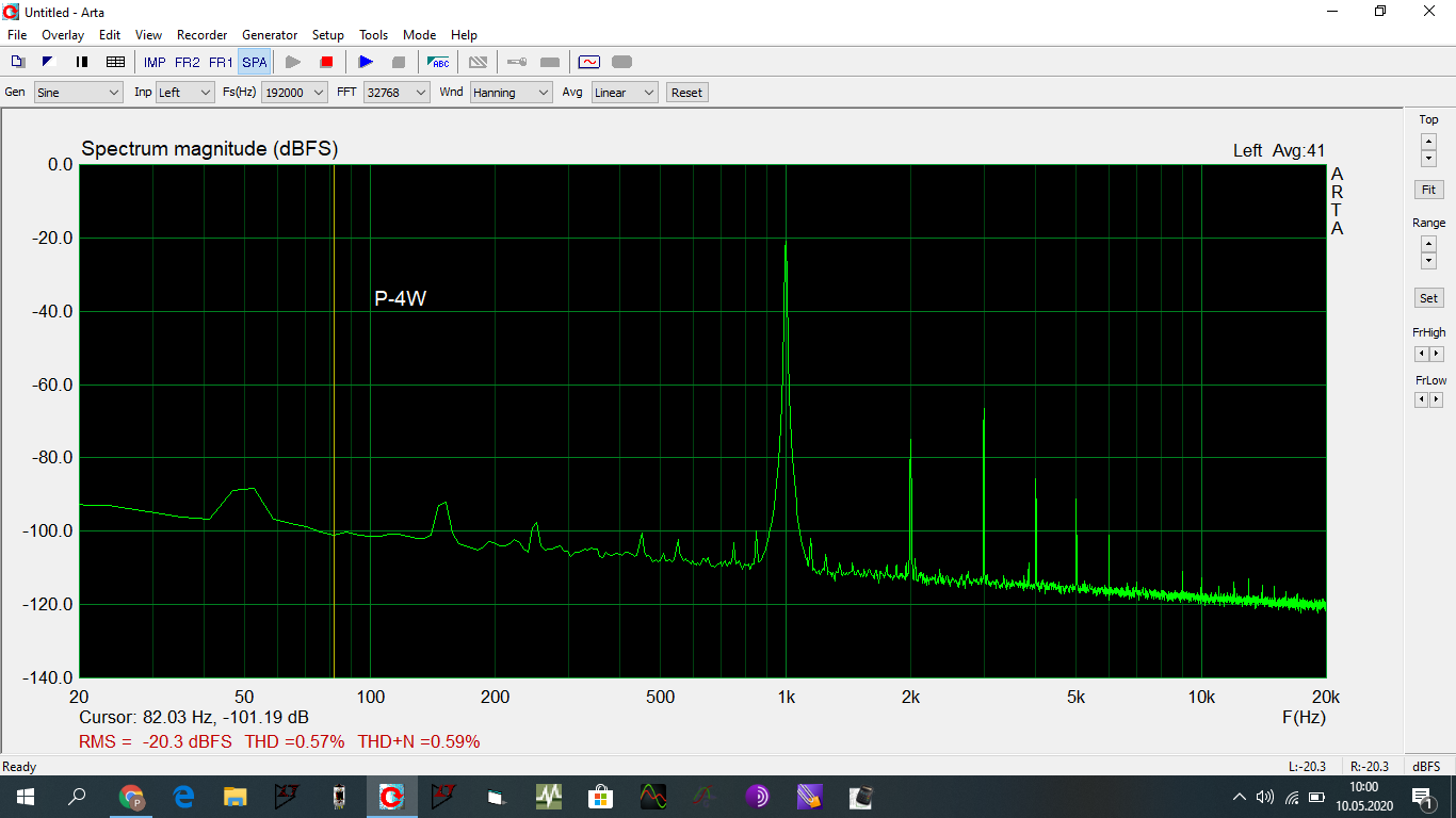

Well, after having read so many good words about this little tube, I decided to give it a try. I had bought a dozen of them some years ago and they were patiently waiting to be fired up. To be honest, my expectations were not that great, but, lately, I’m in the process of trying different output tubes, in an attempt to use a couple of parafeed output transformers that I had wound a couple of years ago, since the initial project was abandoned. Namely, it is an anode choke with an inductance of ca. 80 Hy at 60 mA and a parafeed output transformer with a primary reactance of 5K and a power rating of 5 Watts.
So, one afternoon, a couple of weeks ago, I sat on my bench and quickly assembled one channel on a wooden board with whatever I found easily on my hands. As a driver, I used a triode connected 6J9P run at a current of 10-11 mA. Filament supply for the 4P1L was taken from a Li-ion battery, charged at 4.0 Volts and biasing it with a capacitor bypassed cathode resistor. HV supply was from my lab power supply. Working parameters were the usual referred here, i.e., 240 V and 40 mA (see attached file for a rough schematic). All components were random items I had, nothing fancy, no «boutique» items. After checking everything on the bench, it was time to connect it to my system. The output power was measured ca. 1 W at the point where the tube was entering in class A2 mode.
Here, I must mention that I have a pair of quite sensitive loudspeakers, namely Tube Audio’s Marvel 2-way horns, with a sensitivity of 97 dBs, so I have the luxury to play with minuscule power amplifiers, one of the great advantages of having a sensitive speaker, which always pays of.
I connected the amplifier to my system and fired it up. From the first notes already, I realized that something great was happening here. Although listening to only one channel, I can always understand the character of the piece of equipment I’m listening to. Also, I must note that, whenever I conduct a listening test, I always make comparisons to a well known amplifier (which I use a reference point). For some years now, my reference amplifier is a 300B SE. Well, I must say that, although far from ideally constructed, the little 4P1L sounded clearly better than my 300B. In particular, bass, although not deeper, was more accurately controlled, mids and highs a bit cleaner. Particularly, I was impressed by the way it rendered voices, which I consider a key factor when judging an amplifier. All these findings were confirmed by a friend of mine, whom I invited to give me his view, since I greatly trust his acoustic opinion.
Having already been happy from what I was hearing, I started trying different drivers, in a conquest for a possibly better outcome. At first, I thought of making an all direct heated amplifier, so I tried an RE084, firstly with an anode choke load. Although my choke has an inductance of 200 Hy, I noticed a quick fall above 12 kHz, since Ra of this little tube is quite high at 8 kΩ. So, I changed this to a CCS (Garry Pimm’s self bias CCS), set at 4 mA. Now, the frequency response was better (it began dropping after 24 kHz), but I felt it was a little «anemic», since, with its low current, could not drive the 4P1L adequately. Nevertheless, I really liked its sound, especially nuances were there (BTW, I consider building a preamplifier with this tube).
Next, I thought of using a 4P1L to drive a 4P1L, as many of the members here have done. I loaded it with a choke, with a current of 20 mA and an anode-cathode voltage of 135 volts. To be honest, I didn’t like it so much, it was clearly inferior than the triode-strapped 6J9P. As I have read earlier in this thread, Andy Evans also had this opinion about this configuration. Also, since the gain was rather low for my set-up, I didn’t bother further trying different configurations (e.g., a CCS load).
So far, those are my experiences with the 4P1L. I have a couple of other things to try for a driver, like a triode-strapped 6E5P, a 5842 and, maybe, a 6C45P. I will definitely apply a filament bias scheme, using Rod Coleman's regulators.
The journey has just begun and I’m sure it will be long. But I’m also sure that I love this amplifier so much and that it will be my favorite piece, when I will eventually finish it.
