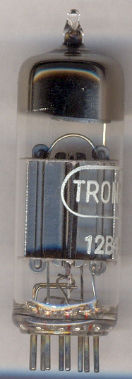

you can have a look at a Tronal 12B4A.How does it look like? 🙂

Can't make much of it really.
Normally, actually almost always, US made tubes have an acid etched marking on the tube stating the type of tube.
From the way this is done you can often tell with good certainty who the manufacturer was.
In the case of the Tronal tubes you show here, I can't see any dead giveaway as to their origine other than that they look European made by the way the plate is fixed to the mica holders.
This is surprising as I don't know if this tube was ever made in Europe.
Maybe, just maybe, this could be made by Ei in former Yugoslavia.
They're about the only European based manufacturer to have made some typically American tubes such as the 12BH7A, 6FQ7 for example.
Sorry to be of such little help here, 😉

Ei and 12B4
Frank,
afaik Ei was never making 12B4.My opinion is based only on catalogues and lists of tubes from the factory I have collected ten years back.Majority of TV tubes they produced had european markings(PCC,PCF,PCL...). But,sincerely I can not be 100% sure!
On the other hand you are completely right about 12BH7A and 6CG7!And I think they are still in production.

Quite probably so....
Guess we will just have to see if Resident can find some acid etched clues on the glass.
BTW, the resemblance with the 6AS7G is quite striking...
I can't help but adore the way the wings (radiators for heat convection) are placed at both sides of the heater making for a lovely glow when the tube is in service....
A mini, single 6AS7G, triode with a useful mu and reasonable Ri.
One could make a miniature Liliput amp with those quite easily....Yummie. 🙂
Cheers, 😉

I'm checking right now the tube that I had scanned (pic above) but I can't see nothing.Guess we will just have to see if Resident can find some acid etched clues on the glass.
I'll check the other three that I own when I'll go back to my small lab. 🙂
Sorry but I can’t find anything!Guess we will just have to see if Resident can find some acid etched clues on the glass.
