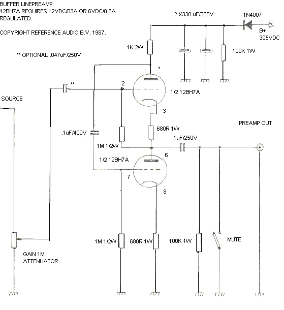

I think that fdegrove has posted a design; I can't remember if it used a 6SN7 or the premium 5692 equivalent. Do a search with "fdegrove" as author and either 6SN7 or 5692 as the search term.
Ah, phooey, I thought he used a 6SN7! Sorry for the wild goose chase. But it's a really good circuit and one you ought to consider.

Errrr....Yes he did...
Only that's another circuit I posted...somewhere.
If it's the SRPP using 6SN7s then it suffer from low PSRR just like the WCF Resident (re)posted here.
The SRPP has a gain of roughly mu/2 and like to see a low fixed impedance to work with.
The WCF suffers a mild insertion loss (gain = 0.97) but can drive just about any real life load.
The two combined can work very well together and with some small tricks would make for what John Broskie calls an "Aikido" stage.

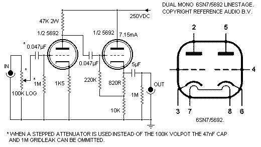

Then there's the tried and tested 6SN7 schem using a grounded cathode for gain coupled to a CF for low Zout, a recipe almost as old as tubes themselves I believe....
Is this the one you had in mind, SY?

Hi Frank,
I'm reading your ultimate preamp,right now!
Damn 30 pages are a lot of pages for a thread.
I thing 6SN7 schem using a grounded cathode coupled to a CF is the simplest and easiest design I can build,right?

He, he...You have Jam to blame for that....
Anyway, no need to read all those pages.
Most of it is about a phonopreamp, what's left deals with the WCF as a buffer linestage.
Most of it stems from prejudice, the remainder founded on the fact that there are some "classic" designs out there with really lousy linestages using half-*ssed CFs...
Add the fact that a CF is about 100% local feedback and just about everyone has read "somewhere" that feedback is Dr.Evil in person and you get the picture.
IMHO, if you don't need a CF then don't use it....But that goes for just about anything really.
You can't go wrong by keeping things as simple as need be.
So, to answer your question more ad rem:
If you want something that could be up with the best and don't need to drive your neighbour's silly snob-amp then my vote would go for Brett's 12B4A preamp assuming you want some gain and have (or are going to) an amp with a Zin ranging from 50 to 100K.
No 500pF/m interconnects spanning 10m runs either.
12B4As are plentyful and cheap so if you need to put 8 aside out of a dozen because of microphony (I still have to find the first microphonic 12B4 from my NOS stash) then you'll probably still cheaper of then having to buy NOS 5692s anyway....
If you want the low Zout and some gain then the 6SN7 comes to mind.
Everyone who's ever built it was pleasantly surprised but if you're on a budget I'd advise to build in the possibility to use the 12V heater version as well.
That should at least cover the octal varieties nicely.
Another option is to use the loctal based 7N7 but I have no experience with those.
Plenty of tubes to pick from if you stick with what's electrically equivalent, from noval through loctal. No sweat.
If no gain is required and you want to concentrate the budget around a high quality volumecontrol and still want to be able to drive difficult loads then the WCF buffered volctrl may be your thing.

fdegrove said:Then there's the tried and tested 6SN7 schem using a grounded cathode for gain coupled to a CF for low Zout, a recipe almost as old as tubes themselves I believe....
Frank, how would you sdjust that to eliminate the coupling cap?
dave
To my mind the easiest and most elegant way to go about it is to use what I nickname the "see-saw" circuit.
It offers the advantage of AC current balance, something worth keeping in mind if you want to find out why some CFs don't sound too good when sitting on a common rail supply.
Cheers, 😉
Cheers, 😉
