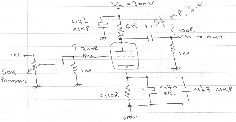

I build it like Brett suggested to GAK. It’s like the attached schem.
The only thing I changed is that I'm using 7 parallel 39K carbon 2W resistors as anode load.So anode load is around 5K6.
Values of grid stoppers and grid leak resistors are of my choice.
So if you’d like to do any comments to develop this schem I’d be very glad.
I don’t like to do major changes like feeding a CCS anode load or put chokes in the PSU or e.t.c.
I’d like to leave it as it is. I already have built the preamp in a very nice chassis so I can’t do major changes.
I’d like comments like different bias points or different values of components that will affect my preamp’s sonic quality or e.t.c. In a few words, I’d like to do changes that it’ll not cost me too much and it’ll not be needed to change the chassis dimensions.
And now some questions.
-Frank said in Bryan’s thread that if you’d like to feed the 12B4 with 6,3V filament voltage just connect pins 3&4 or 3&5 and solder the wires at pins 3&5 or 3&4. Is this correct? I have connected pins 4&5 and solder the wires at 3&4.
With this connection what exactly I have done? Sorry for this newbie question but I’m a little bit confused.
-I have connected the signal path at pin 2 of 12B4A. Is it better to use two grid stoppers at pins 2 and 7 and connect the signal path at the two ends of these resistors?
-Are the grid stoppers necessary in this project?
-I also mention that these tubes are microphonic. What can I do for this?

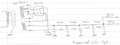

-I have a hum problem, too. It’s not very loud but audible. I’m thinking to solve this problem by connecting a cap or/and resistor from star earth to chassis. But, what are the best values for this purpose? Can I use the same values for my amp? Right now I have put a 100n cap at my amp at the same point and it’s dead quiet. Is this a safe value? I read somewhere that it’s better to use a resistor and NOT a cap. Why?

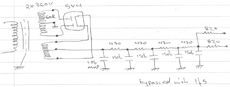

Hum problem
resident:
Here is a post extracted from another forum:
"For rectifiers with cathodes, take the DC from the cathode, rather than from the filament Ct. If the dc is taken from the filament ct with a cathode type rectifier, a 60 Hz component from the filament supply will be added to the dc output, plus some dc will pass through the filament. This may not be a significant amount, but why add in any 60 Hz, as it is more difficult to filter than is 120 Hz."
This may help,
John

Thanks for this!
In another forum I read that it's better to take DC from CT but I didn't thing about that there's danger to add 50Hz(over here) or 60Hz on it.
If I can't
hum with another way I'll try it.

That'll be fineresident said:I build it like Brett suggested to GAK. It’s like the attached schem.
The op points don't make a lot of difference once the 12B4 has some current running through it. I'd reduce the cathode bypass cap a bit in value though to 100u.I’d like to leave it as it is. I already have built the preamp in a very nice chassis so I can’t do major changes.
The filament is centre tapped, so by connecting it this way it allows you to use a 6V3 heater-Frank said in Bryan’s thread that if you’d like to feed the 12B4 with 6,3V filament voltage just connect pins 3&4 or 3&5 and solder the wires at pins 3&5 or 3&4. Is this correct? I have connected pins 4&5 and solder the wires at 3&4.
If it makes you feel better, do it. I've don't think I've bothered with stoppers on the 12B4.-I have connected the signal path at pin 2 of 12B4A. Is it better to use two grid stoppers at pins 2 and 7 and connect the signal path at the two ends of these resistors?
I build my chassis to start with assuming the tubes are microphonic and have come compliance between the chassis and the sockets.-I also mention that these tubes are microphonic. What can I do for this?
12B4s have two problems- quite variable distortion performance and quite variable low frequency noise. Selecting tubes is the single biggest improvement you can make.
What's the cathode voltage in your circuit? I'm wondering about alternatives to the RC circuit there (I hate big caps in audio circuits...).

@Brett
Do you bypass this cap with MKP? Or are you only using a good quality electrolytic?
What do you say about the 1M resistors? Are those values ok?
@SY
Cathode voltage is around 12V. What do you say? Brett already suggested me to change the cap to 100uF.

I’ll try it. Thanks for this tip.I'd reduce the cathode bypass cap a bit in value though to 100u.
My way or Frank’s way? Frank has confused me. I thing connecting pins 4&5 and solder the filament wires at 3&4or5 is the right way.The filament is centre tapped, so by connecting it this way it allows you to use a 6V3 heater
So, no stoppers. I don’t like stoppers,too. Remove 100 ohm too?If it makes you feel better, do it. I've don't think I've bothered with stoppers on the 12B4.

Real quick reply re the cathode cap. If you remove it the gain will go down from about 5.5 to 4 and output Z from about 900R to 2k5 or so. If 4 is enough, remove it.
Also SY has been experimenting with using cheap red leds to bias tubes. Maybe try that. 7 in series, two parallel strings / tube for 14/channel. I've not used it but for about $2, why not try it?
12V is probably a bit high for the LED scheme at the relatively low currents of a preamp tube- the problem is that you can't get enough current through them to get the series string impedance low and onto the flat part of the Z vs I curve for the LEDs. But maybe an LM329 in series with two LEDs...
Nah. In this case, I think you're stuck with a bypassed cathode resistor. I'd use a good (not exotic) electrolytic with an FKP bypass.
I don't need enough gain.So I can remove it.
I put it cause I was afraid of a bass-shy preamp. And Zout at 2k5 isn't a problem?

SY said:12V is probably a bit high for the LED scheme at the relatively low currents of a preamp tube
I think this runs at 30mA or so. So not exactly low current - unless you're used to 7242s for preamps or something 😀
Of course, an active load high Z load will reduce the current swing. making the changing slope resistance of the LED less of a concern.
There's about 30mA through the tube, so it should be enough, no? Definitely too much for an LM329SY said:12V is probably a bit high for the LED scheme at the relatively low currents of a preamp tube- the problem is that you can't get enough current through them to get the series string impedance low and onto the flat part of the Z vs I curve for the LEDs. But maybe an LM329 in series with two LEDs...
2k5 is low for many common cathode tube preamp. Should be fine.resident said:I don't need enough gain.So I can remove it.

resident said:My way or Frank’s way? Frank has confused me. I thing connecting pins 4&5 and solder the filament wires at 3&4or5 is the right way.
You connect pins 4 and 5 together, and apply 6.3V between pin 3 and the connected pins. Alternatively, connect 12.6V across pins 4 and 5, and ignore pin 3.
True, but with an active load, the source Z is going to go up. It still might be low enough for the specific application.
30 mils is indeed a lot of current, but the LED string will have a source Z of something like 35-40 ohms. If you use two legs in parallel, that drops, but not by a factor of two. For the push-pull circuits where I've been using them, a little impedance and a little modulation aren't too disqualifying, and they work well with CCS loads. But in this case, with a resistive load, much as I love that cheery red glow...

2) I’ll take DC from the cathode and not from the CT of the transformer.Hope I’ll have better results.
