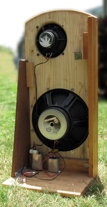

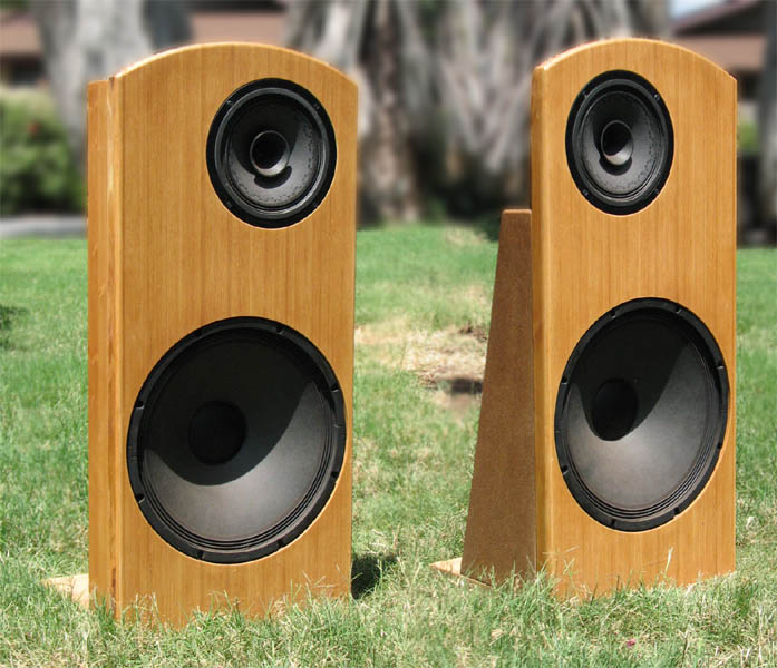

I have used the 15PW3 on open baffle and it was very nice. Good bass, not hard to crossover in the mids. One got damaged in the move from Hawaii, so I don't use the pair any longer. Too bad, nice 15" for OB.
