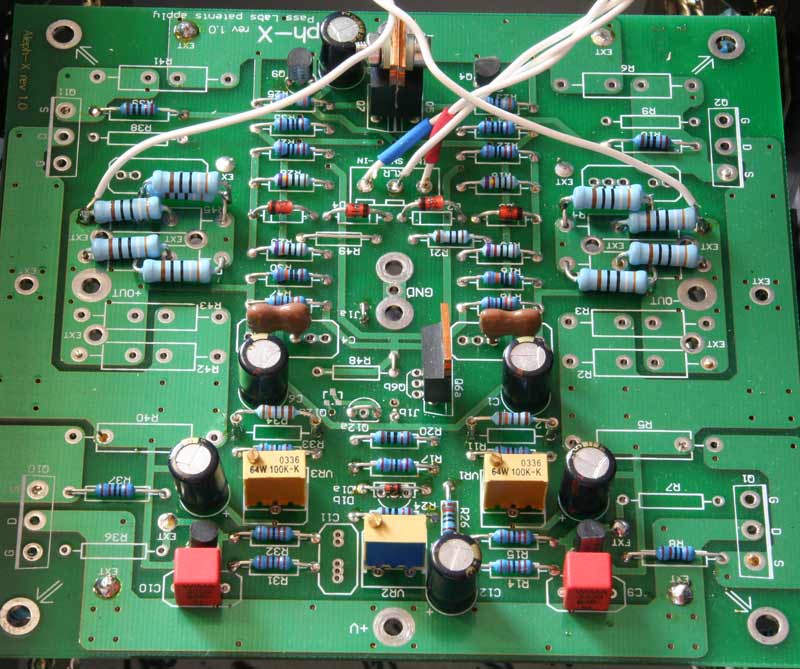

I'm gathering parts for several Aleph-X amps that will be biased like yours (22v, 7-8A). I have a question concerning R2 and R42. Your parts list calls for these to be 0.083 ohms using a bundle of 1 ohm resistors.
Can I use a bundle of three 0.22ohm 5w resistors in this place instead? This will yield an overall resistance of 0.073ohms vs. your parts list that calls for 0.083. Just how critical is this particular value?
Also, with R5, R6, R40, R41, can I use 0.22ohm 5w instead of 0.33 ohms? I have a pile of the 0.22 from an earlier group purchase and would like to use them if they don't cause problems...
And since I'm still rather a noob at this, could I trouble you to post (or e-mail me, it the file size is too large) a close-up photo of one of your populated PCBs so I could take a look at it?
thanks!
Eric

Hi Eric,
0,073 Ohm is no problem. You only must adjust the ac-current-gain resistors.
If you use 0R22 for R5/6 you will get quite a low voltage at your chosen bias and you will have to turn the bias down quite a lot with VR1 and 2. You will also have to lower R11/33 to get low enough.
I´m not shure if this won`t change the dynamic behaviour of the active current source.
William

Eric,
here´s a picture of the populated board. The source and gate resistores are mounted next to the fets on the heatsinks.
William
