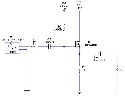

I have tried a number of one-transistor amplifying circuits with BJT's and power MOSFET's. The only amp that could be considered as a very good sounding (in terms of high-end) is the one that I am attaching. The current source in Source branch is a must to obtain low distortion. Inductance or resistors or bulbs used instead of the current source are interesting challenge but do not lead to good sounding circuit.

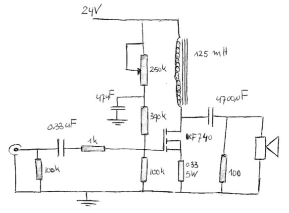

In a source follower:
A) Use a choke load and a 4700-10,000uf coupling cap?
B) Use a 1:1 OPT load with no coupling cap?
This is with a circuit that is 24vdc supply and 4A bias on a MOSFET.
Just wondering if I should try the OPT or just choke load it with a coupling cap....?
Thanks!
I think a choke and a good quality coupling cap might be the easiest way to get a good sounding amp. Transformers are tricky to get right I think. OTOH a 1:1 transformer operating at low voltages can be bifilar wound, which should be an advantage.
If you´re giong to wind your own stuff a choke will definitely be easier.
25Vdc x 4A = 100W, you´ll need a big one! I´d suggest you use two or three mosfets in // with adequate source resistors for current sharing. There are plenty of Mosfets suitable for this, say IRFP 140, IRFP 150 or something like that. Plenty of Mosfet disussions in the Pass labs forum.
A "flyback" diode from source to drain might be necessary, but those are often integrated in modern mosfets.
BTW it seems that protecting diodes has been up in this thread before...
I´d use 3x 2200uF low ESL/impedance caps. Caps made for switching PSU´s are usually low loss types, look for such.
Remember to bypass with quite a few uF of nice plastic film caps, or even better, paper in oil caps.
