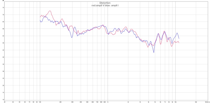

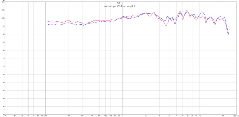

At the suggestion of esl 63 I made some measurements to see the difference between voltage driving and current driving. I remade the PCB of my test amplifier so that I can switch the feedback from voltage to current with a few solders. After verifying that everything was working well I made measurements on 2 different ribbons. Both are formed by 4 strips Alu 12 um thick, in series, held by 12 g / m ^ 2 paper, for a total width of 27 mm, with corrugations on a few cm at the ends, but while one (C21A) was finely embossed in the part immersed in the magnetic field, the other (C21B) had longitudinal ribs for stiffening.
I only report the measurements on the C21A ribbon, as the other were the same
C21A_V & I_SPL
C21A_V&I_THD

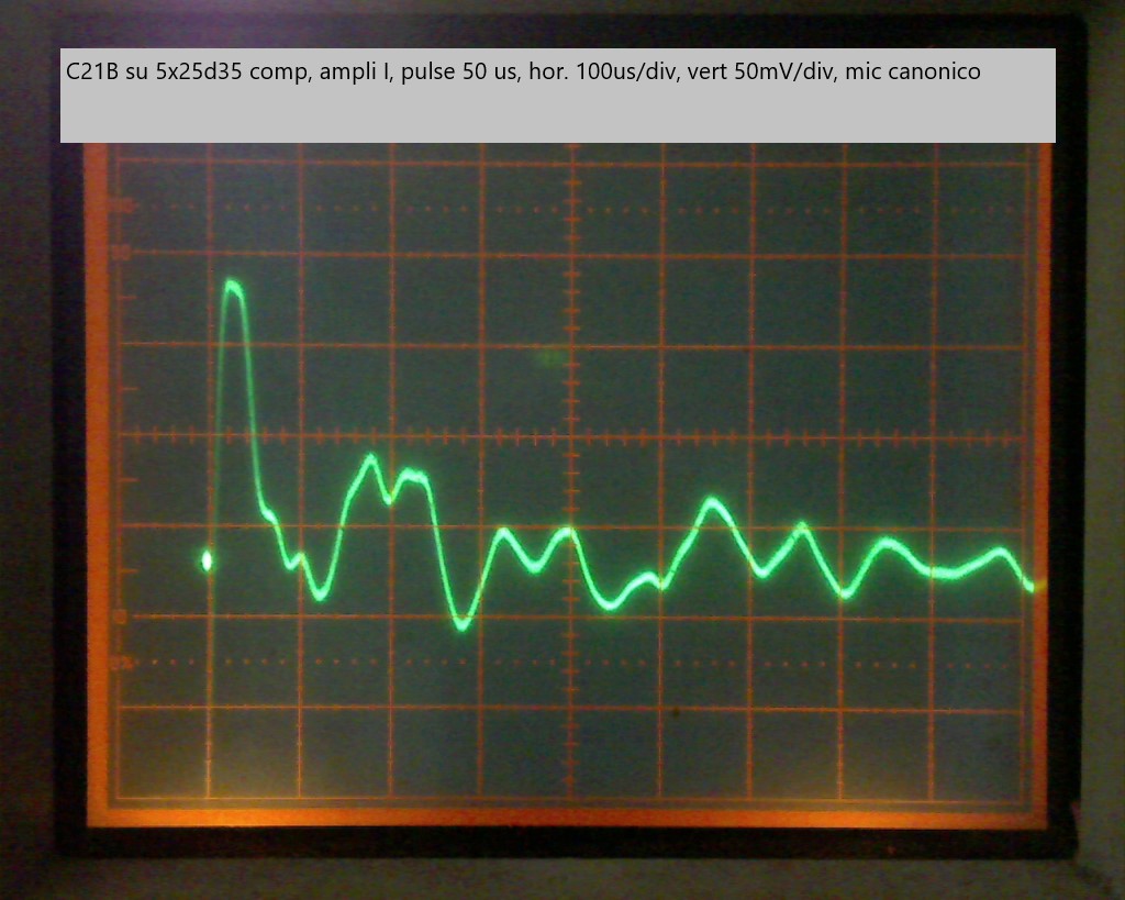

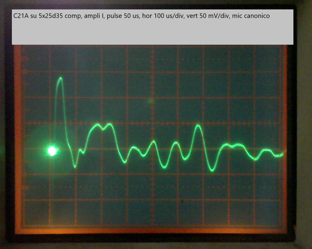

They are the same, as expected, but the responses to transients are quite different. I didn't trust REW's calculated responses, and measured them with another microphone and oscilloscope.

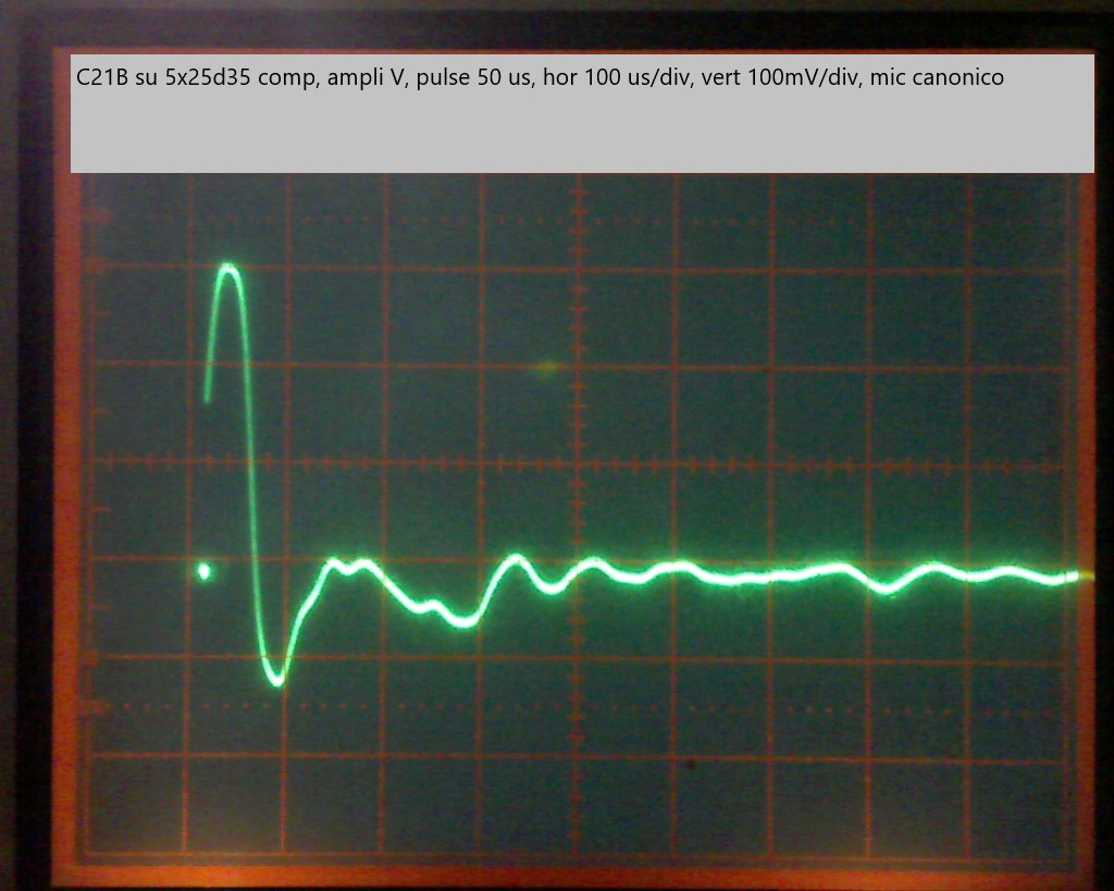

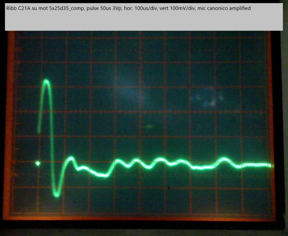

C21A with voltage drive
C21A with current driving
C21B with voltage drive
C21B with current driving
The images need no comment.
At this point, at least for me, the current driving, with regard to HIFI, is dead and gone

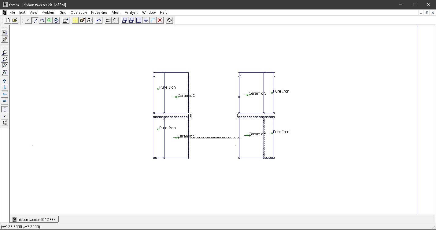

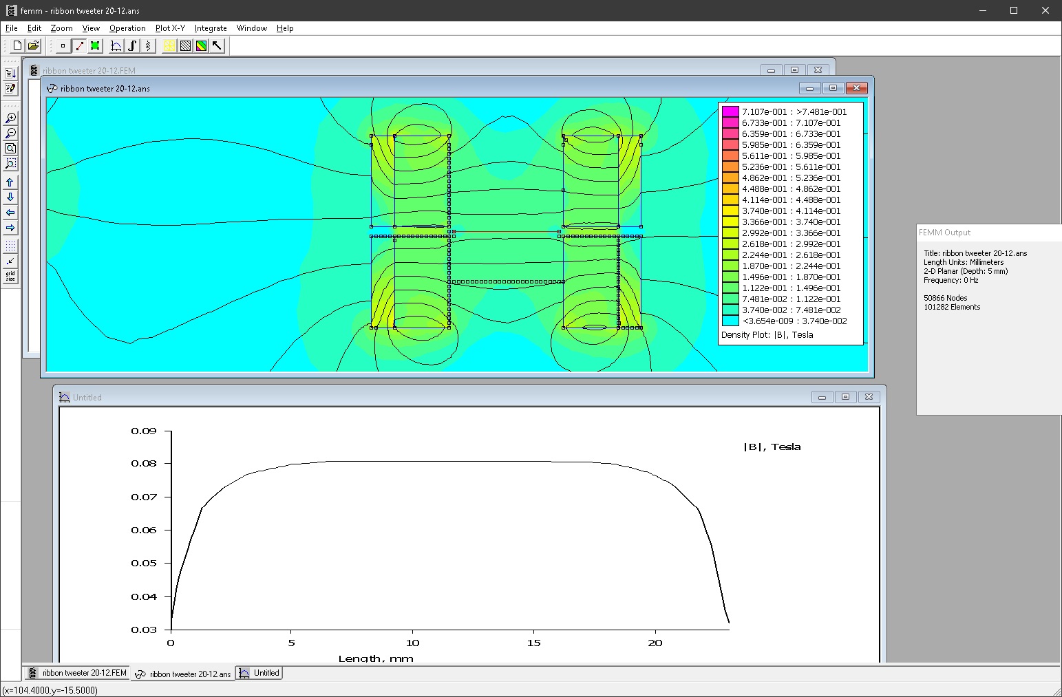

what i ment by distortion from unsupported part. is like the transition to where it is clamped to where it is free to move. i think there should be added weight or supported by foam or felt from both sides. it tends to create distortion on the edge where it becomes (semie free to move, since its so close to a supported part it cant swing like in the midle of the ribbon)
here is a femm model with the magnet arrangement.
its not strong but huge, but ignore the strength. just see how flat it is.
you can play wit the distance in between the magnets to get different results in this case it was 2 mm

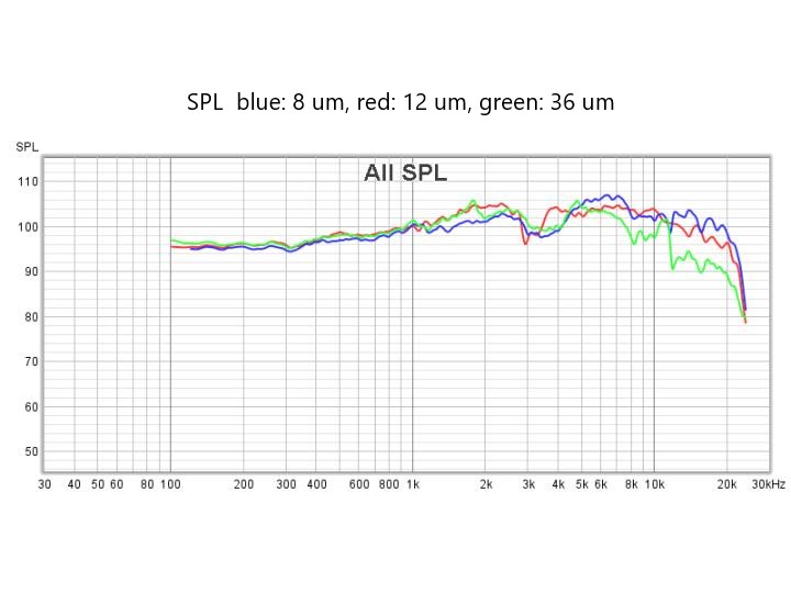

Here's how things change by varying the thickness of true pleated ribbons
Pleated_SPL
Pleated_THD
The dip in the SPL between 3 and 4 KHz is due, as usual, to the reflection from the table where the motor rests. We see that in the response there are significant differences only at the high frequencies, as was logical to expect. There is some reason to think about this, because the difference in SPL at 20 KHz of thick ribbons compared to thin ones is greater than what one would expect taking into account only the parasitic inductance, but this is another argument.
The THD instead, if you make the difference with the SPL levels, at high frequencies it doesn't change much, while at low frequencies it seems that 8 um is the best choice, but personally I would prefer 12 um because in my experience it seems to me that with 8 um it is more difficult to control the rattle.
For the avoidance of misunderstanding I want to clarify that when I speak of high THD in ribbons I mean relatively high, and not high in an absolute sense. In fact, looking at the 2 graphs, above 200 Hz the THD is still more than 40 dB below the SPL, which means less than 1% of distortion, with SPL = 100 dB at 1 KHz and mic at 6 cm, which corresponds approximately at 87 dB SPL with mic at 1m. I did not measure at higher levels because the Umik microphone starts to distort at low frequencies at 100 dB, and if you move it away different peaks will come out due to reflections from various nearby objects.

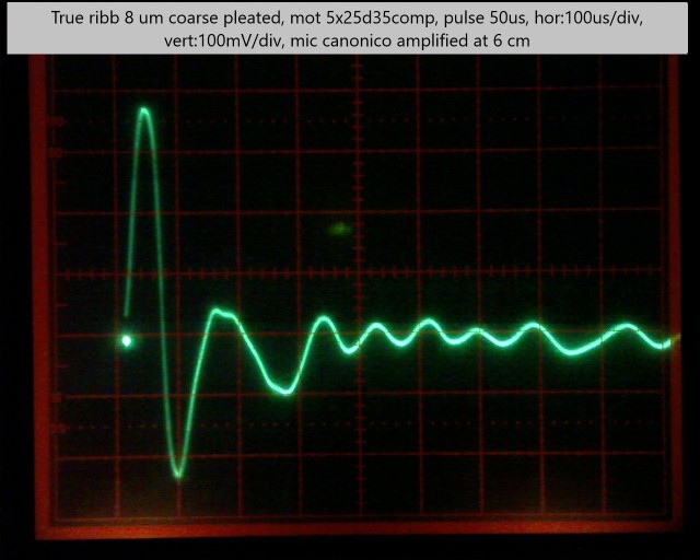

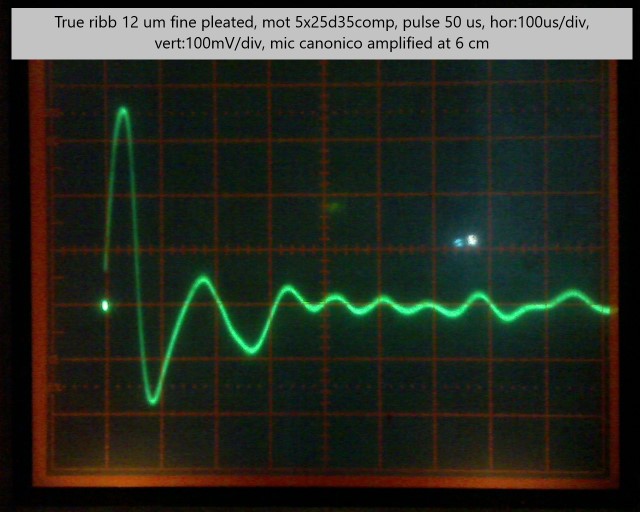

Below are the impulsive responses of true ribbons of different thicknesses, with unique damping with 3 cm foam behind:
True rib_8
True rib_12
True rib_36
The rise and fall times are better with the smaller thickness, but the overshoots and undershoots are less with the greater thickness.

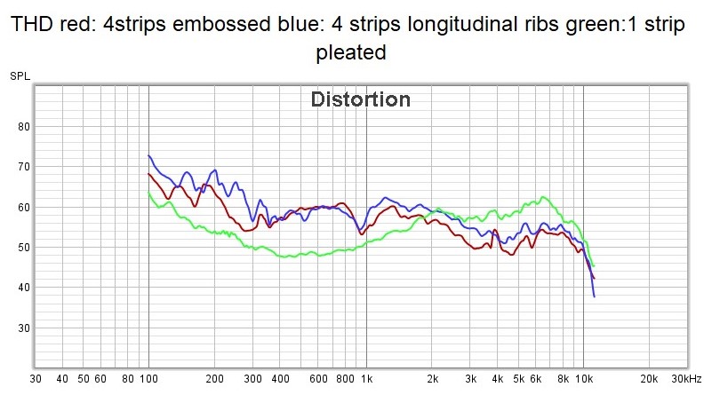

Now I compare the measurements on 3 different ribbons: all are made with Alu 12 um and a total of 27 mm wide, 2 are composed of 4 strips supported by 12 g / m ^ 2 paper, but the first is embossed and the second has 1 longitudinal rib on each strip. The third is a true ribbon with fine pleating in the center and coarse at the ends
Monostrip vs multistrip
monostrip vs multi_THD
The difference between the THDs of multistrip ribbons and true ribbon is evident and I must underline that this difference persists by changing various parameters such as stretching of the corrugations in the true ribbon or pleating of the 4 tracks instead of embossing. At frequencies below 2 KHz the THD is much better in true ribbon and this is understandable because the ribbon is stiffer in the transverse direction. Instead I don't understand why the THD is worse above 2 KHz (but still below 1%). I have tried to make some longitudinal cuts in the true ribbon but the distortion gets worse below 2 KHz and does not improve above.
Difference in impulse response: C21A, as mentioned above, is a 4 track with 12g / m ^ 2 embossed paper backing
C21A_5x25d35_comp_V
True rib_12
The impulse from the 4-track is much better. So if I had to make a tweeter I would certainly choose a multitrack tape, but for a mid-tweeter the choice is a matter of taste, and for a full range you have to make a separate speech. In fact, the measurements I made generally start from 100Hz or a little below, because to start from 30 Hz I would have had to reduce the volume by a lot in order not to deform the ribbon, or consider only ribbons with lateral suspensions, which in my opinion are the only ribbons which allow a full range without (or almost) rattle problems

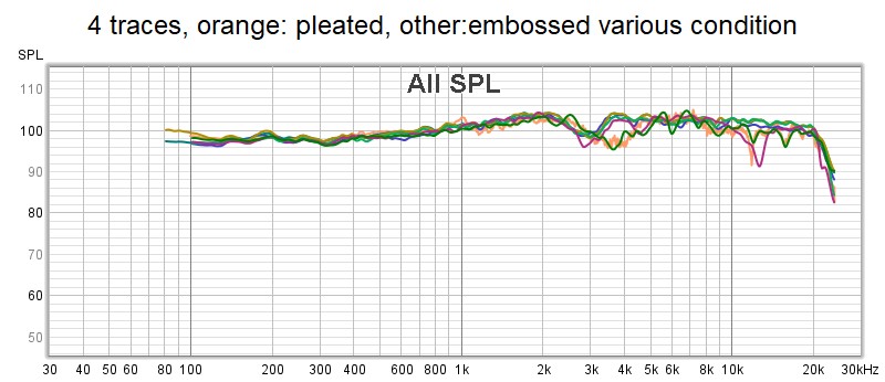

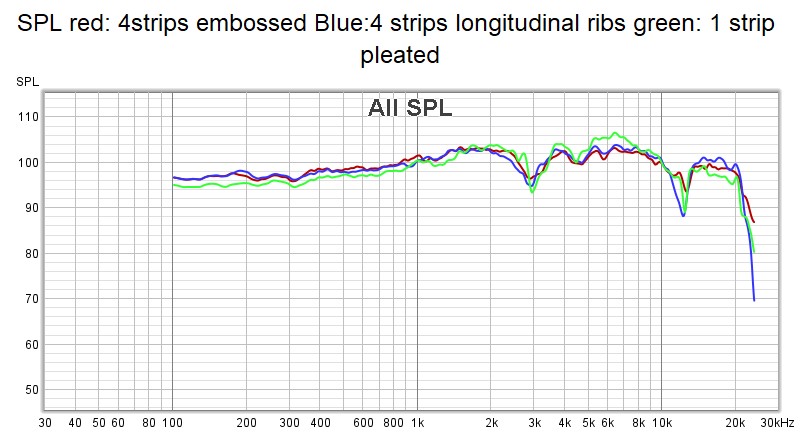

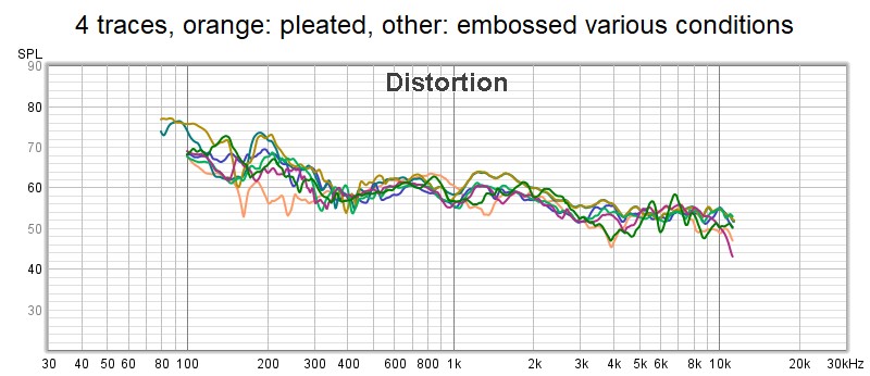

Now let's see the difference between pleating and embossement. I used 2 tapes: the first 4-track and the second true ribbon.
4 traces pleated vs embossed
4 traces pleated vs embossed_THD
The various conditions are: more or less taut ribbon, motor with 5 mm or 10 mm thick magnets. It seems that the pleating gives a little better results at low frequencies, but the effect is not striking and it is understandable because being 4 tracks the pleating does not stiffen the ribbon in all its width.

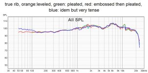

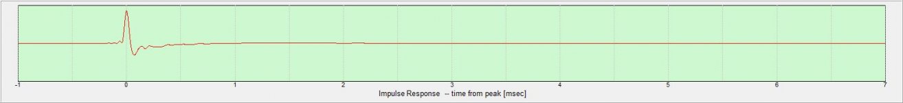

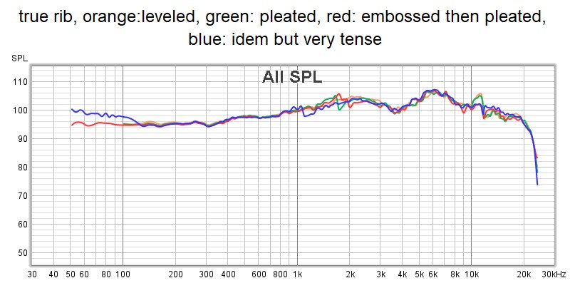

True ribbon
True rib_pleated vs embossed
True rib pleated vs embos_THD
It is clear that a smooth true ribbon is not worth it, and this too was to be expected.
The difference in the impulse response of a pleated ribbon compared to an embossed one is minimal, with a slight advantage for pleating

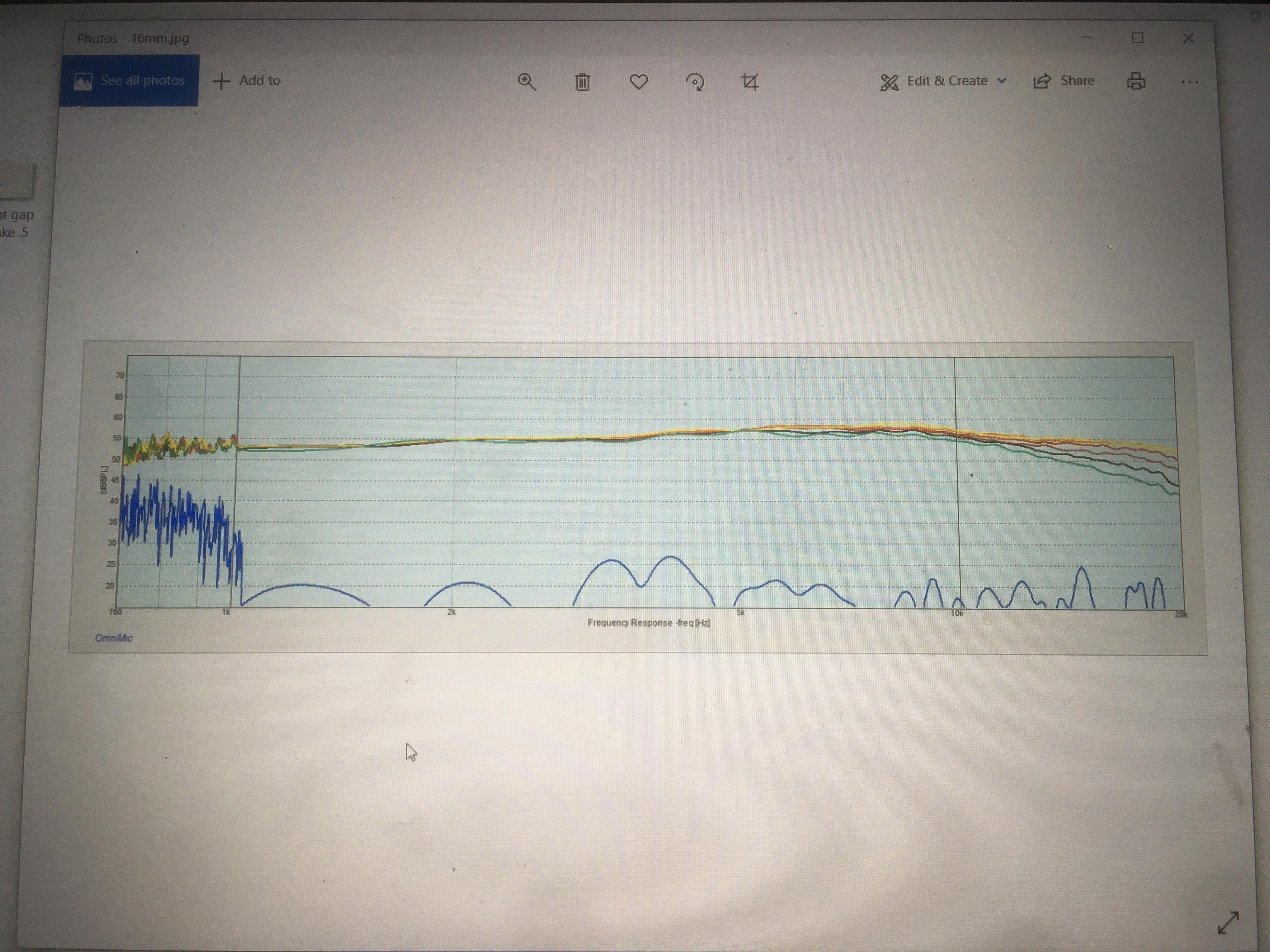

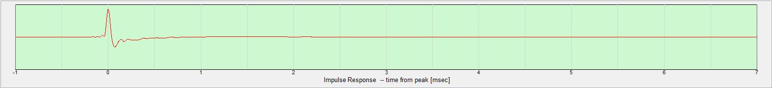

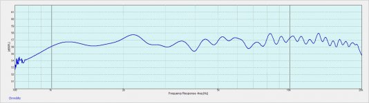

Well hello ALL. Been a long time! Good to see ya all still at it ha. Thought I would just check in and to my surprise the ribbon distortion topic was on deck. I did do a lot of development work on this issue mostly because I wanted to take a smaller true “free swinging” ribbon to a lower crossover point. I see mention in this thred a number of things. Connections, mag field uniformity, ribbon construction, transformer construction, etc. While they all can have some effect on ribbon distortion, they all turned out to be minimal at best unless of course something was done really poorly.
In the end I did find a major contributor to ribbon distortion. In fact it was so big that once dealt with the distortion was an entire order of magnitude lower in this lower freq range. That’s right, an order of magnitude. Huge reduction BUT, well I will get to the “but” latter. The final design was a 75 mm long by 15 mm wide ribbon that could be crossed over at 1 khz with just a 2nd order filter without the large increase in distortion below about 2 khz typical in smaller free swinging ribbons. Basically I achieved distortion results at these lower freqs that compete with the better domes.
Understand however that I was really only concerned with distortion below about 2 Khz and only in smaller ribbons (100mm long or shorter). Above this freq the tech I developed had no effect BUT IMO above this freq a good ribbon is easily had with just some work on the diaphragms construction details and I wasn’t too concerned here. You can play with ribbon materials, thickness, corrugation size, adhesives, etc etc etc until u get a smooth response and that’s about it. Some work on the “slot” and face plate can help with response as well but again not a big contributor to distortion at volumes below about 100 db?. Not sure here but suspect diffraction at higher volumes can be an issue.
Basically the rising distortion with small ribbons taken to lower freqs are aero dynamic. Specifically at the ribbons edges. When the ribbon is called on to move larger distances, the ugly turbulence at the ribbons edge starts to be a problem. Once I discovered this I did some research and found that others have understood this in the past.
So why don’t we see designs out there that deal with it? Well for one the solutions they came up with are basically just making the “gap” between the ribbon edge and the magnet or pole piece very small thus reducing leakage and turbulence here. This is a very difficult and unforgiving way to overcome the turbulence at ribbon edge. U have to make a near perfectly straight ribbon, deal with the difficulty of aligning it at assembly into magnet, and when all done you can’t use it at lower freq ( unless u make a big one) because the ribbon scrapes the magnet at higher volumes due to instability. It’s effective BUT it’s far from practical for both manufacture and user. AND of course even IF you do find a practical way to build it you still have a fragile and poorly controlled diaphragm that will destroy itself at the lower freqs.
What was needed was twofold. 1- a practical way to deal with the turbulence at ribbon edge, and 2- a diaphragm design that won’t shred its self at lower freqs. Good luck with that 😉.
Well it just so happened that the solution I came up with did both. 2 bird’s one stone. Holy Grail right?
Not so fast, we gota talk about the “BUT”. What I found, at least to my ears anyway is that although the distortion was significantly reduced, I did not hear a significant improvement in sound quality at “normal” listening volumes. I will call this crusing at around 90 db or so. At higher volumes it was noticeably better BUT is certainly wasn’t staggering. I suspect the type of distortion created by the turbulence isn’t all that big an issue perceptually.
The bigger value in the design was that now I have a reliable smaller ribbon that can go low. The significantly lower distortion was of value but not as much as I assumed it would be.
Now I would love to just tell ya all how I accomplished this but my plan is to sell the tech off down the road so I have to hold it. I have a patent written (not submitted) to go with it for anyone interested. However I have let the cat out of the bag with the turbulence thing so the DIY community can play with this area if it wants.
I see there is a company in Russia I think that has some very low distortion “ribbons” that can be crossed lower. Nice stuff and I don’t mean to cast negative here but I too played with that design years ago. Basically ya have a half roll surround at ribbon edge effectively eliminating the “gap” between ribbon edge and magnet. Great way to do it however in my own experiments I didn’t like the hash at the higher freqs that I believe go along with this basic structure. Obviously it’s a good tweeter but I wanted the faster decay I see with a true free swinging ribbon design.
Then of course there are the planer style drivers and the folded diaphragm designs that have no “gap”. Here too you can get low distortion at lower freqs and I made many protos of this type. However in the end they simply could not be made with all the sonic attributes of a free swing ribbon. They either had poor horizontal dispersion (diaphragm too wide), or their resonance at the lower crossover points colored the sound.
So Merry Christmas, I hope I’ve given ya some ideas to play with 😉
