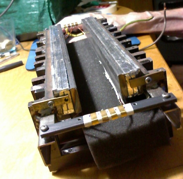

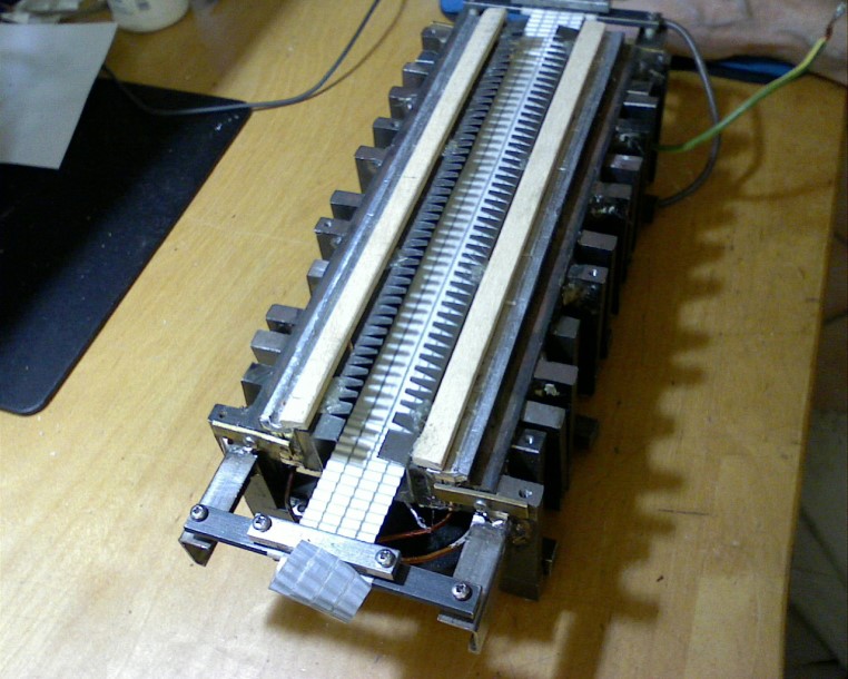

On the Distortion of Ribbon Speakers
I searched the web for information on the mechanisms of distortion in ribbon speakers, but I found only hypotheses, reasoned and even shareable suppositions, but no ad hoc measures. Maybe those who make these speakers know all about the subject, but if so, they keep it to themselves. So being a DIY enthusiast of ribbons, I decided to do some research, within the limits of my cognitive and economic possibilities.
One of the assumptions that everyone (myself included) has made is that a primary mechanism of distortion arises from the non-uniformity of the magnetic field
The distance between the pole pieces, having to contain the width of the strip, is always relatively large with respect to the height of the expansions themselves, therefore it is normal for the ribbon, during large movements, to operate within very different magnetic flows.
So as a first step I wanted to verify and possibly quantify this hypothesis.

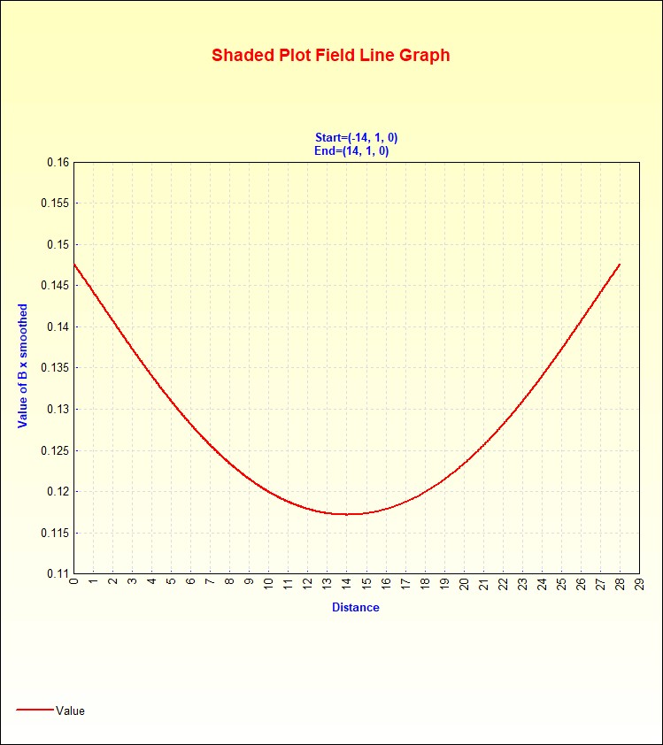

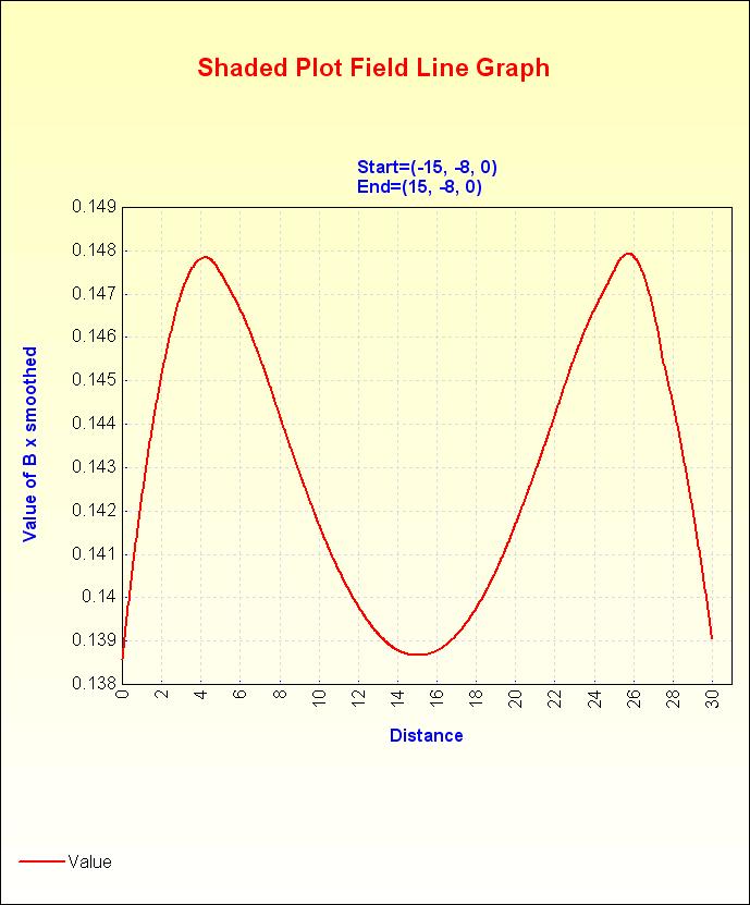

As a first approach to see how much magnetic field uniformity affects THD I used the ribbons in closed box which I have already extensively described in another thread, my ribbons full range in CB - diyAu...ngine Long_base_field Long_base_0 Long_base_8

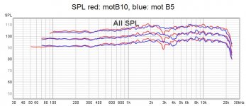

The ribbons (just over 2 Ohm) are each driven directly by their own dedicated amp. The 2 amps are identical and without response corrections
I made THD measurements using the REW program and the calibrated UMIK microphone placed 15 cm away from the ribbons and on the approximately central axis. The measurements are related to 4 input signal levels, in 6 dB steps. The curves in red refer to the left box with the shaped pole pieces, while the blue refers to the right box with the flat, traditional pole pieces. I remind readers that these are ribbons with side suspension.
Box_overlay SPL
the plots of the left box are more bumpy because the case is leaning against a side wall as well as the back wall

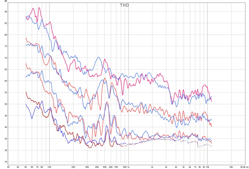

Box_overlay THD
Here I am surprised, because the differences between red and blue do not seem significant to me, in the face of very different uniformity of magnetic fields. So I conclude that a bad uniformity of the magnetic field does not affect the THD, even at low frequencies where the excursion of the ribbons is large. I find it strange but these are the results. The phenomenon that I notice and do not like instead is that while the SPLs increase by 6 dB per step, the THDs increase more, 10-13 dB per step, in particular at low and medium frequencies, up to about 3.5 KHz (I don't take into consider the very low THD parts, close to ambient noise). I make similar measurements on a pioneer moving coil woofer and I find that a 6 dB increase in SPL corresponds to an increase in THD of about 8-9 dB

Here you can see the difference between uniform and non-uniform magnetic fields: With the same RMS audio input, the IMD of the driver with a more uniform magnetic field is substantially lower, about half that of the other driver.
At this point I have to check how much the side suspensions have to do with it: I make other measurements with another test engine, only 25 cm long, where first I put shaped pole pieces and then I repeat the measurements after changing the pole pieces with other flat, traditional ones. .

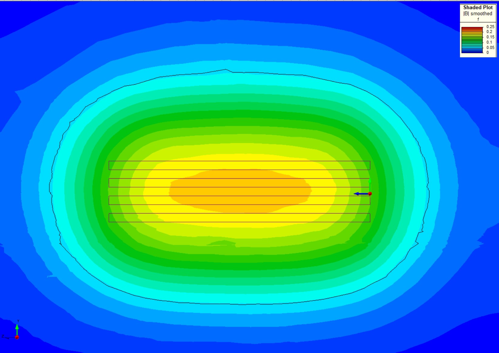

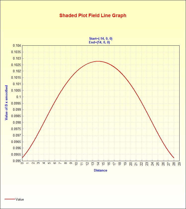

Motor A with shaped pole pieces:
5x25d41real
5x25d41real_field
The field is overcompensated, but I already had those polar expansions and then I didn't have the possibility to do them ad hoc. However, it is much more uniform than that of motor B, with flat pole pieces:

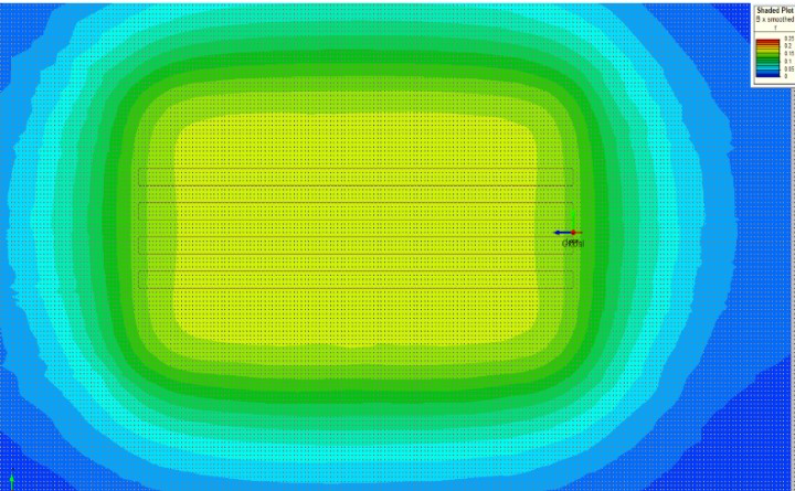

5x25d41base
5x25d41base_field

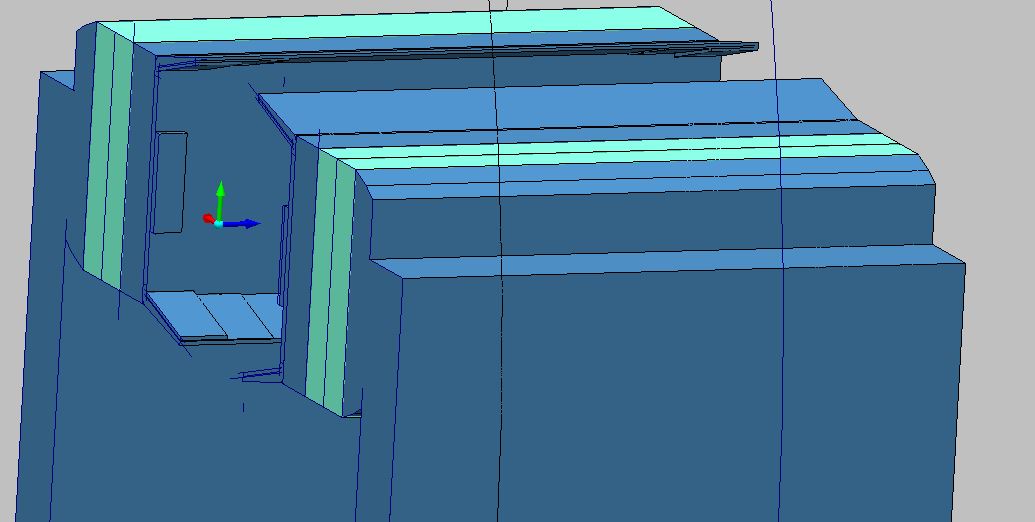

Hello to Jedi
I have not yet given details on the shape of the polar expansions, so I am attaching a photo. I actually obtained the tapering of the thickness with a constant thickness shaping of the longitudinal profile. The simulations of the field in the 2 cases give almost identical results
If you mean linear distortion (deviation from the flat trend of the frequency response) surely yes, and it is visible in the curves I posted, but it is my belief that a partial obstacle in front of the ribbon does not affect the total harmonic distortion (THD), otherwise AMT, ESL and push-pull isodynamic drivers would be crap

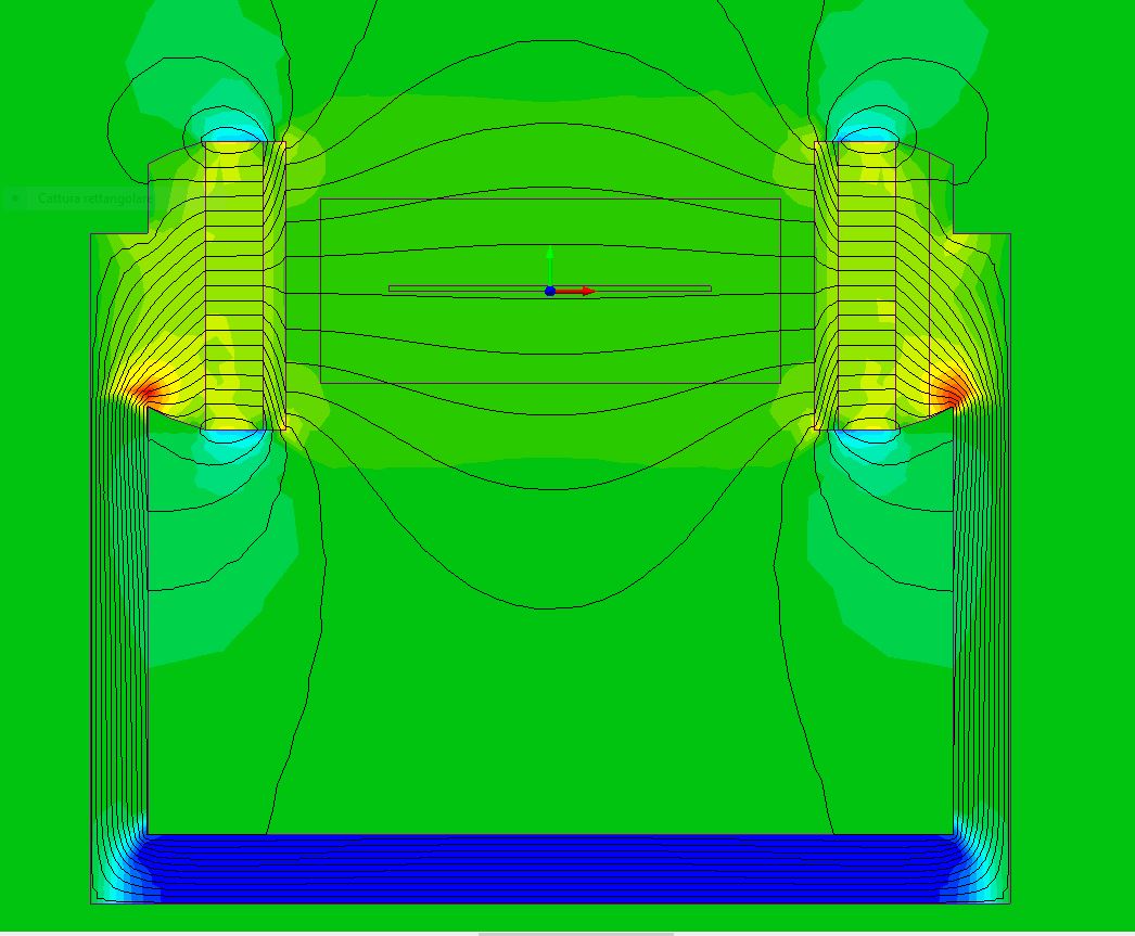

At this point I wanted to verify if the modulation of the magnetic field by the current had something to do with it. Not that I believe it possible, because according to the simulations I made the variations of the field due to the current in the ribbon are irrelevant, but since it is a hypothesis advanced by some I decided to verify it.
So I made a comparison between the distortion of the same ribbon mounted first on a motor with a magnetic field of about 0.1T obtained with 5 mm thick magnets and then on another with double the magnets (10 mm total thickness) and an adequate increase of the section of the iron closing the magnetic field, therefore with a magnetic field about double, of 0.2T. In this situation 2 things happen:
1) the same current in the 2 cases causes a percentage variation of the magnetic field smaller in the motor with a higher magnetic field
2) for the same SPL produced, the current in the ribbon on the motor with a higher magnetic field is much smaller
Therefore, any effect of modulation of the field by the current should be substantially less, for the same SPL, in the motor with a higher magnetic field.

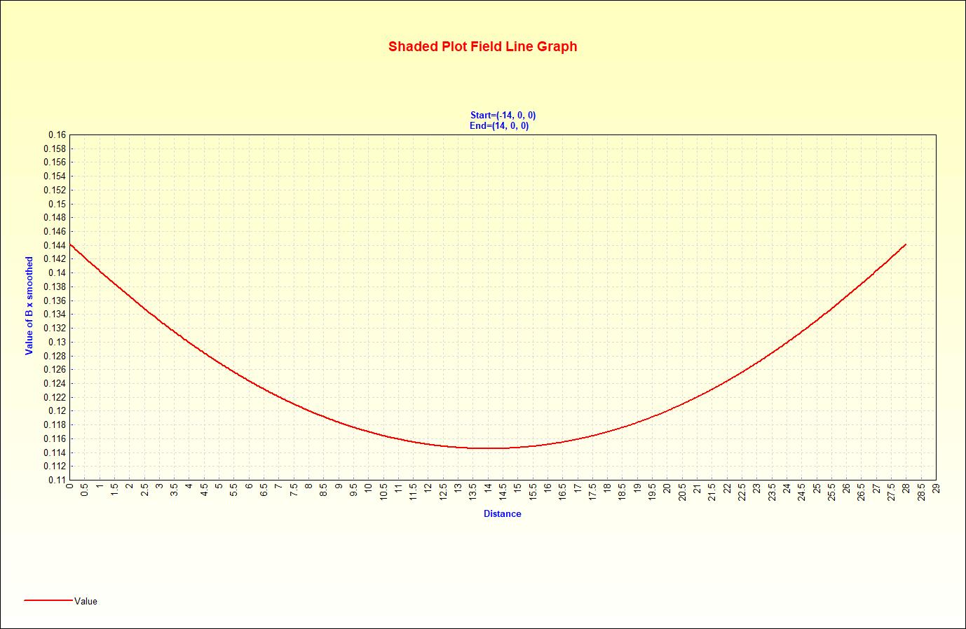

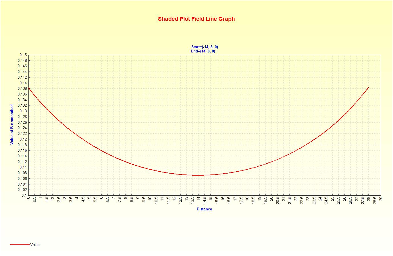

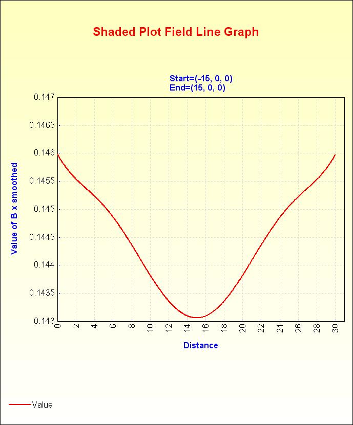

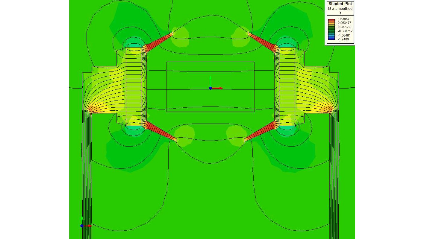

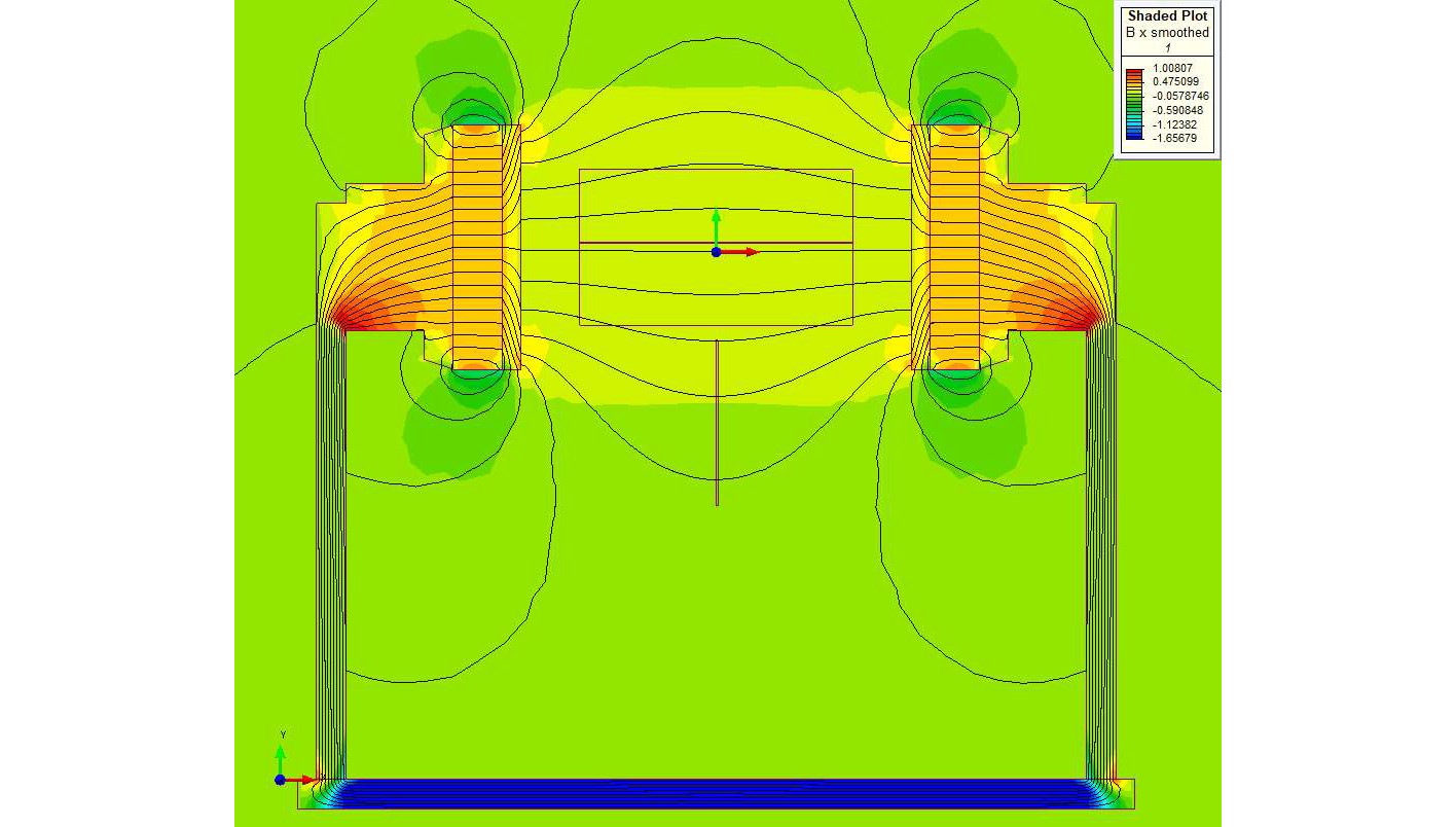

To be sure of the results I checked the magnetic field simulations with measurements. In the following I will call motor A10 the one with double magnets and compensated with shaped pole pieces, and motor B10 the one with double magnets and flat pole pieces, while A5 and B5 resp. the motors previously called A and B.
For the sake of brevity, I define the axes as shown in the figure: red = X, green = Y, blue = Z
Origine
Motor A10
(10x25d35_3d1)
10x25d35_3d1_field (magnetic field in the plane YZ, and X=0)
Motor B10 (10x25d35_base)
10x25d35base3d_field (magnetic field in the plane YZ, and X=0)

Note that the range of colors in both plots is from 0T (blue) to 0.25T (red) in 21 colors

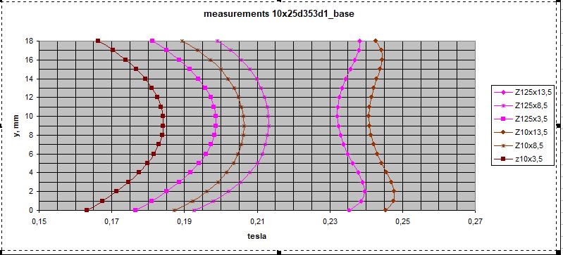

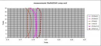

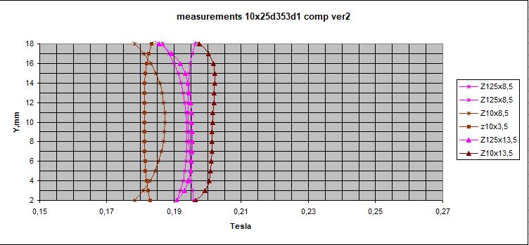

Since in the simulations I noticed that the tolerance on the dimensions of the pole pieces is quite small, for safety I measured the Bx component with a Hall probe, both for Z = 125mm, (center of the motor) and for Z = 10mm (near 1 end ) by moving the probe along Y (direction of movement of the ribbon) I measured Bx on 3 values of X: Resp. 13.5, 8.5 and 3.5mm, in order to cover the entire width of the ribbon (27mm)
. The purple color refers to the measurements at Z = 125mm, while the brown color is for the measurements at Z = 10mm. In the 2 graphs I have kept the same scales for ease of comparison
Motor B10
10x25d35base_meas
Motor A10
10x25d35 3d1_meas

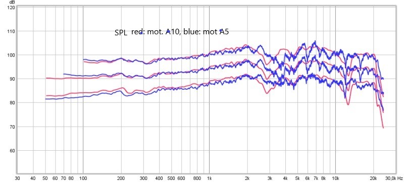

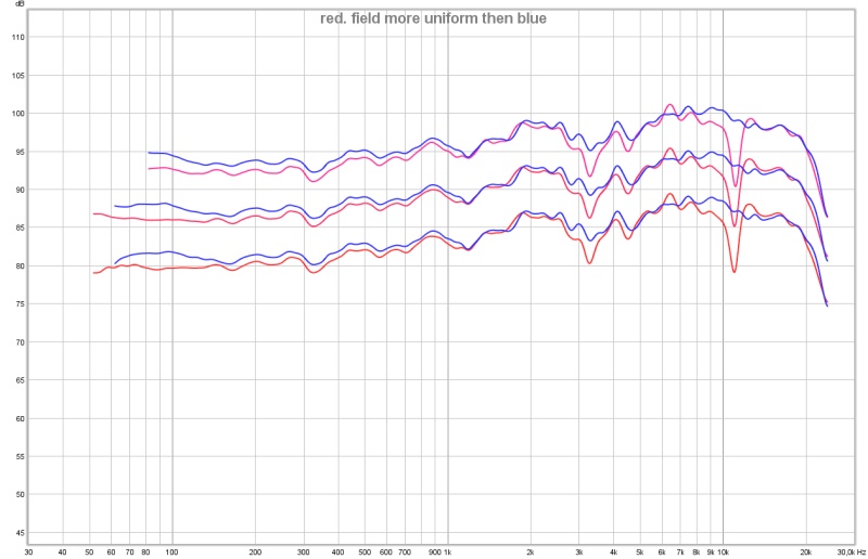

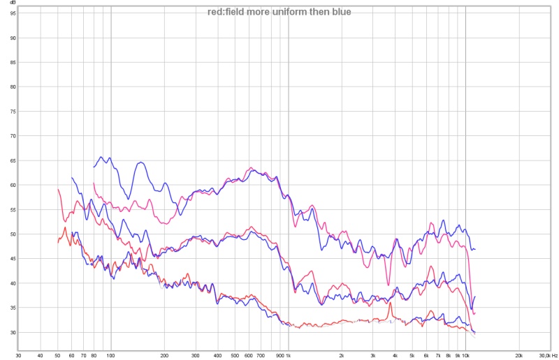

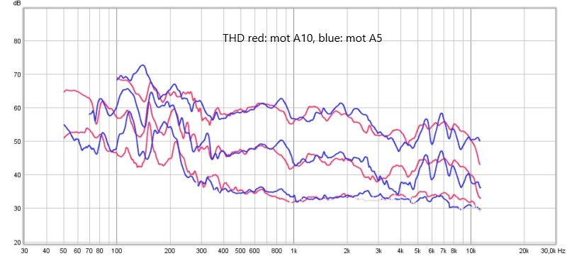

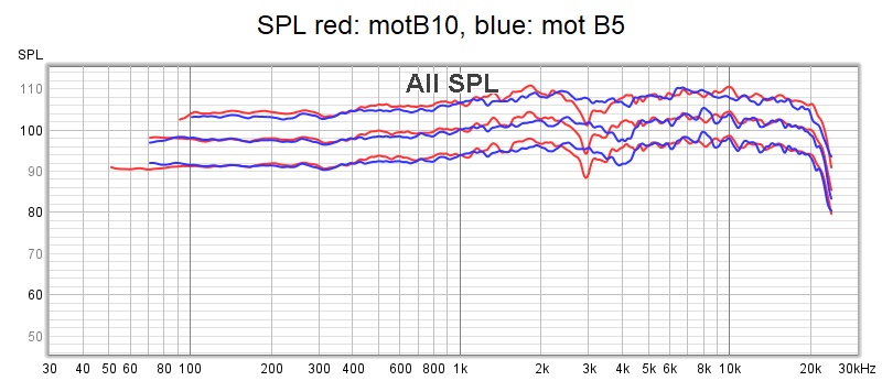

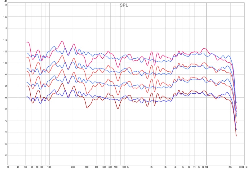

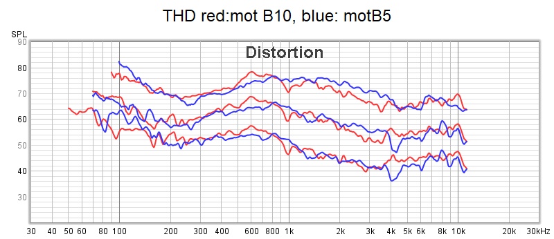

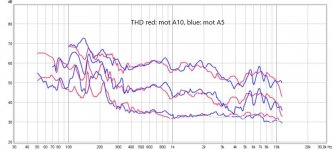

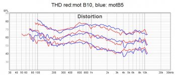

At this point the engines are characterized and I can move on to the measures. I have used several ribbons, but since the results are the same, for the sake of brevity I will report the measurements for only one. The width of the magnetic field is 35 mm, while that of the ribbons 27 mm to avoid turbulence problems in the gaps.
C21A su 5x e 10x_base_SPL
C21A su 5x e 10x_base_THD
C21A su 5x e 10x_comp_SPL
C21A su 5x e 10x_comp_THD

I don't see significant differences in THDs, with the same SPL, so I conclude that:
The modulation of the magnetic field by the current in the ribbon, if any, is negligible.
As for what some claim, that iron pole pieces reduce distortion with a mechanism similar to that of the copper ring on moving coil speakers, it definitely seems to me like a propaganda fable.
So I ask myself: If the primary cause (s) of the distortion of a ribbon is not the non-uniform magnetic field (excluding low frequencies) nor the modulation of the magnetic field, which is it? The only culprit remains the ribbon, you want the non-linear suspensions, you want the ribbon's selfmodes, so on and on. If any of you have ideas about it or criticism of what I have written, it is welcome, as I am going to start investigating the ribbon itself (I still don't know how)
