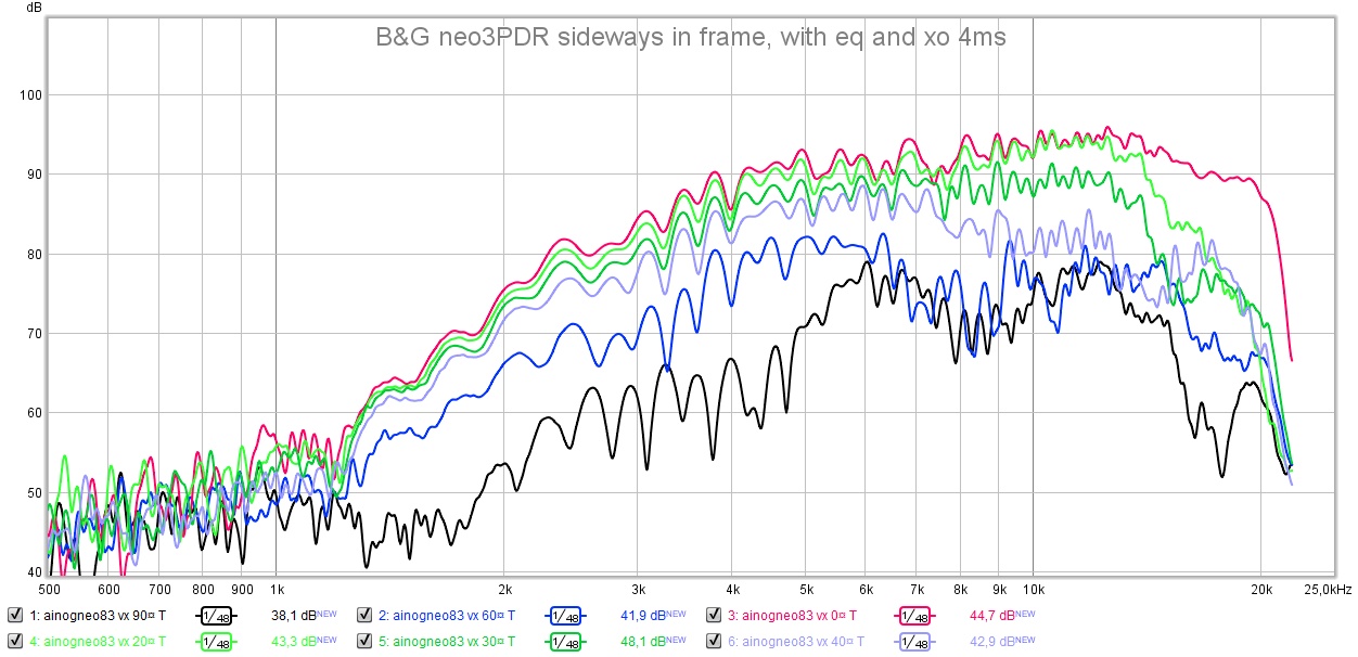

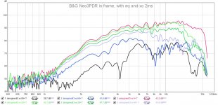

Here are my measurements, 0 vs 90 deg difference is 20dB when response is pure dipole at 2kHz. OllBoll's measurements show only 10dB attenuation at 90¤. Measurement distance 1m roughly.
I use the Neo3 90deg turned, so response above 10khz suffers. On the other hand I get better vertical dispersion. The driver is mounted on 8mm thick plywood frame which makes problems 6-8kHz

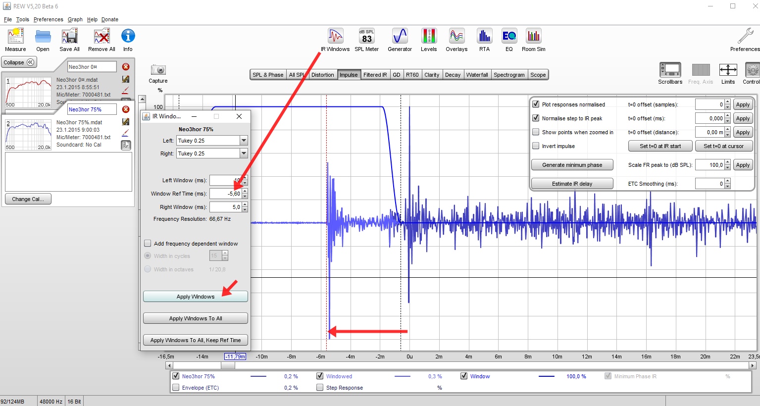

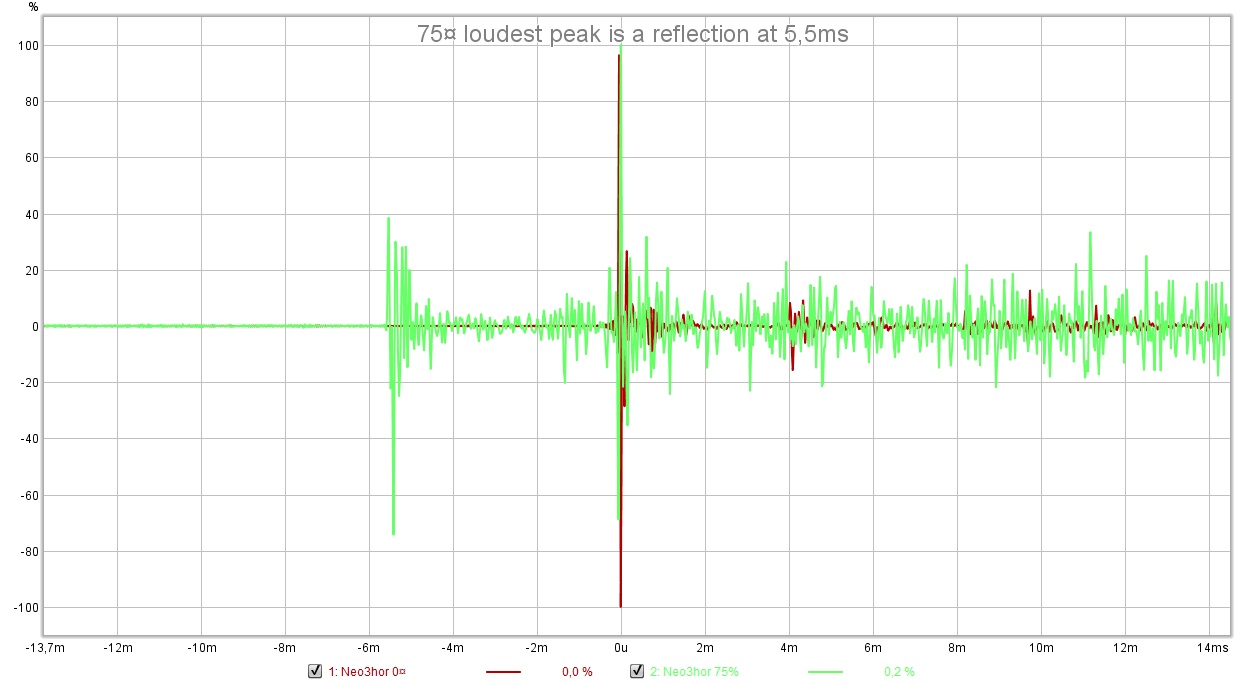

OllBoll, please check impulse responses of your measurements! REW automatically sets measurement reference t=0 to the loudest sound which sometimes is reflected and delayed several ms from first peak.
In this example mistake occurs first at 75deg, the 5,6ms dealyed reflection is louder! Second pics shows how to correct it (apply only for that measurement!)
You are right that I probably had a bit too long gating so here is the same measurements with some shorter gatings:
But yeah you are right that the 60-90 should probably be lower, I might not have had the angles perfectly and with the mic distance of ~ 50 cm and measuring in a room that will probably also hide some of the null.
And on 90-180. This is two of the tweeters glued back to back so 90-180 is same as 0-90.

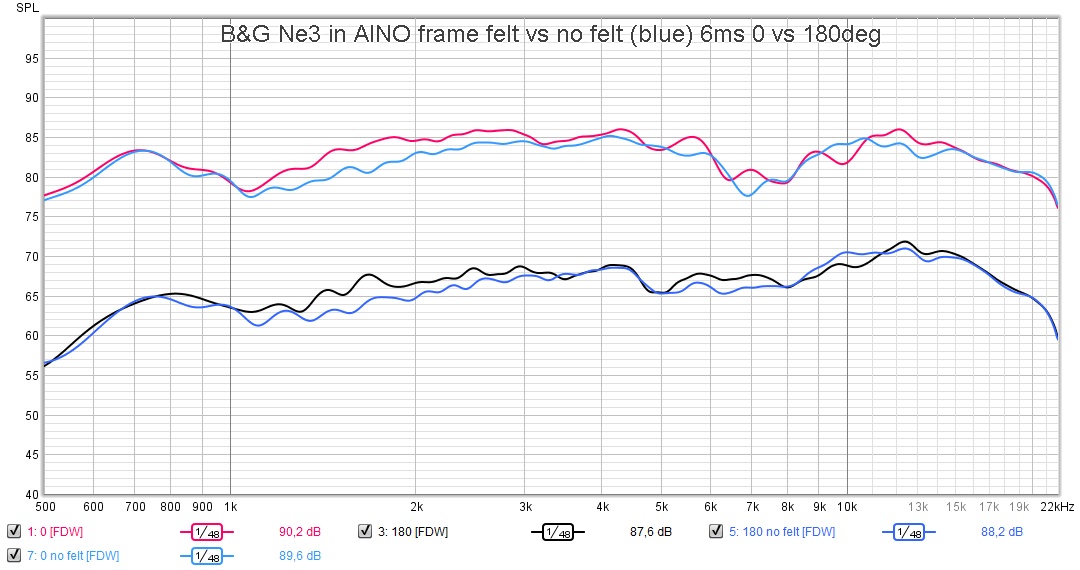

It is interesting the jahuzi had put a small felt ot the sides of the neo 3. The membrane is still the same. But for a the half of the openings the ration is 1 to 2 and for the other half it is 1to3. The effect of the dipolewidth smears off.
I think we can see the same effect with the tweeter of OllBoll because the membrane is not flat. But the ratio is still to high, woth the tweeter fromm ollboll

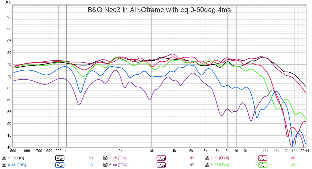

If I equalize the front response to somewhat linear, both look like this:
What I still like about the response:
I have tried to keep the colors and the division according to your VIFA diagram. Does the VIFA have some kind of diffusor in front of the dome?

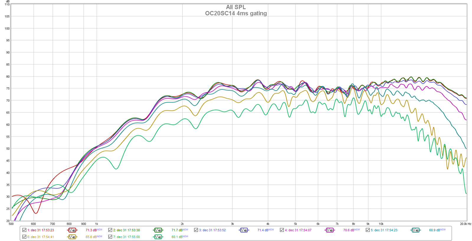

OC20SC14 from OllBoll:
Size:
33 mm wide
9,5 mm smallest depth
16 mm biggest depth
24 mm effective cone diameter (membrane)
Resulting dipole bafflewidth:
Smallest 71mm
Biggest 97mm
We get a Ratio of
Smallest 1 to 2,9
Biggest 1 to 4
The resulting dispersion:
https://www.diyaudio.com/forums/att...ivity-dipole-tweeters-oc20sc14-4ms-gating-png
After this i will go the other OC16 and OC25....

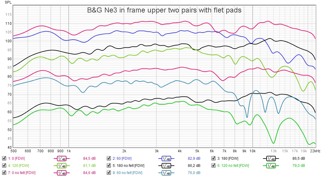

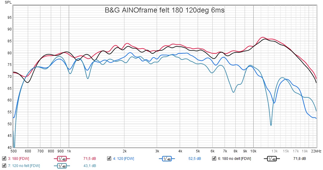

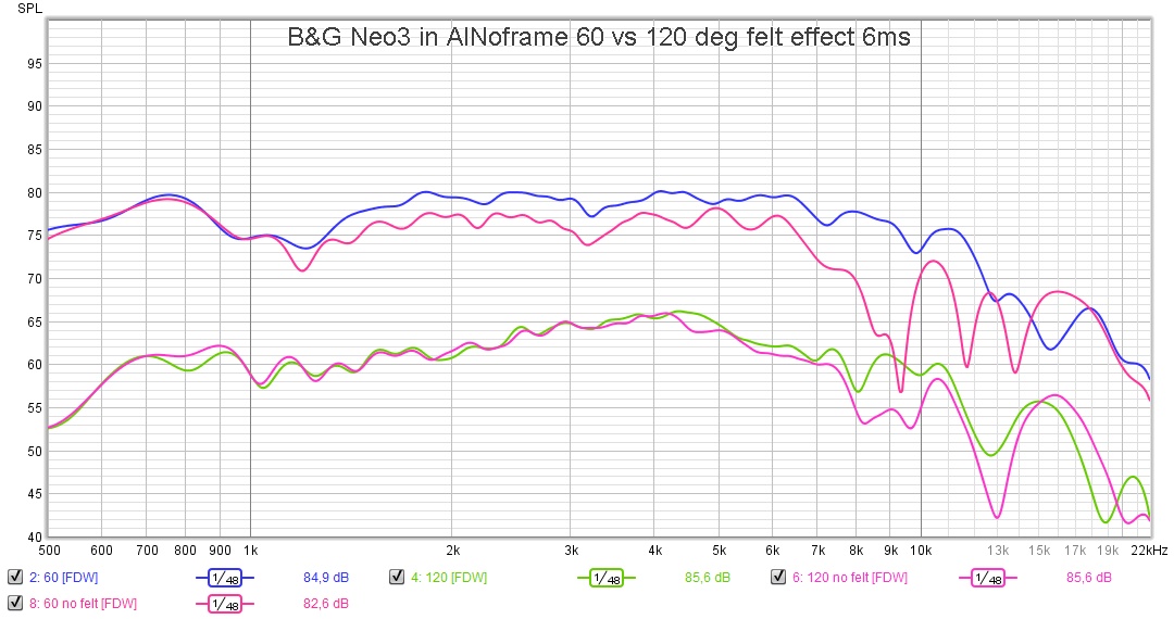

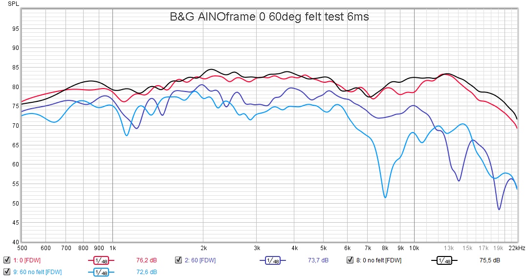

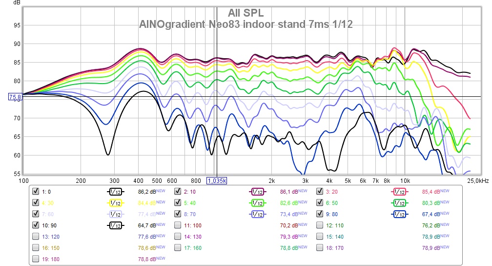

Fist, I know that the frame and attachment of B&G Neo3PDR in AINOgradient is not perfect. Esthetics say that the drivers must be screwed on the backside. Physics tell that plywood frame must have decent thickness, 8mm on my case. This means that high frequencies will have diffractions that make frontal response and dispersion worse than the backside.
I put the Neo3 sideways, because the unit ha same height as Ne8's width, and I hoped that open area above and below the driver would help dipole action.
So, today I ran some freehand measurement of just the Neo3 tweeter, without any xo or eq. We can see that on-axis frontal response has dip around 8kHz because of frame interferences. The however get neutralized on power response, because typically for such interfeneces, response/spl shows minimal directivity. I have set 2.2dB peak eq however. Felt makes the radiating area a little narrower and helps remarkably at 60deg off-axis ( and of course or other off-axis angles as well, above 6kHz.
Most measurements in the web album are without felt pads on tweeter.
AINOgradient - Google Photos
Mistake in previous post! midrange was playing too!
In the morning I realized that midrange was playing too yesterday, that's why some changes were irrational (interferences)
New measurements and shown in a different way, now felt effect can be seen more clearly. Major effect is reducing the 8 and 13kHz interferences, 8kHz being naturally more meaningful! With felt this cavity effect is not harmful with eq, up to 45deg off-axis.
Dropout at 1,2kHz is first room reflection!

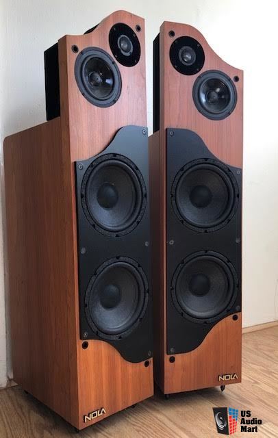

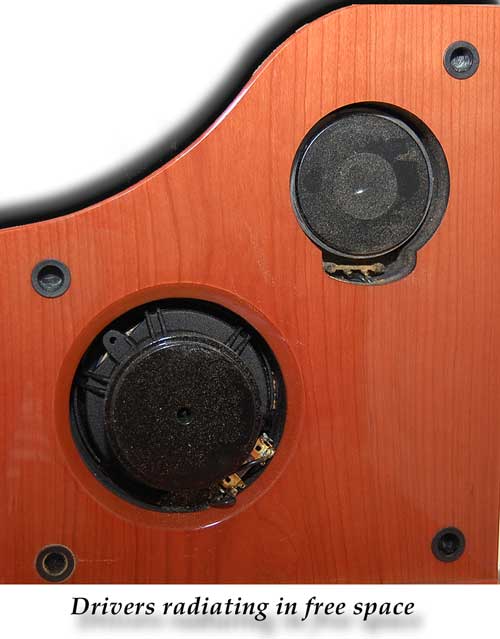

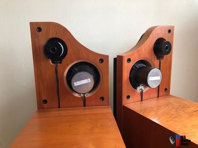

Are NOLA tweeters really dipoles?
Apologies for dropping this question here out of the blue, but are these tweeters actually effective as dipoles?
These pics are of the NOLA Viper II Plus. I don't know the brand of tweeters.
