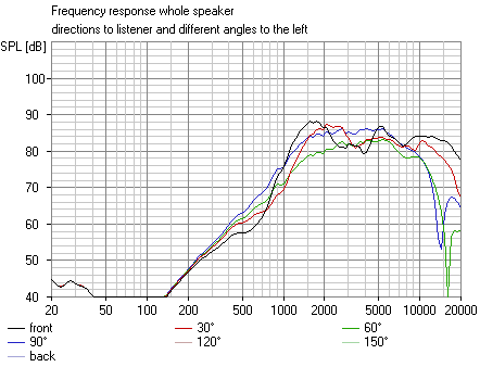

I was actually planning a bipole using the Pluto driver Aurasound NSW2-326-8AT . Mounted back to back as close as possible, to be used from 500Hz and up, with bipole phasing to resemble an omnipole to the extent possible.
Any ideas 😱
Any ideas 😱
No good idea at all 🙁I was actually planning a bipole using the Pluto driver Aurasound NSW2-326-8AT . Mounted back to back as close as possible, to be used from 500Hz and up, with bipole phasing to resemble an omnipole to the extent possible.

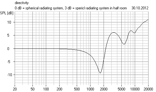

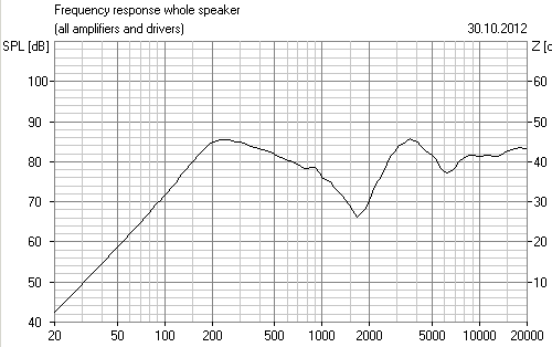

I simulated the situation with two Visaton BF45, which appear to have somewhat similar dimensions, in Boxsim:
I mounted both drivers at just 6 cm distance, which wouldn't even let room for the rear exits of the Auras to breath. You can see how the on-axis response almost immediately becomes a mess. The off-axis response isn't any better:
The directivity index finally proves that this configuration isn't worth any further thought 😡 :
Thanks for the sims on Boxsim Rudolf.
The bipole dip is clearly evident in the sims. However for a 6cm distance between the drivers I was expecting the half wavelength bipole dip when the 2 waves meet out of phase at about 2800Hz. Anyway the polar response disarray is nasty. Was not expecting this for a bipole. Guess I have to follow the advice of making the cabinet wider than deeper, to allow the baffle step fill in the bipole dip 😕
The distance between the drivers has to be calculated from the ears (where it counts).To the nominal 6 cm distance between the drivers you have to add the distance from the rear driver rim to its center, which is another 2+ cm.However for a 6cm distance between the drivers I was expecting the half wavelength bipole dip when the 2 waves meet out of phase at about 2800Hz.
If interested, you might try to mount the drivers one below the other. This could reduce the effective driver distance, but would certainly lead to other problems.

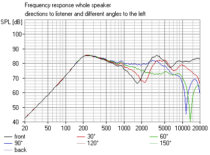

could you sim two slim tweeters (like scan-speak 710003 with the 6 magnets) in a round baffle about 20cm diameter and 10cm thick (to enclose the motors and some stuffing)? ah, connected in series.
I'm not sure if this worth my time, but since you are curious 🙄:Hi Rudolf,
I simulated the Visaton SC10 which should be equal enough in its geometry. Boxsim doesn't do circular baffles, so I made it 18x18 cm square. Depth is 10 cm, drivers in series.
I add the boxsim file for this simulation as .zip. Note that it is not zipped. Just download it and change ".zip" to ".bpj" and you can open it in boxsim.

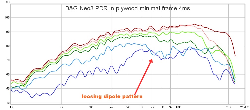

I worked my way through the entire thread today, skipping some parts. The measurements on back-to-back domes shown in the first few pages look quite good, yet the overall opinion seems to still be that a true dipole tweeter is better. Rudolf, why is that? Do you still use back-to-back domes?
My educated guess is that simply because the difference in spatial location of radiating membrane of back-to-back tweeters. Dipole cancellation at high frequencies comes very sensitive to that (short wavelength). Even with a nude planar Neo3PDR dipole null comes at around 6kHz. Delaying doesn't change pysical time alignment of BB, it just shifts the comfort zone!

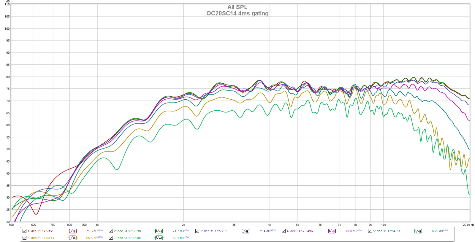

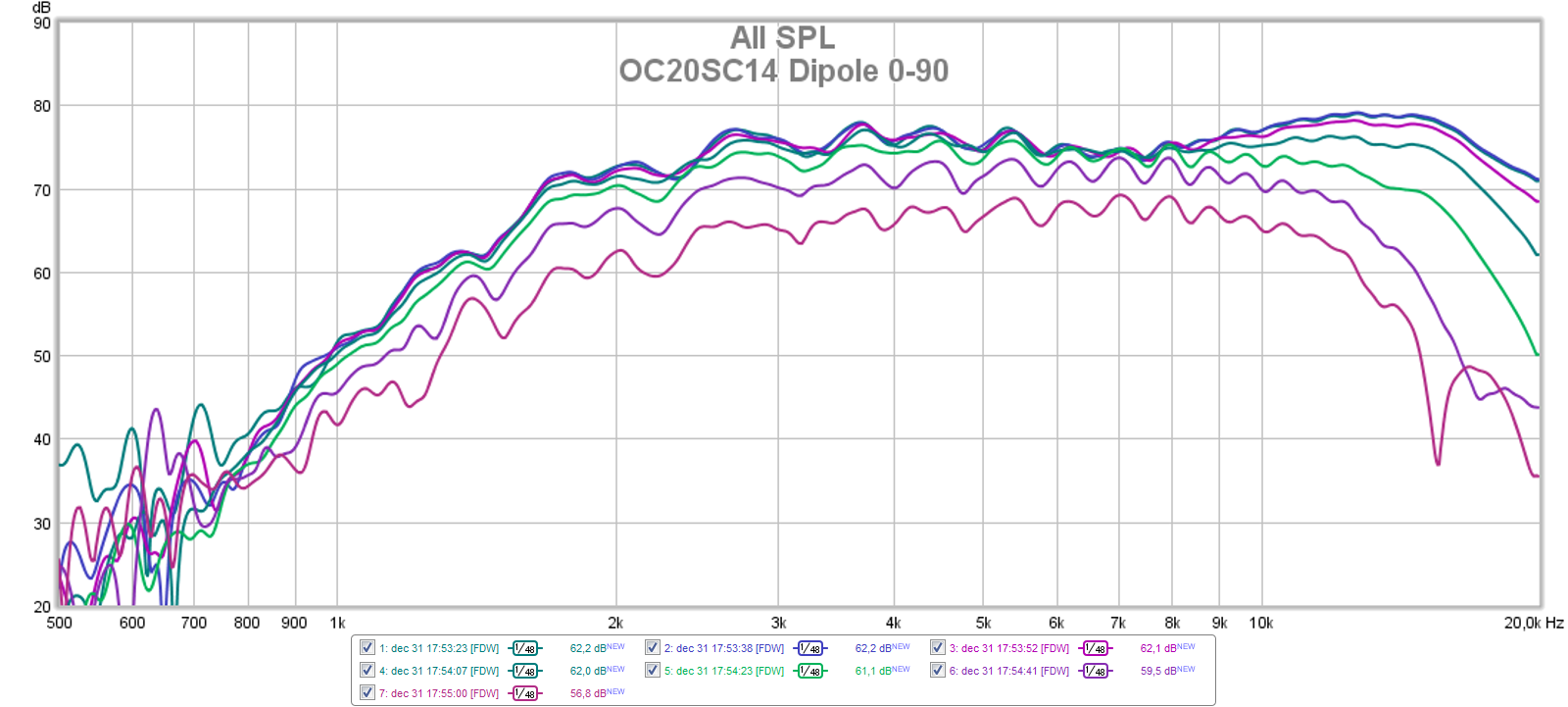

OllBoll, looks like you have quite long IR gating and too many reflections. What was distance? We should be able to see more spl change there and lower spl at 60-90deg.
4ms gating no smoothing should be fine, but first check the impulse response to see first reflection.
But anyway, it seems to work well! how about 90-180 deg?
Oh yes and was there any xo or eq applied, to make on-axis response smooth?
Sweep start frequency can be around 1kHz to prevent damage, eg. . This little baby's resonance it t 1,6kHz, so be careful!

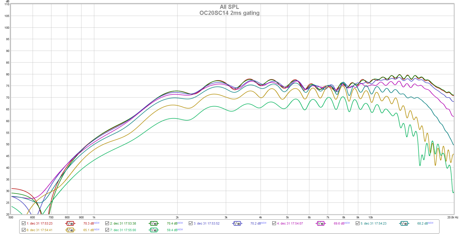

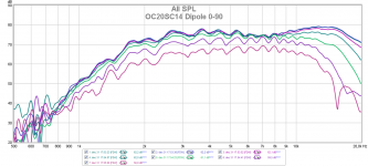

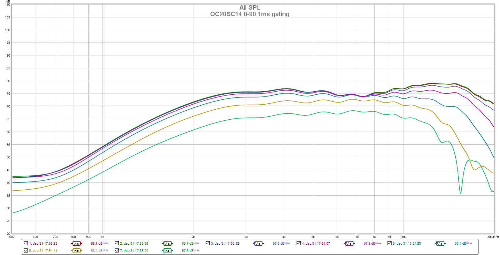

You are right that I probably had a bit too long gating so here is the same measurements with some shorter gatings:
But yeah you are right that the 60-90 should probably be lower, I might not have had the angles perfectly and with the mic distance of ~ 50 cm and measuring in a room that will probably also hide some of the null.
And on 90-180. This is two of the tweeters glued back to back so 90-180 is same as 0-90.
