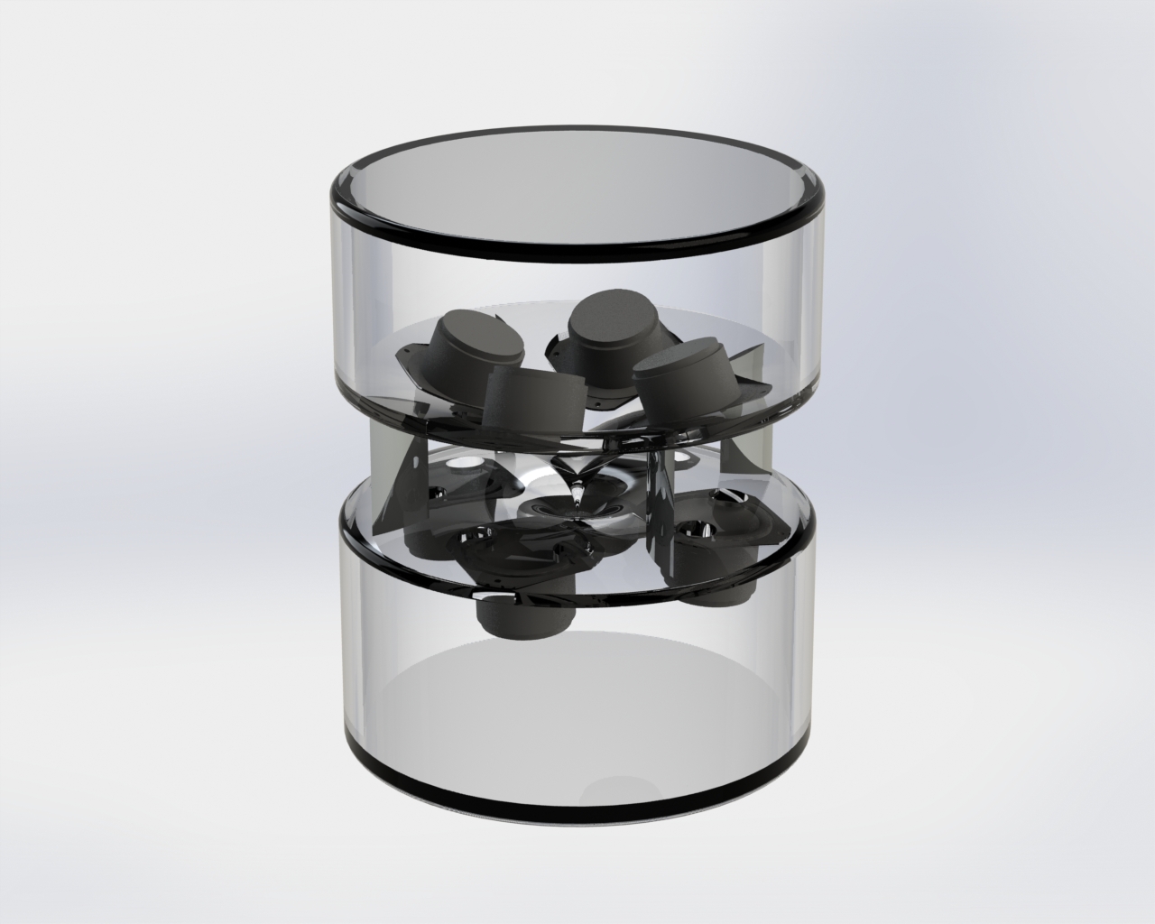

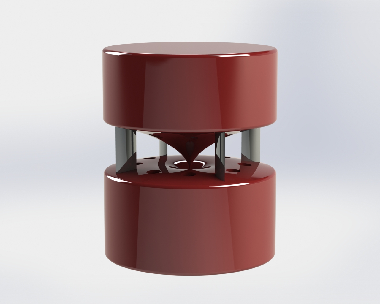

omnnidirectional synergy horn?
... you can design and build 8 mini-synergy horns each with 90-degree horizontal coverage, and combine 4 of them as one channel. You can even combine the 4 mini-synergy horns into one unitary structure, and 3D-print that structure.
Yes, that might work. I would like to avoid buying eight tweeters and however many mids and woofers, though. Part of the fun (for me anyway) of doing all this is the challenge of making it work within my constraints.
Thanks again for your input; it's really helpful to get feedback, even if I don't follow every recommendation.
(possibly an ignorant assumption?)
Dunning-Kruger is always an option. 🙂
After thinking for a while about what you want to achieve, it occurred to me that the real synergy horns are designed to do exactly that. If you put the synergy horns in a ring, you'll get 360 degree (i.e., omnidirectional) sound with also well-controlled angular distribution in the vertical direction.
This is an excellent point, but the combined speaker would be massively larger than the OP's idea. Isn't that the fundamental compromise with all horns?

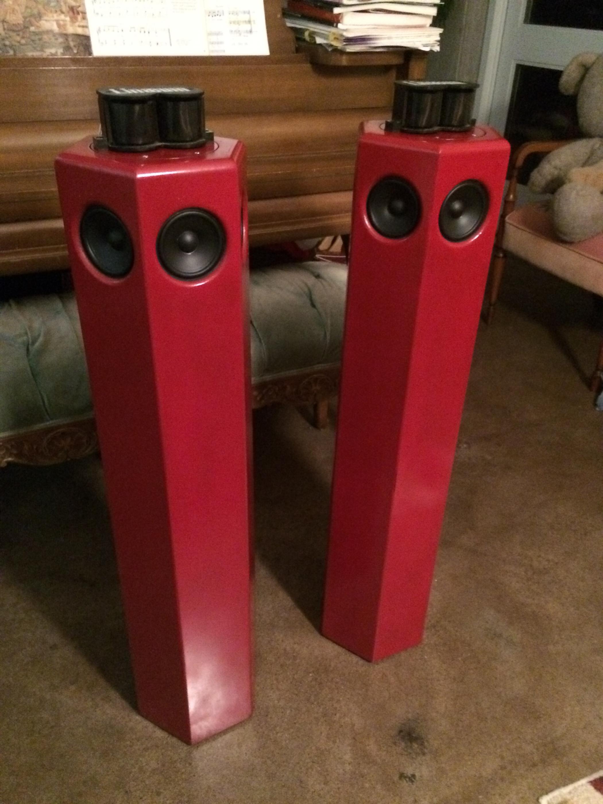

@KCHANG - Thanks for your reply. The dipole-ness of the tweeters on my earlier speakers is what made me call them ‘half-assed’, i.e. not fully omnidirectional. Still, from 4kHz down they do a pretty good job of sending out 360 degrees of sound. I’ve heard dipoles, and this is not the same. I wish more people could get a chance to hear an omni speaker.
One thing to consider is the potential difference in path length between the inner and outer walls of your radial horn. If they are not equal length the wavefront will exit at an angle. You can adjust path lengths by having different diameters between top and bottom edges of the horn exit.
Omni's are definitely a different listening experience. As noted earlier you need enough room to get them away from the wall (> 1m).
I went through 5 revisions to get mine to a state I was happy with OmniDirectional - work in progress and they are still prototypes. There are lots of design issues in that thread that might help you.
1) Yes, only around 15 degrees of dispersion. High frequencies behave pretty much like beams of light, you can trace the reflective rays from the source to visualize the pattern.
2)A 360 x 30 degree horn is not omnidirectional, but if that's what you'd like :^)
I think it probably is what I want; but I also have this detour in progress.

Sectional view and hresp sim for woofer:
460444d1421767837-omnnidirectional-synergy-horn-omnysynsect1-jpg
Here's your pic
Here's how I'd do it. It's actually simpler than a conventional Unity horn, because you don't need four woofers. You only need one, face down, firing into a slot. Tweeter faces UP, similar to the Beolab lens.
And like the Beolab lens, you could get any angle you feel like, anything from zero degrees to 360 degrees.
