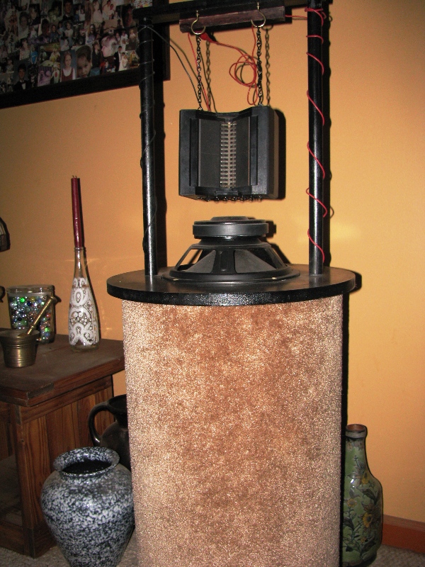

This looks awesome and "correct" :cool: some questions:...
- is that 10" or 8" woofer?
- How did you bend the metal poles ? :)
As for finding out pipe resonance, normally I just lift the speakers a bit and poke the microphone. I'ts very revealing.
It's a 10". Same Peerless unit as the Pluto sub. Poles were bent in a special way :cool:. Meaning I had a shop do it.
Poke the mic? What's that?
No tweeter?
Fullrange? pointing at ceiling.
Treble is more directional from a fullrange than from the small radiating area of the diaphragm of a tweeter, if you did not add a forward radiating tweeter or flooder device what would you expect?
the treble would be more open and airy with more direct treble.
Very large, hardly a point source.
No wonder a dipole worked better.
The fullranger was a Ciare HX201 with massive treble rise, so that direct sound plus treble reflection gave a fairly good frequency response.
I hate dipole airiness, so I prefered it in a closed or almost closed setup.

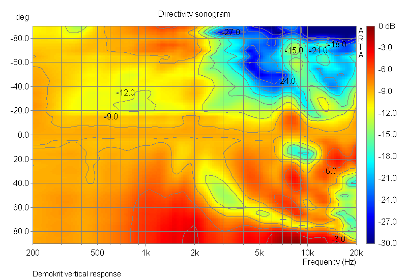

The graph is highly misleading because just a single measurement was used to generate the sonogram. You can use any single measurement to generate such a graph. It even doesn't need to be flat if normalization is used.
For such a concept it would be more interesting to see a vertical sonogram. Unsmoothed, free field, mic at about 2m distance and not at 1m.
c) With such a small driver the mic is in the far field at 1m distance
a) I verified that the response did not change horizontally. So it does not matter if I use 1, 2, 3 or much more measurements. The time that was saved to take snap shots every 5° or 10° or whatever degrees is spent well elsewhere.
b) agreed on normalization. That's why I also show other diagrams and mention that it is normalized.
Compare the vertical measurements. There I went the full 9 yards because the response does change.
Yes? There's a diffraction device involved. Did you confirm with measurements?
How did you verify if not by measurements??
Could you also posts a sonogram with vertical data?
Yes, if I remember correctly I went up to 1.7m.
I did measure it ! I probed one side with one of the little poles. Then I compared the graphs by substracting them from each other. The result was a flat line. Only the calculation/the picture is based on one measurement because it would have made no difference.
I have no reason to cheat here. I am not afraid of the work. One intention of the horizontal sonogram was and is to show that nice pictures cannot describe how a speaker really sounds regardless of how perfect they are.
If you can read that better than the polar plots I can do that (next week).
Thanks for the additional information.
Well, one can read that graph one way or the other. I obviously chose the wrong one :)
Would be nice.
