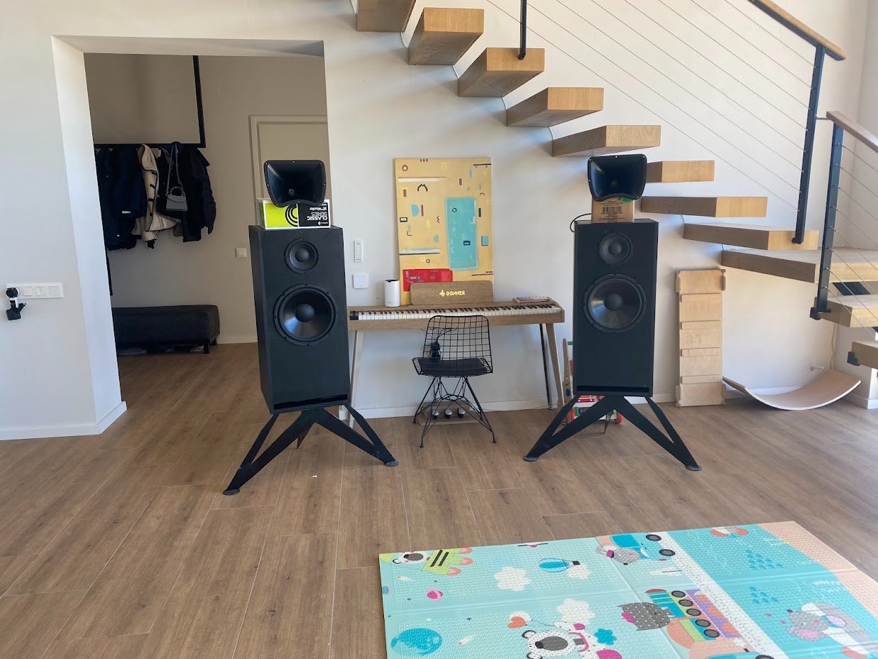

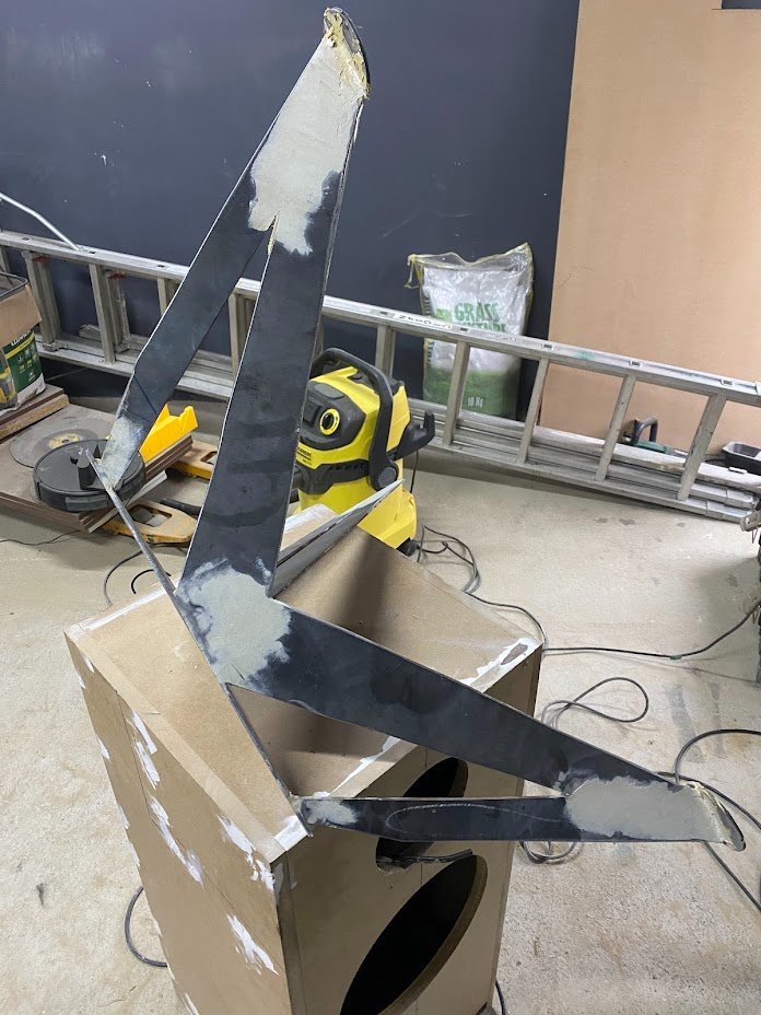

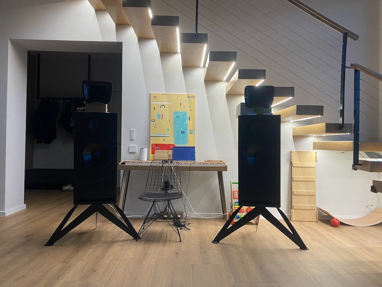

Hello Forum,
Just a quick update on my speaker build—I’ve finally started working on it and wanted to share my progress with you.
🔧 Driver Selection:
Woofer: Dayton Audio DC300-8 (12", 8Ω)
Midrange: Dayton Audio MB620-8 (6", 8Ω)
Tweeter: Eminence ASD1001B compression driver with B-52 PHRN-N01 waveguide (8Ω)

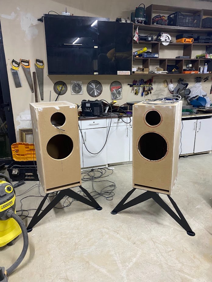

📏 Enclosure Details:
I designed the box using WinISD. Here are the specs:
External Dimensions: 89 cm (H) × 40 cm (W) × 40 cm (D)
Net Internal Volume: 92.45 L (3.26 cu. ft.)
Slot Port:
Height: 3 cm
Width: 36.5 cm
Depth: 34 cm
Port Area: 263 cm²
Tuning Frequency: ~30 Hz

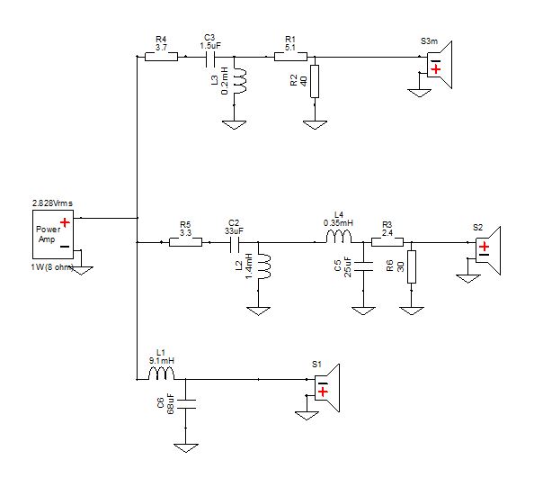

🎛️ Crossover:
I’ve measured the drivers independently and calculated crossover schematic that I followed, but I'm unsure how accurate or well-matched it is.

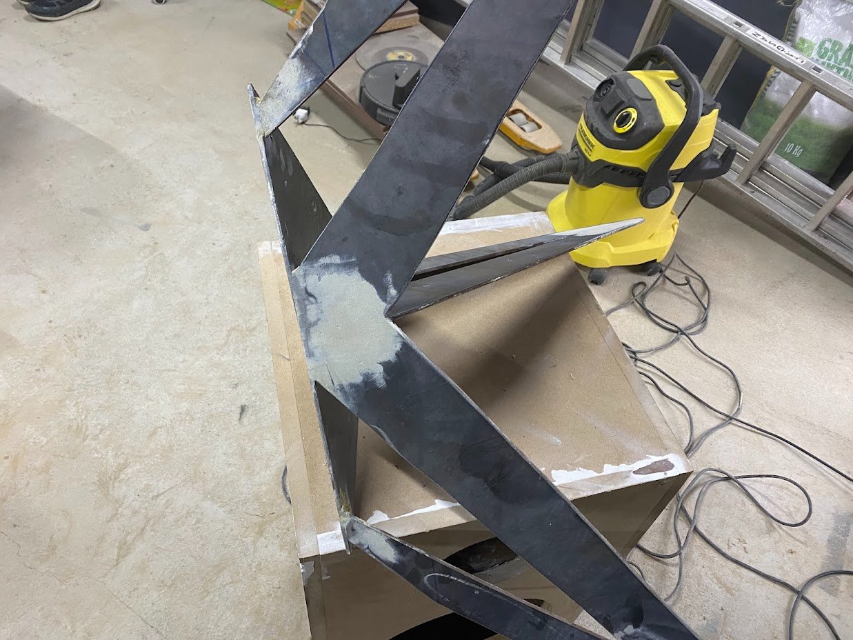

also, this are the pics from my build:

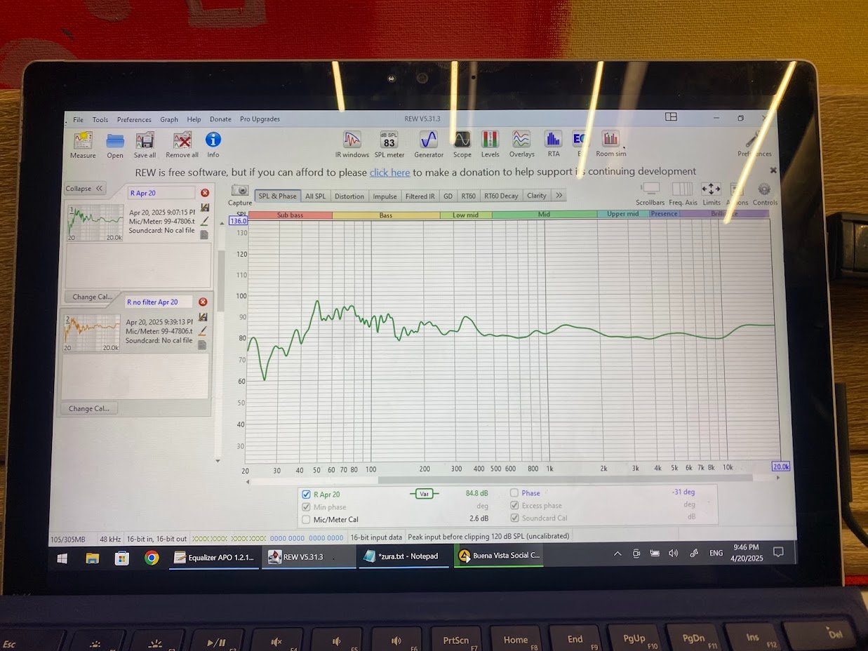

this is measurement using Denon AVR Measurement microphone ( i know it is not suitable but i have destroyed my dayton audio measurement microphone while testing so i had no choice)
this is REW data :
i want to point out that my room is not near perfect it is 8 meters wide and 8 meters long with ceiling at 7 meters high so i get no Bass i was looking for i want bass down to 30 herz please help how to achieve it /. i have asked ChatGPT and it suggested to widen port to 6.5 cm to get this bass but i think my room is issue so i will bring speakers to different room and test after 1 week
If you have any feedback or suggestions on the crossover design or box tuning, I’d love to hear your thoughts!
