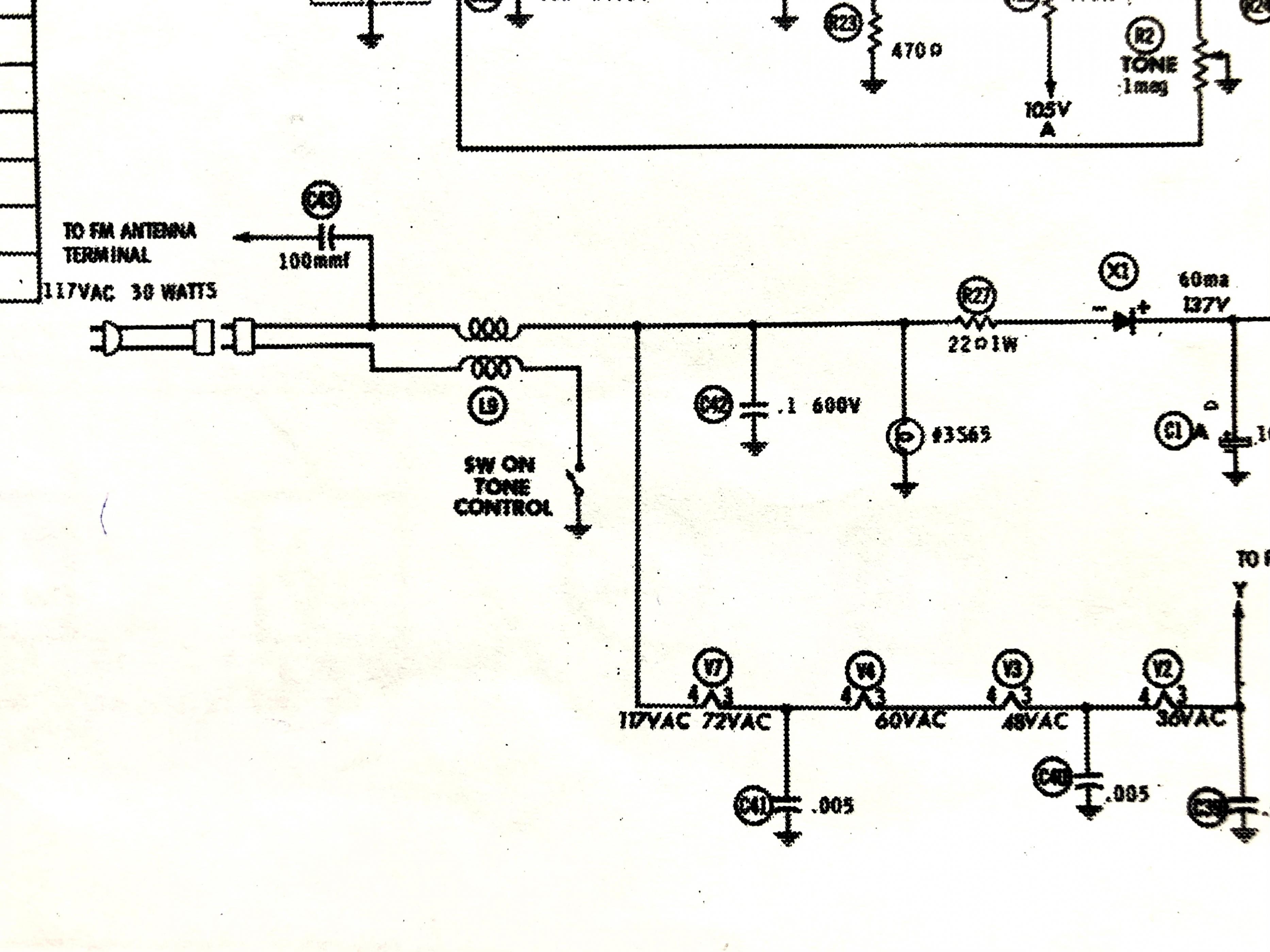

Operationally I know the two conductor power cord doesn’t care about polarity, but looking at the schematic attached, isn’t one way better than the other?
Currently the load lead is going to the “SW On Tone Control” the on/off switch. I did that assuming I didn’t want the chassis “live”.
Is this best? Or is there a better, safer way to wire this input circuit? By the way I have an inrush current limiter inserted into the load lead ahead of the small coil.
I must admit I have trouble envisioning the power flow in this radio given that the neutral line is grounded at my mains breaker panel and the switch when on is sending the load line to the chassis.
Thanks for any clarification offered.

Radio's without mains transformer are usually designed such that you can't come into contact with the chassis during normal use, so then it shouldn't matter which side is live - assuming the insulation is good enough to be trusted (so no plastic knobs or screws replaced by metal ones by previous owners, among other things).
However, if the capacitors that insulate the inputs are antique paper capacitors, you can be almost certain they don't insulate properly anymore. You would have to replace them with something safer, preferably modern Y capacitors.
Regarding your question, I really don't know. If C43 should fail, it is safest if it is connected to the neutral rather than the live side. If you don't trust the insulation between the chassis and the user, then the radio is quite dangerous anyway, but it would be slightly less dangerous with the switch connected between the live wire and C42 and the neutral always connected to the chassis.

How much room is left in the cabinet? You may be able to find a spot to bolt in a 1:1 torroid. I have several hot chassis radios, but I know all my outlets are wired correctly. You can put on a polarized plug neutral on chassis but make sure you only use the radio with an outlet you verified is wired correctly.
Wow! Thanks for all the prompt feedback.
I check all my outlets and they are wired correctly. I have already replaced most of the ceramic caps with safety caps, but not C43. There is room for a toroid but despite not really having any collector value, there is a lot of sentimental value as it was a gift from a friend who is no longer with us.
I now see the wisdom of swapping the load to the switch and sending the neutral to the chassis. That is exactly the kind of advice I was looking for. Unfortunately, if I am to remain original, polarized cord on the radio end is out as the old brown pressboard backing (keeping the chassis safely at bay) has an integral unpolarized two conductor captive connector. But if I polarize the plug and mark and install the captive connector onto the back properly, I should be good to go. The rest of the wood box and phenolic insulators are in good shape and once tuned up there will not be a need to expose the chassis again. I do have an IT for my bench which is where I listen to this radio so I could use it if I have to.

Yes, the power switch in "AC/DC" transformerless radios is normally in the to-chassis wire.
This is an artifact of older radios having a 3-wire cord, the third wire a resistance element to waste-off excess 110V to a heater string (before the 35 and 50 V types were developed).
If you think in *complete circuits* there is no contradiction, the radio will work.
This is for RADIO, where only radio waves come in and only sound waves go out, NO human-touchable metal. You can't use it for a hi-fi or guitar amp without further safety measures.
