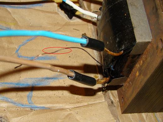

Also taking the casing apart found another small very fine wire coming from the second output on the first side. Strange. maybe the 5v and 6v windings have CT.

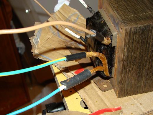

See the pics, I found these fine wires between the 6 and 5 v secondaries.
Can I just tape these up and leave them?

Are they connected to any of the windings? Check with ohm meter. If not connected to windings they may be ground for interwinding shield. Was the end of the fine wire traped under the end bell/cover? That would be an indication that they are interwinding shield ground.
One of them was under the end bell/cover. The other no, it had an old perished cable cover but only at the beginning.
I did get a reading on the one with the old cover so I assume this is the CT.
So if the other has no reading it's the internal shielding ground and this must be pressed between the bell cover once replaced.
