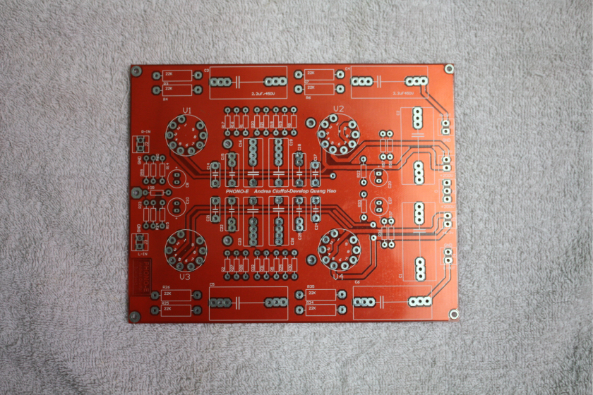

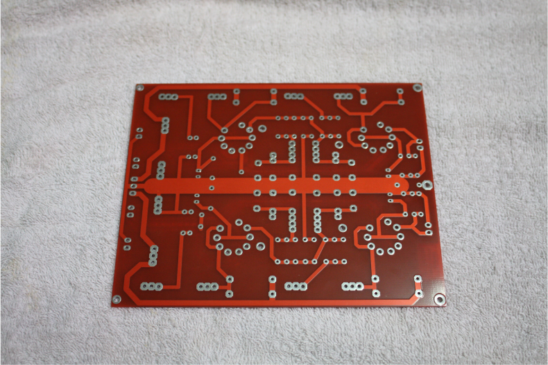

Ciao Gulglielmo, I'm from Cividale but I live in Sydney. What a surprise!
The 300B is really good.

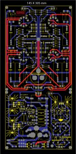

I finis PCB test. I will test pcb and Phono next day. you can se the PCb please!
thank
thank

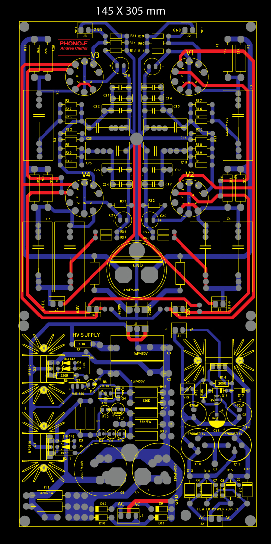

Guglielmo,
The original version of this phono preampl. use low impedance RIAA but the experience done on Phono End is positive.
Hi-end phono preamplifier
In the Phono End I have got a better sound and no noise using medium impedance RIAA.
In general the low impedance RIAA should have some advantages in terms of noise but in this case we are obliged to use like interstage and RIAA network large value MKP capacitors.
If we increase the impedance of RIAA we can use many kind of products like the best silver mica and Jensen copper film paper in oil.
The pcb can be used for both types of RIAA.

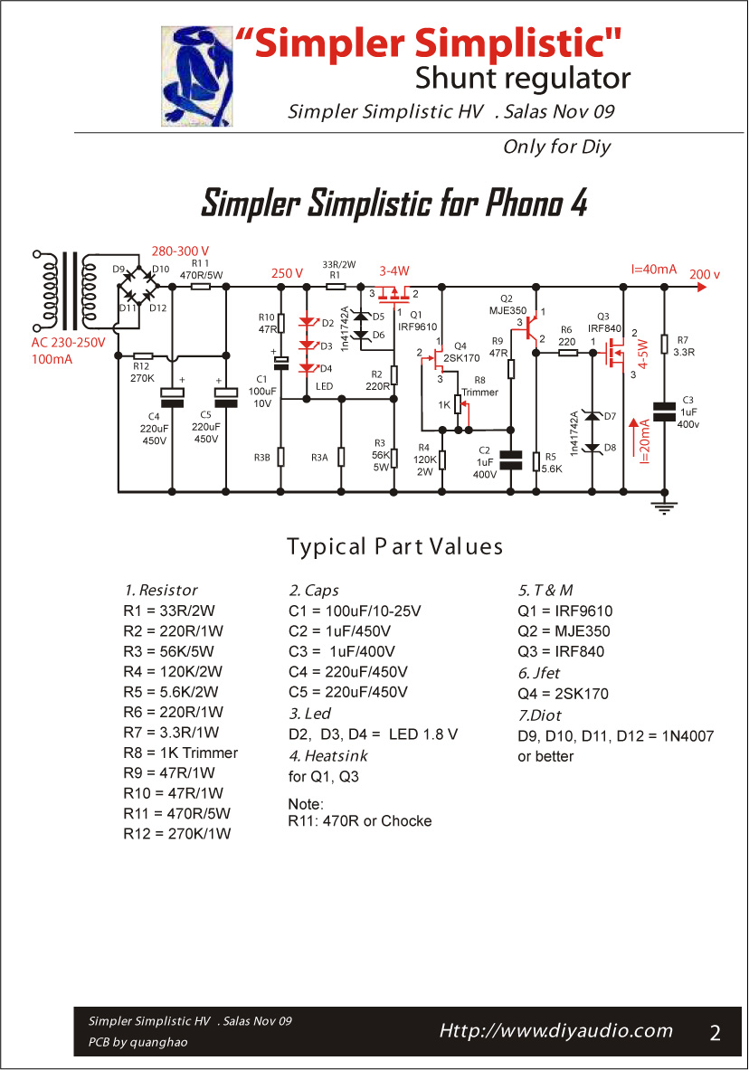

hi all! Now Im testing Phono with Salas shunt! It is good,
may be two week later i will make pcb, and have the Price!
Do you have then Salas schematic of that?
Salas shunt??
here is it!

Salas shunt??
here is it!

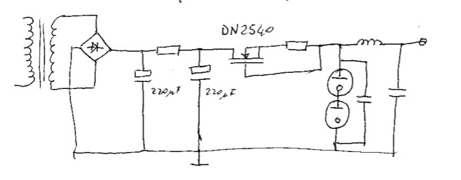

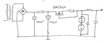

Salas is very smart design, but IMO thanks to Depletion mode mosfet it can be simplified. If you don't have Depletion mode mosfet available you may stick to Salas but IMO 13 components around Q1 can be replaced by only 2: one DN2540 and one resistor.
I can see a point of failure in the design: Q4. If Q3 fails to shunt then Q4 boom!
Below is a simplified version of similar concept of Salas function PSU with 1/3 of components and no low voltage floating devices
