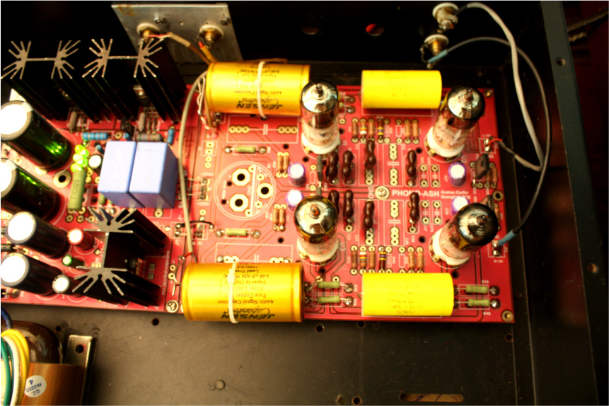

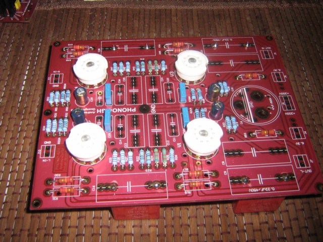

After I finished 4 phono, my favorite is the sound of it, so Andrea has recalculated the values in the circuit. I was very interested in these calculations. Motherboard I do for you called a phono ASH.
Today, I use 50 ohm resistors cadoc for cathode tube D3A , and 0.68 UF capacitor output Jensen. Sounds great.
I had a chance to compare with the EAR 834 phono
Phono D3A (ASH) te sound is better 834,
and I like D3A phono in the following points:
The sound, balanced, very high resolution, Nature
No noise,
Probably due to light interference is very small electronic D3A
SO it is very good Phono.

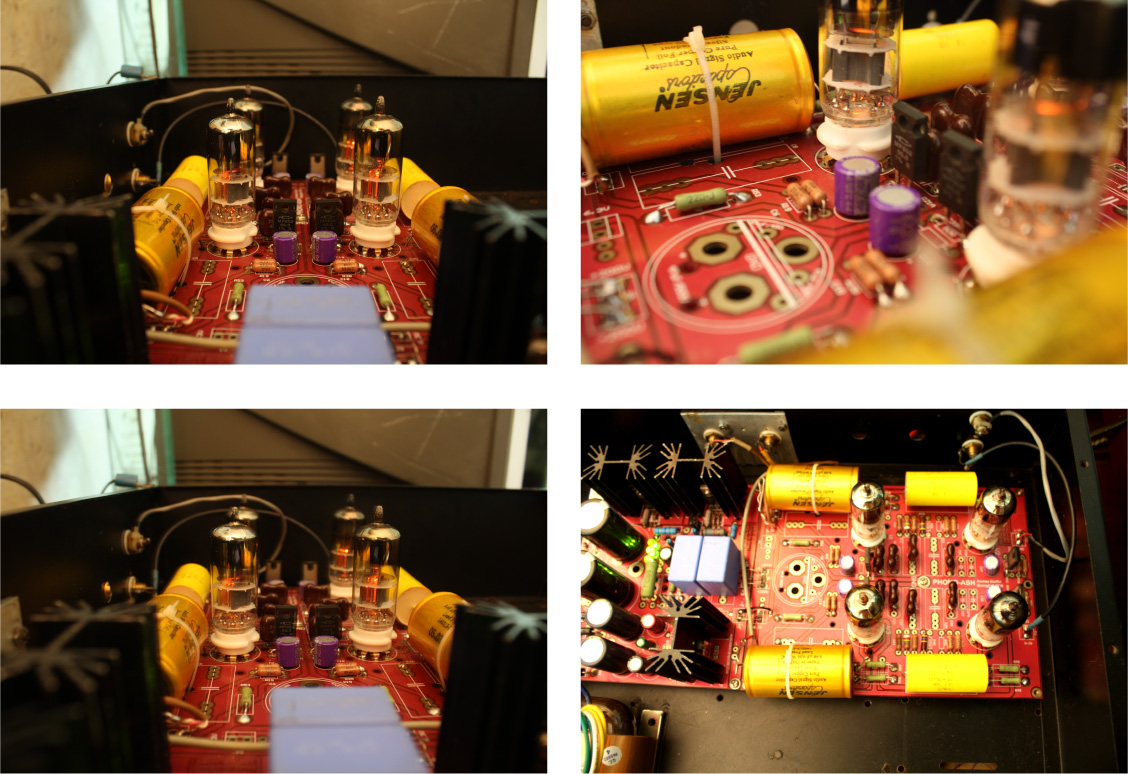

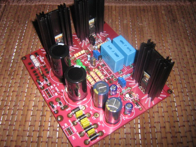

All i still need before the power supply test is my 120k 2W resistor.
I also need better screws for the heat sinks and i need to put in isolating washers so that the heat sinks are not live.
After the power supply is tested i will connect it to the phono part and test. YAY!! 🙂
I decided to mount my large capacitors underneath so when i design my enclosure i can easily make my tubes protrude at the top for a classic look. On too Autocad!!

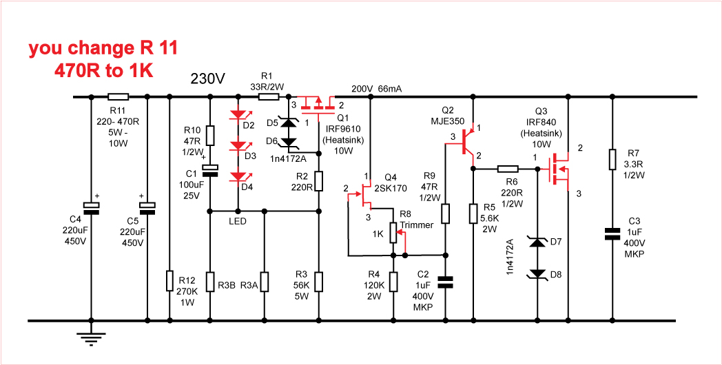

Hi quanghao
How hot does your irf9610 heatsink get?
The heatsink you prescribed is 8c/w
The heatsink I used is 6.8c/w
When I power it up I set the voltages correctly but the heat sink gets VERY hot i can't Touch it with my finger too long. Is this normal?

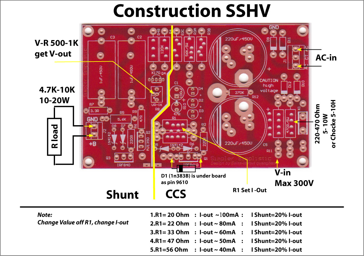

Hi! how voltage between R1?? R1 = 33 ohm??
I'm sure V across 9610 is very big??
About max 30V .now you can change R11, is bigger 200R to 470R or 1K, and 10W.
It is mean:
voltage across R1 = 2.3V
AC voltage is 238V
DC voltage 285v Dc this is measured across C5
R11 is currently 220R
I think i will make R11 1K an see what happens.
all my measurements are with no load connected and only power supply plugged in.
Thanks!!

With power supply connected to phono board
R1 = 220R 5W = 80C
9610 is 67C
840 is 60C
irf 9610 too hot
R1 = 1K 10W = 125C
9610 is 37C
840 is 42C
Resistor too hot.
Going to try 500R 20W resistor
In hindsight I should have gotten a 190Vac or 200Vac Transformer and NOT a 230V ac transformer.
