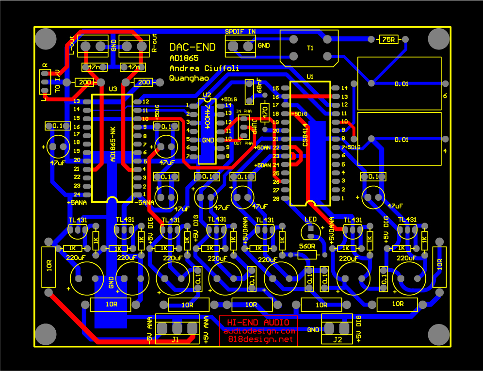

Hi all !
Thank you interested this DAC, This layout of DAC-end and Supply. You can see! now, I finis all layout, I waiting Andrea Ciuffoli check a gain!
So We wil start Now.

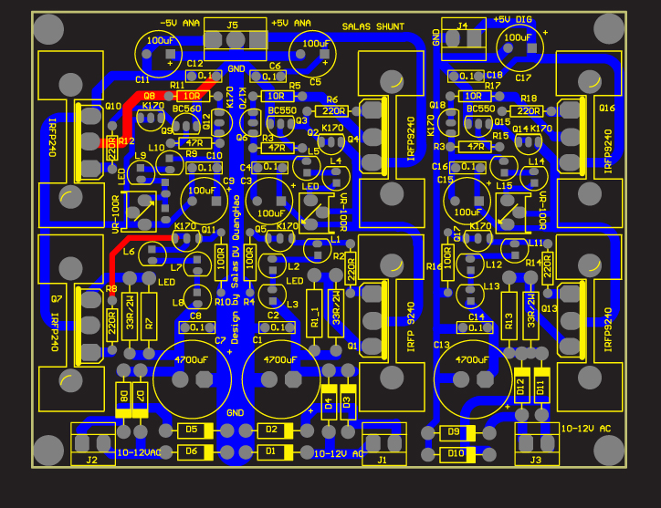

2. PCB- Salas Shunt For DAC

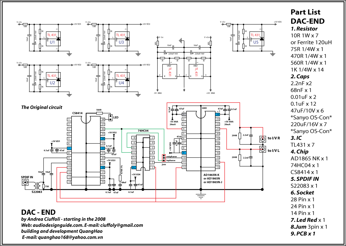

In any vacuum tube stage the signal on the anode is in outphase with the grid signal.
If in this dac we want use a single output tube and there is no output transformer we will have an outphase output signal.
To get an inphase signal output I have modified the schematic and pcb with Quanghao to insert a digital phase inverter.
This digital phase inverter has been created using a section of the 74HC04 on the data signal.
A little jump will allow to decide the output phase.

I saw DAC END Board at your post number 162 is different with posting number 170.
Which is the Final DAC End Board ? (No 162 or 170?)

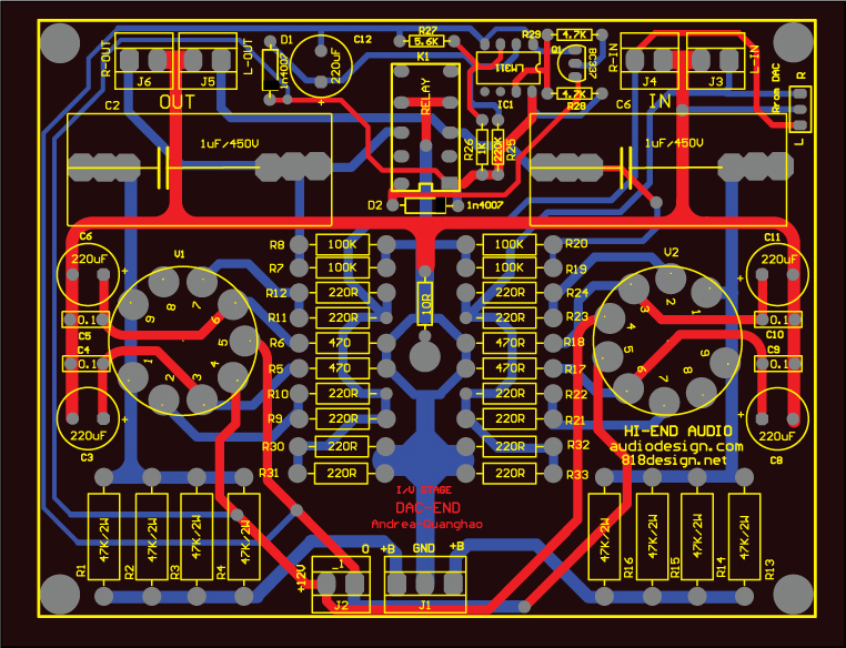

AND
IV STAGE Board at your posting number 147/148 is also different with posting number 172

yes sir! Last i post I use tube SRPP out put! Now We dont use SRPP, use paralle tube out put or tranformer out put on one PCB!
You can se

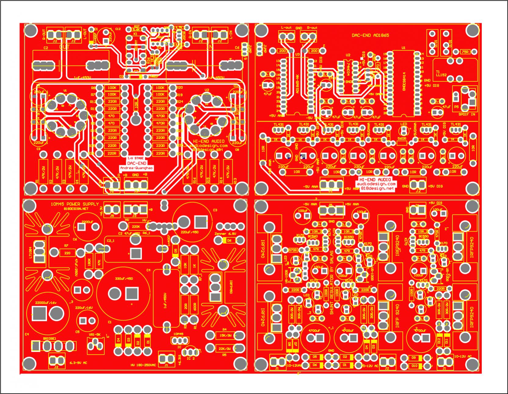

We start make PCB of DAC-end and Salas shunt for DAC
Hi everyone. Current everything I was ready to submit designs for manufacturers to make circuits.
So you have registered, please let me transfer the funds to my order soon.
Time to receive funding to start from today to 15-1-2010 (period of one week). When I receiving funding will be made immediately,
on the 16-1 production was finished 23-1-2010 (lost a week).
Then I will send the first day for all of you!
Thank you and please transfer money to my account
