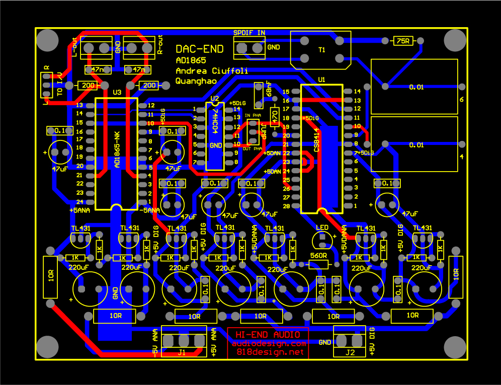

Cricuit and layout of DAC-end ! I finis layout , you se it please!
Some questions about DAC End PCB. CS8414 PIN 18 (Serial Port Mode Selector) have separate power supply TL431. Why ?
PIN 22 (Positive Analog Power) supply from +5 Digital power source - Connector J2. It is correct ?
It is not necessary a separate power supply for this pin, VD2 could be connected with VD3 but Quang Hao have decided to separate it, I don't see problems
Yes this pin must be at +5v, what you mean ?
If you have two separate 5VDC PSU, named +5V DIG and +5V ANA, why not use Digital PSU on Digital section and Analog PSU on Analog section. And also about use of separate grounding but it is a other topic.
About separate power supply for 18 PIN. I don't see problems me too, but I don't see objective.
that is good! i think i can check and, change it!
Thank!

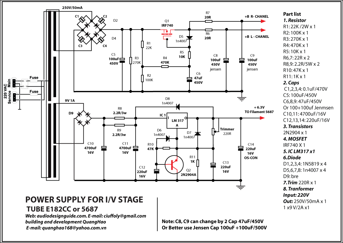

Hi Quanghao & Audiodesign,
That supply applies to 240Vac, how about for 120Vac?
