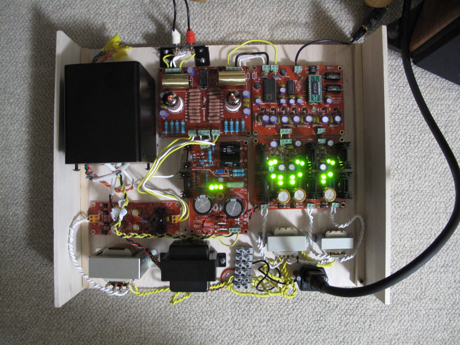

This is a picture of the working prototype.
I used one transformer with two secondaries for +-5V one for +5V.
The black small one is a 5H choke and the black big one is the power transformer for HV. this is temporary.
Still did not understand the right position for the jumper, and how many regulators and filament supply I should use.
HI,
Thanks for the picture 🙂
If you want the signal to be in phase you need to connect a jumper between 2 and 3. If not. Use 1 and 2.
Your prototype seems to be complete to me.
Nice work with the shunt reg for the tube stage!
Best Regards
David
You mean the phase out of the DAC-END circuit or out of the Tube stage ?
The tube stage itself inverts.

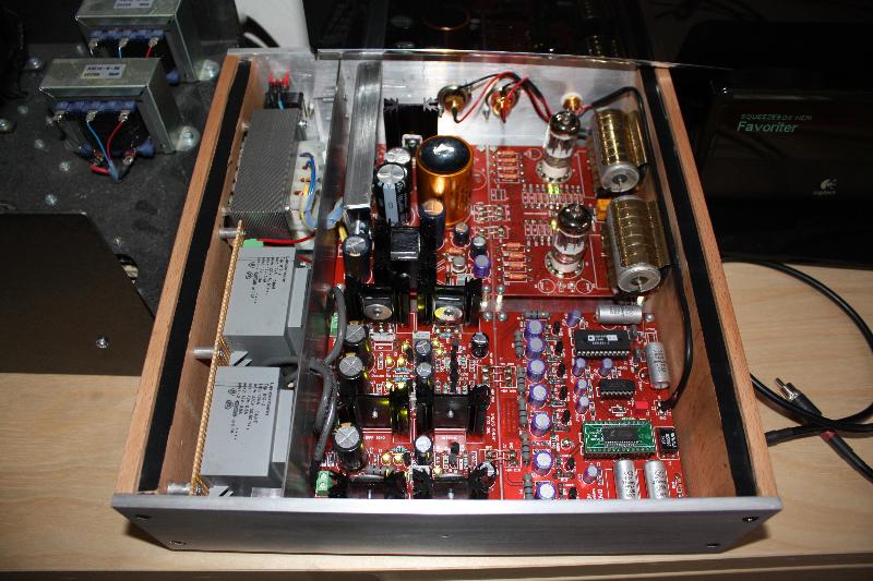

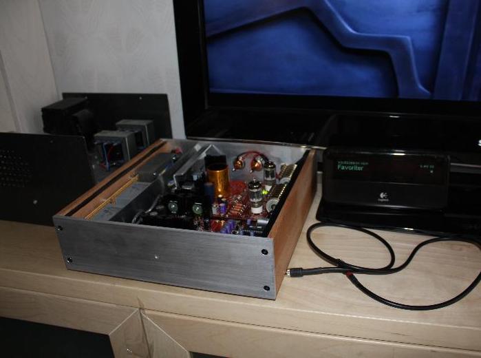

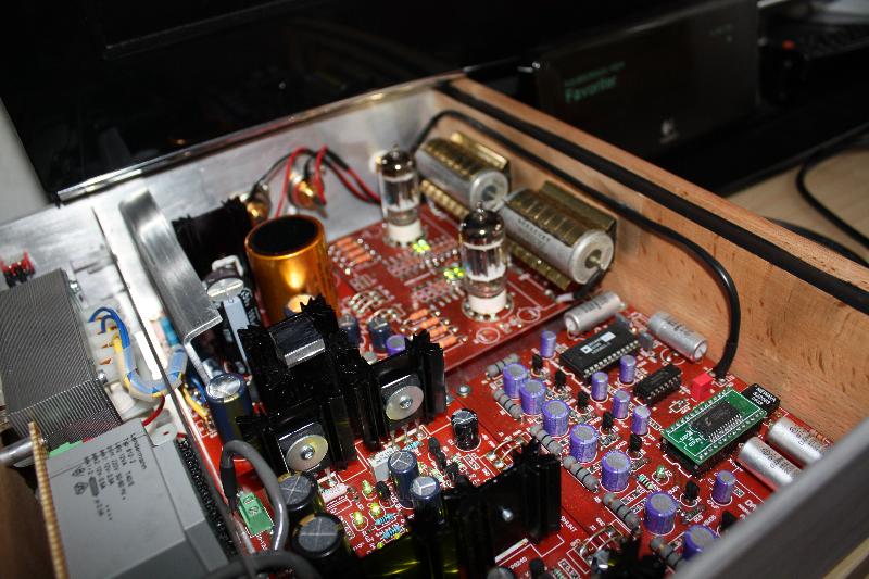

I thought I should post some pictures of my build.
I did as Adamus recomended and removed the inductors and added the "led-mod". I listened to the DAC standard and to me these mods made it suit my ears better.
I tried both E182CC and 5687 and prefer the E182CC. Also use Sprauge Hyrel Q 1µf output caps.
To me this DAC easily beat my old parallell tda1543 dac.
