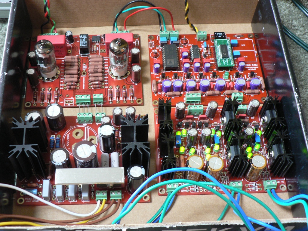

Would this heater power supply for the phono preamp applicable to the DACend? The 2.2ohms resistors and the bridge rectifier are too hot, can't stand it. This might be better that the original one. Please advise.

the 2.2r gets too hot, reduce them to 1ohm or use jumpers. use a big heatsink on the regulator, and a heatsink on the bridge.

hi all,
as I have started to build, questions arise naturally...well, here is the first one, and maybe its already answered in the depths of this thread.
Its about the 33r resistors for the low voltage salas shunt, do they really have this value? I remember vaguely that there was a change, but I could be wrong also. Ernst ordered for these 3 places ( R1,7,13) 22R, but according to Andreas list its two 33 and one 27R, in Quanghao's list its two 33 and one 8-10 ohm..
So what comes in finally?

for the analogue ps sections 33ohm should be fine, although i would use 27r and heatsinks on the fets.
for the 5v dig i settled on 11r. Too high resistance will mean the reg will drop out and you wont be able to adjust the voltage enough to give the tl431 enough headroom (you want to dial in 5.3v at least, 5.6 max, 5.5v optimum)
Best check is to ensure vgs on the second fet is not 0, if it is then no shunt current is flowing and poor regulation.
HV shunt you are on your own until completed builds come out.
Steel is not a fantastic conductor of heat, but you may get away with it. The heater reg gets very hot, and do heatsink the diode bridge. Its the hottest part on the build.

yes you use 8-11R for one Salas shunt for Cs8414 and 74HC04.

Yes you use Ac 250 v for SSHV , and R 1 = 47R for set curent SSHV
Not V in only at 300V, and you can adjust V-out 270V for I/V tube 5687

I did the 'filterectomy' this morning. Removed the inudctors, and the 2k's from the IV stage. I left the caps (10nf so about 80khz ).
It lets the whole sound breath a little more. No harshness is introduced, just a little more air and ambience. I can see why audionote ditched the filter.
My advice is for people to try filterless (it took me 3 mins), and for new builders to consider not having the filter.
I completely agree with this. Also use Adam's LED bias suggestion. Very nice sound !!!!
I have also continued to use Welborne's PS10 for HV. Just keep coming back to it. Tubes are E182CCs. Need to try the 5687. I have some NOS TungSols and Raytheons from the 60s.
My next experiment may be running input directly to the 8414 (no transformer) Some say it lifts a veil.
This DAC is a keeper and will be one I keep in my system

I got the mine playing tonight ! Very impressed by the sound.
Now it is configured with no modifications. I have a second I/V board that I plan to use to try leds and ccs.
