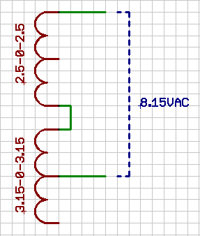

I'm trying to wire up the following R-core to acheive 8.15V..
R80-36 260-230-0-230-260(90mA). 2.5-0-2.5(3A).(3.15-0-3.15)X2(3A)
I read further back in the thread that I needed to use 2.5 + 2.5+ (3.15) parelled, I dont really want to guess what this means and would rather ask the best way to wire it up.. As If I were to guess I'd connect the 2.5 and 2.5 and join the 3.15 wires together, which is most likely wrong?
Can anyone advise me how to wire up this R-Core for the I/V Stage?
Hi
I'm no expert, but would have thought the following.
