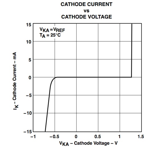

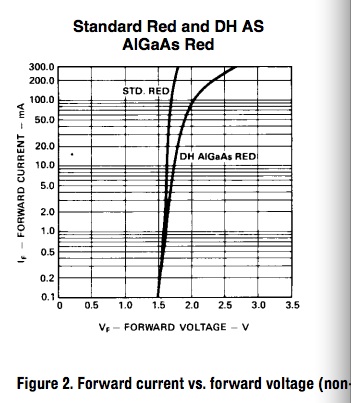

Hi Adamus,
I'm back on this DAC for a little while as I'm working on a new SE amplifier.

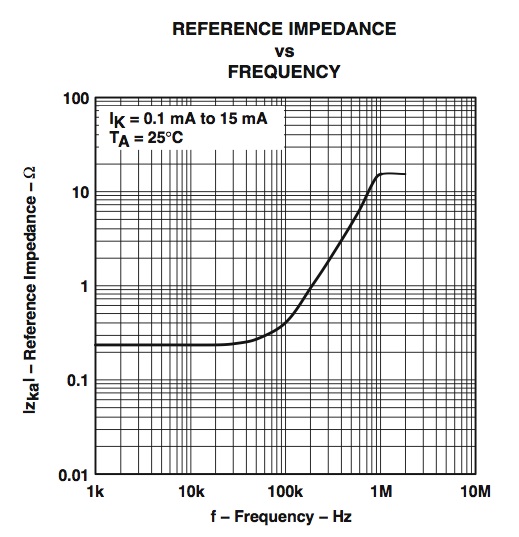

As I said before I like your idea of replacing the cap with LED on I/V stage, but the LED IMO is not very linear. So I believe following you track try to use TLV431 instead of the LED... then let me know....
It's linear from DC to 50KHz !!
it is.... but whats the dynamic resistance?
~0.25 Ohms flat to 40KHz (according to the chart). Total dynamic impedance depends on external resistors. Am I right?
What about the LED dynamic impedance?
I guess so, which would lead us back to having to bypass with a electrolytic cap. thats the beauty of the LED's, no bypassing.
Sorry I don't get it. Look at the first and second chart. Which one shows more dynamic impedance? LED looks more banana to me. Also I don't know what happens to the LED between DC and 50KHz.
its so easy to try the mod, just go for it. 5 mins tops.
I have no idea how the tlv431 would behave in series (you would need to to get to 3.8v) and cant see that anyone has ever tried them. they could well work

Use TL431 as you LED. It''s like your LED but with three legs where you adjust the voltage. There is no TL431 tuned at 3.8V so it's just matter of adjust it.
It's the same but with better performance I believe. If nobody tried this it doesn't mean it's impossible. Just follow the rule.
I will try it soon on this DAC.
What resistor values will you use to program?
