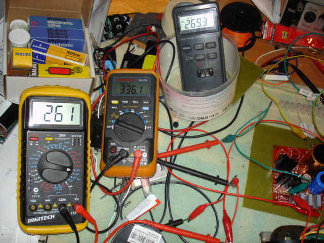

H/V Test with 30ma load
H/V fine.
From left AC input, V(R3), V(C9)(C8).
AC Input 261V
V(R3)=336VDC
V(C9)(C8)=269.3VDC
Load current=30mA
R1=22K, R2=100K
67V headroom for the regulator.
Run up time ~60min
Heatsink on IRF840 7.5C/W
IRF840 Temperature=46C
Room Temperature=27C
H/V fine.

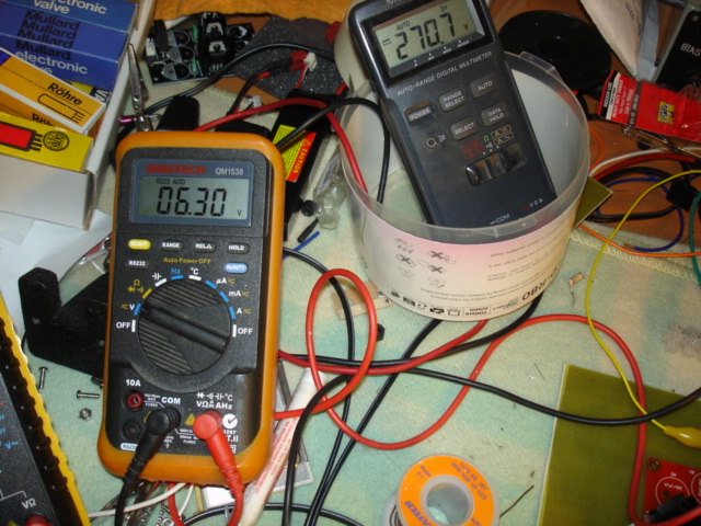

I can find 200R trimmer for the heater section. It seems that 220R is not popular.
With 200R trimmer and 9VAC input measured, output voltage cannot be adjusted below 7VDC then the heater bye bye.
I replaced R11 with 560R and you can obtain 6.3V near centre trimmer.
Heater DC output loaded with 1.38A
AC input 9.4V measured
Output 6.3VDC
Temperatures:
LM338 61C
R8 and R9 140C (mounted as Goalpost)
Bridge rectifier 80C
Transformer 33C
Picture shows PSU fully loaded.

hot! they are droping about 1.5v (ish) the reg has a pretty good sink on it, maybe better to let the reg burn off the heat. dont know without playing
You are right. 1.5V drop
The resistors are wirewound 4 watt and the current dissipation is 1W each.
The resistors are ok at that temperature but I want to avoid long term dry solder joints. The resistors are clear from the PCB about 5mm. Any suggestion?
I guess that's the way it is. The only thing to do is to reduce the resistor's value.

The LM338 replaced the LM317 because the LM317 (unless is LM317K) is rated only 1.5A so it was pulled to the limit.
As you see in my test for the LM338 I needed to run at least 9VAC input because the high dropout voltage of the LM338 . If you use LT1085 you may use slightly lower voltage. Or the other way around, if your AC voltage on full load is not at least 9V you must replace the LM338 with LT1085.
I had to replace R11 in my case. If I had 220R instead of 200 maybe was just enough to adjust to 6.3V. Not enough play anyway.
With regards to the bang, well.. it would happen after seconds, +/ 1 min. An inverted cap starts gassing and becomes hot very quickly.
