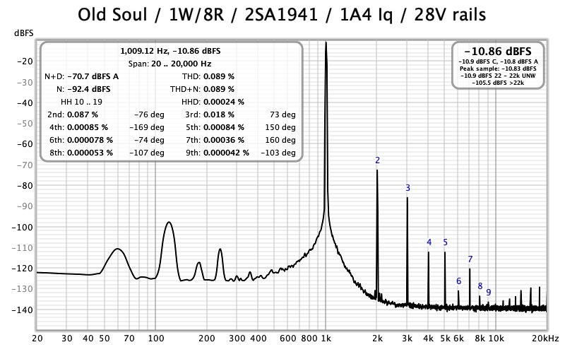

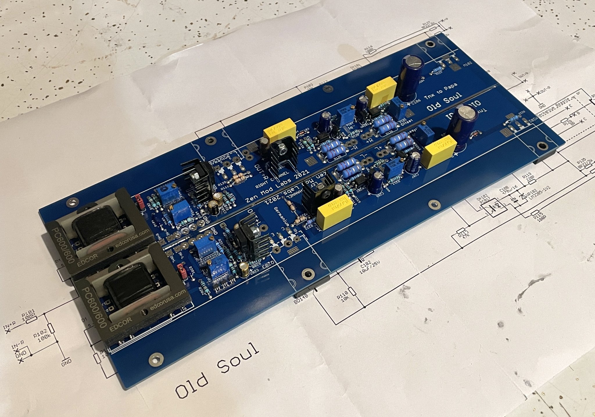

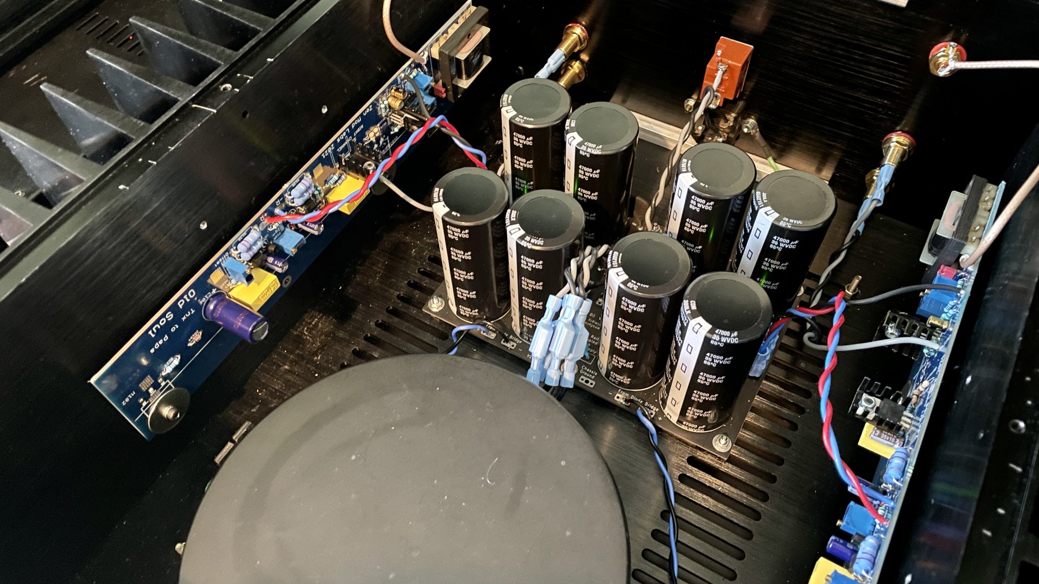

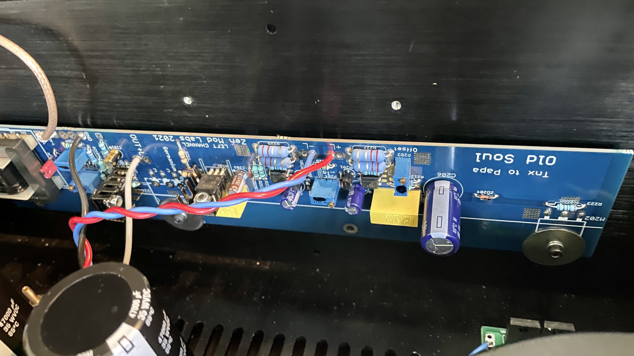

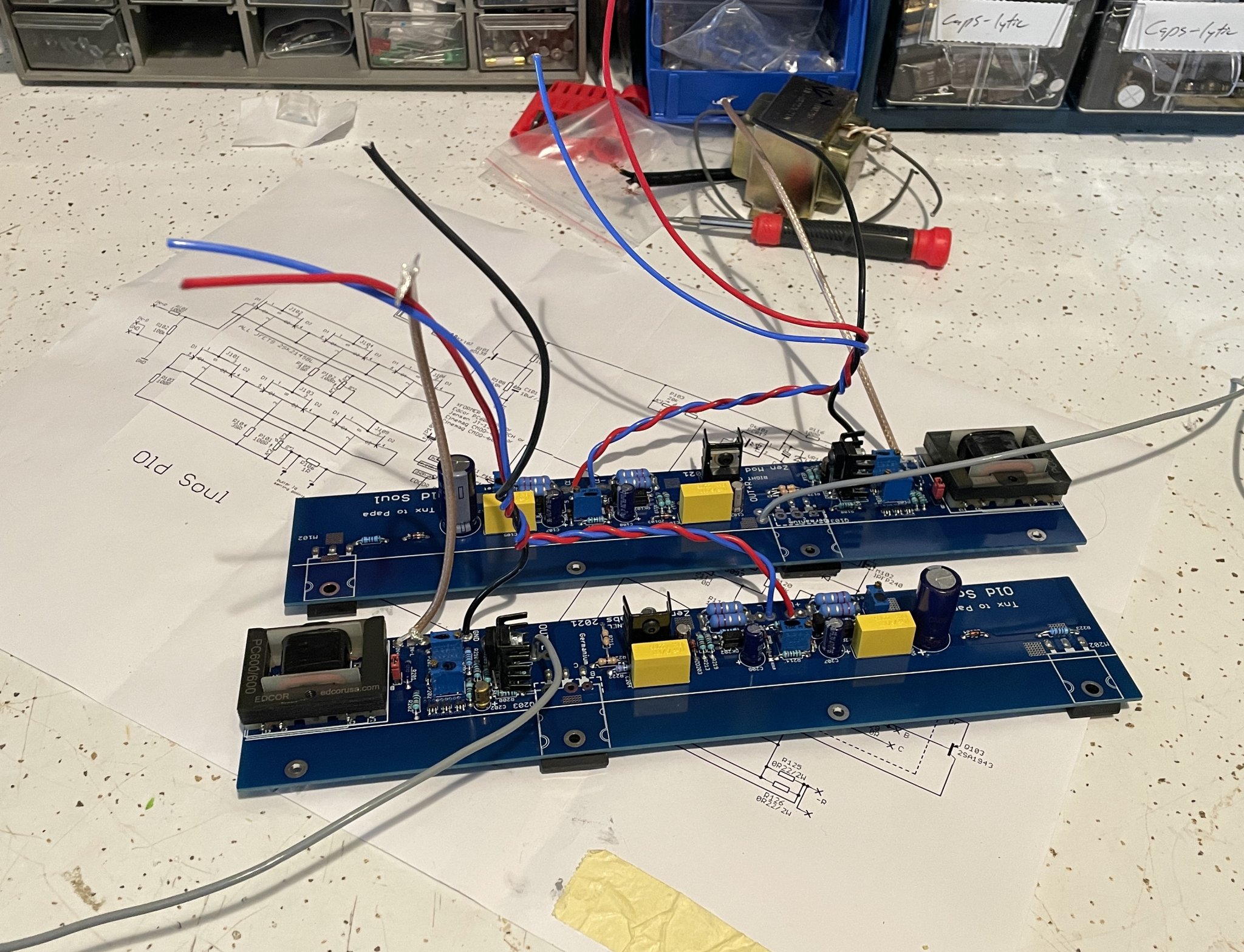

Another Old Soul lives. Went together without incident. Being limited on chassis’ I had to temporarily displace my beloved Scryer. We’ll see which one earns the chassis 🙂
I went the chicken route and started with the 2SA1941. Approx 28v rails and starting off around 1A4 Iq.
Lastly, a HUGE thanks to banderson546 for sharing his extra kit with me. Thanks again Bruce!
Oh, and thanks to ZM for keeping us busy with amazing amps…:worship:
