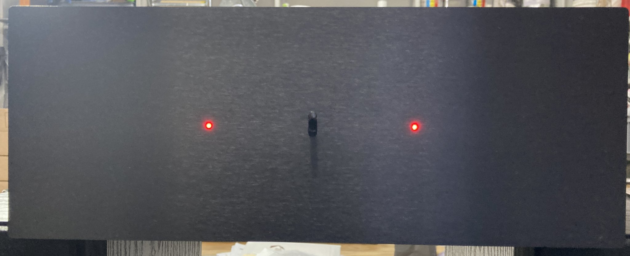

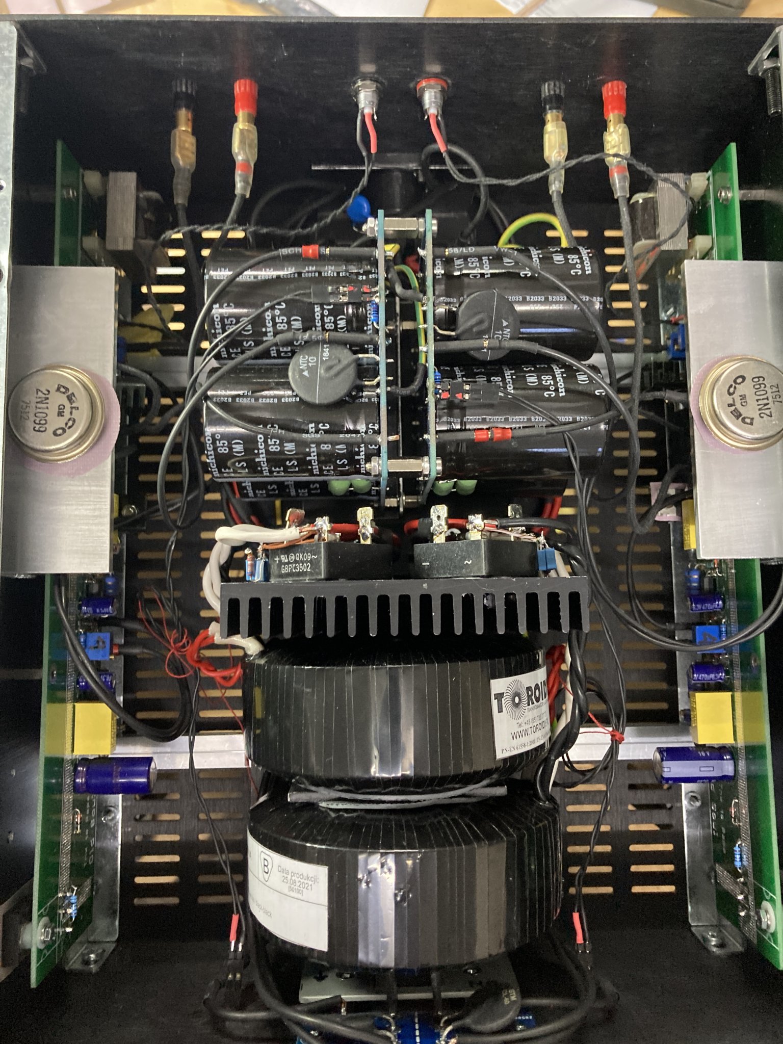

Even old souls can be super sexy! Nicely done!Lid closed!
Still hunting down proper transistors so I might try this one. I even used to work at a GM parts department that sold AC/Delco parts. Sad I did not get some. If only I had worked in elevator repair also.
Allready on it. It seems he has a day job. Bet he’ll share listening impressions tonightSound?
Andy is with me 🧐🤓
As he said, had to rush—it seems I have a day-job
I left it biased at 85mV, since it seems those buggers are real divas!
Last week, 2 elevators in the neighborhood suddenly stopped working, weird huh?

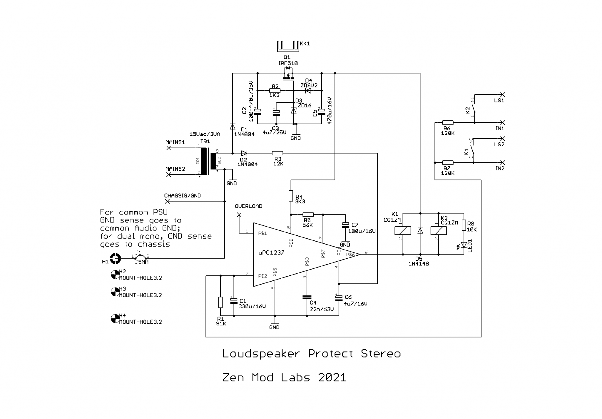

Dennis,
I got a spare protection unit (unbuilt) from the store, plus all parts from mouser… procedure as usual if you want it…

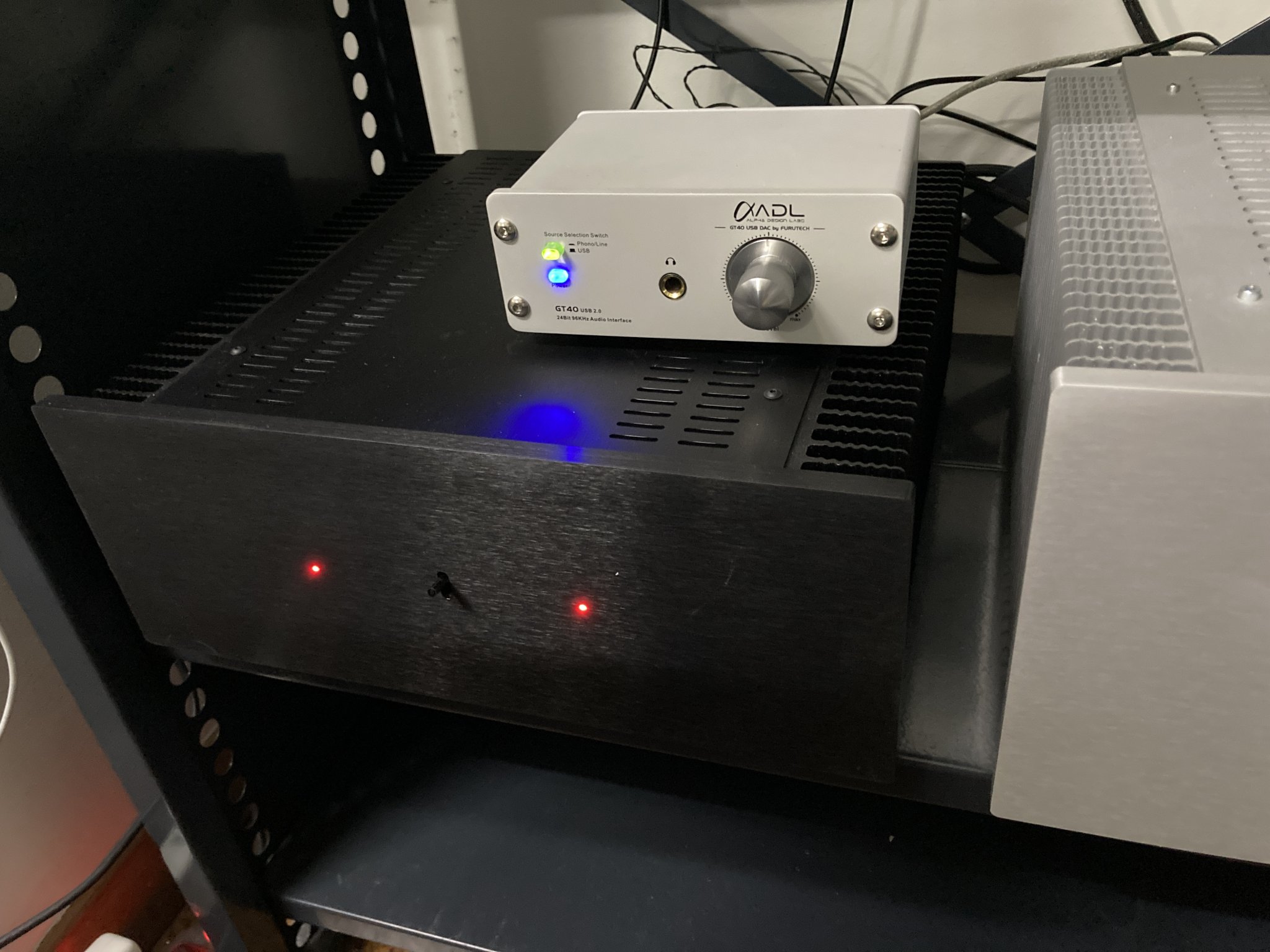

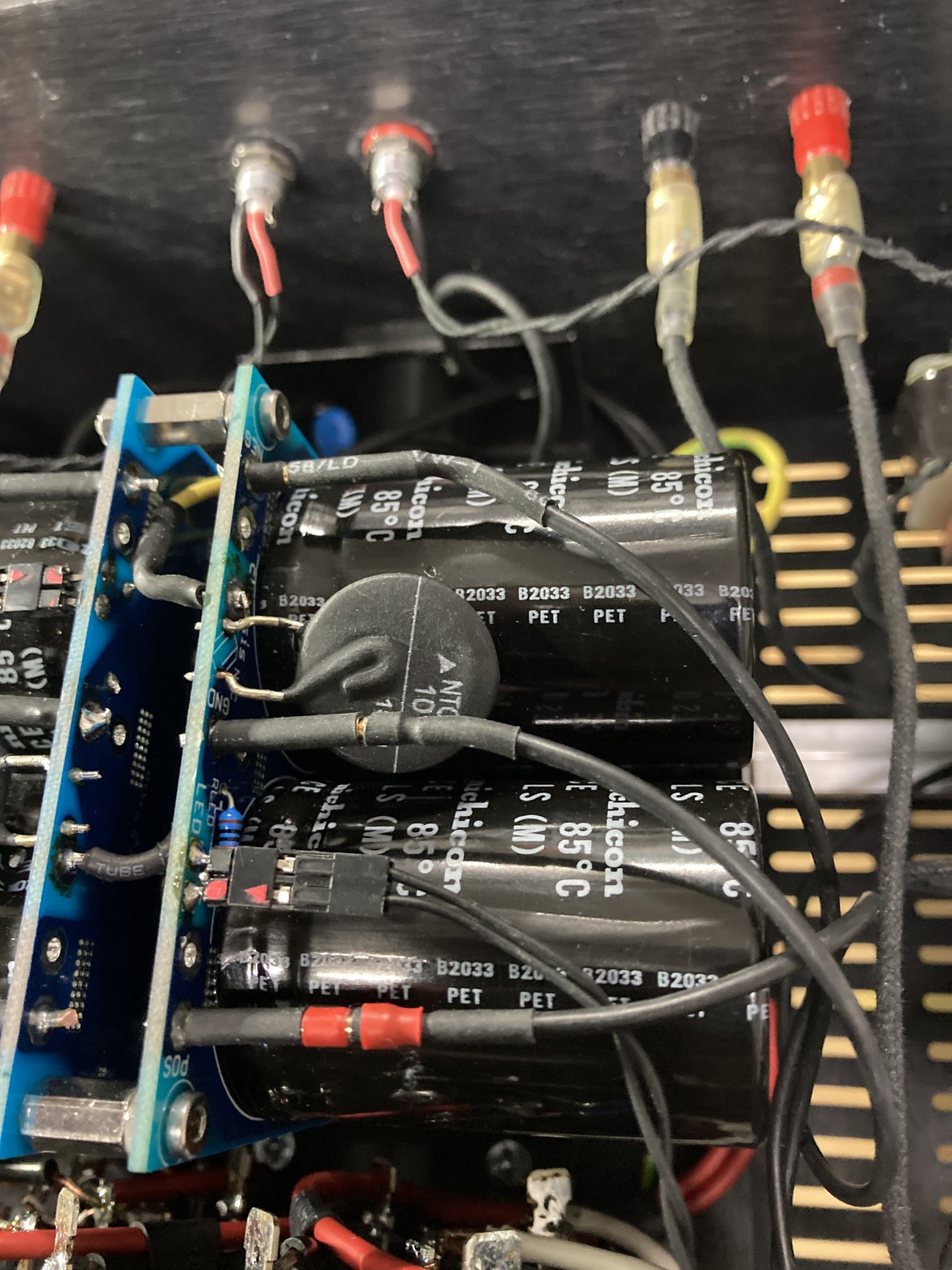

After inserting the naturally forgotten jumpers, it’s warming up with some ink spots and kenji jammer…
Hei, it sounds veryvery good.
First gasp and of course absolutely unqualified impression: I might prefer it over the sony vfet… but let us get to know each other a bit better! 😍
well after that you must tell moreFirst gasp and of course absolutely unqualified impression: I might prefer it over the sony vfet…
Could you elaborate on this get-to-know-process between you and your amps? There are many things I haven’t triedYes, I'll be pleased to, but as I said before, we have to get to know each other.
