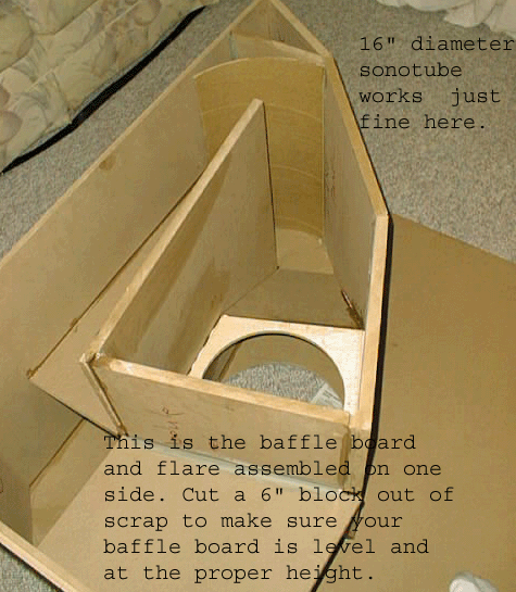

This end loaded vs offset issue was a big problem 15 years ago, everyone was doing it. Parham did the same thing in his Hornresp study of the Labhorn too, ...
PiSpeakers Forum - 12 ? observations and comparisons with other designs - Wayne Parham, July 08, 2005 at 03:53:47
That's the Labhorn study I was talking about, first and third graphs on this page. Haven't seen this page in years, but as I said, everything back then was simulated as end loaded but folded as offset, and it led to a saddle in the measured response that was not present (or worse than) in the simulation. Hornresp couldn't do offset back then, only Akabak could.
Anyway, it's interesting to see that he input the Labhorn rear chamber at 34 liters, which is much worse than the 40 that I showed. If it really is 34 liters when loaded with drivers it's about 32 percent too small.
Yet the measured response of the 12Pi and the Labhorn both show the same 2 dB dip.Anyway, it's interesting to see that he input the Labhorn rear chamber at 34 liters, which is much worse than the 40 that I showed. If it really is 34 liters when loaded with drivers it's about 32 percent too small.
Will be interesting if Wayne will post a measurement of the V2 and see what difference there is.
I don't know anything about the 12Pi other than what I see on that page so I can't comment on it, other than the fact that it can't possibly be end loaded but it's simulated as such.
Again, the point here is that nobody was properly simulating offset driver horns back then and there were consequences. And again, if you accurately build what you simulated the measured results should be very close to the simulation, there's shouldn't be any big deviations.
The Lab Horn throat is a pair of parallel baffles with an enclosed slot (throat chamber), the slot exit (7.5" on the thin dimension x approx 12") is smaller than the other end of the slot.Again, the point here is that nobody was properly simulating offset driver horns back then and there were consequences.
As such, it fits about as well to an end fire horn with a VTC as an offset driver model, other than a possible (very) minor path length difference.
At any rate, Wayne's old Lab 12 model conforms to the as built measurement you posted pretty well, and although his wider push pull 12Pi model adjusted front and back chamber volume from the original, the response of it is still quite similar, other than a slight increase in level due to the increased cabinet volume, and reduced even order distortion due to push pull loading.
The sonotube in the LabHorn example below was not recommended, it would reduce horn volume further from the original plan, reducing LF output.
Post 27 shows very clearly the effect of simulating as end loaded but folding as offset. It shows 32 cm offset which is too much offset but even a 6 inch offset has consequences. If you don't build what you simulated the measurements won't match the sim.
Anyway, I think that's enough, I've repeated that last sentence at least a dozen times now, anyone reading this can take that for what it's worth or leave it. This issue is exactly why some people refuse to trust simulations, there are examples everywhere of people putting whatever they want into a sim and then building something completely different and blaming the software.
VTC= Volume of Throat Chamber.I don't know what this sentence means and I don't know what VTC is (although I think the TC part is throat chamber).
Anyway, post 27 shows very clearly the effect of simulating as end loaded but folding as offset.
Offset horn VTC is usually only the volume enclosed between the driver and the horn throat baffle, the concave portion of the driver cone plus the baffle cut out thickness.
The Labhorn is built with a slot throat with a throat chamber volume which includes the concave portion of the cones plus the baffle cut outs, and an additional volume roughly 12.5" x 12.5" x 7.5". That enclosed volume feeds in to the first portion of the horn.
That VTC does not translate specifically as part of an offset horn path length.
You seem to think it does, so let's just agree to disagree.
All the simulations and measurements of both the Labhorn and 12Pi agree with me, and nobody simulates offset driver horns or tapped horns as end loaded anymore since Hornresp can now simulate them properly because it's clearly not accurate.
I'm happy to agree to disagree though, this is going nowhere. If you think you can simulate as end loaded and build something with the driver offset anywhere you like along the horn flare, good luck with that, but your simulations won't match your measurements. This wasn't well known in 2000 but I'm kind of shocked that this needs to be pointed out in 2014, but whatever.
