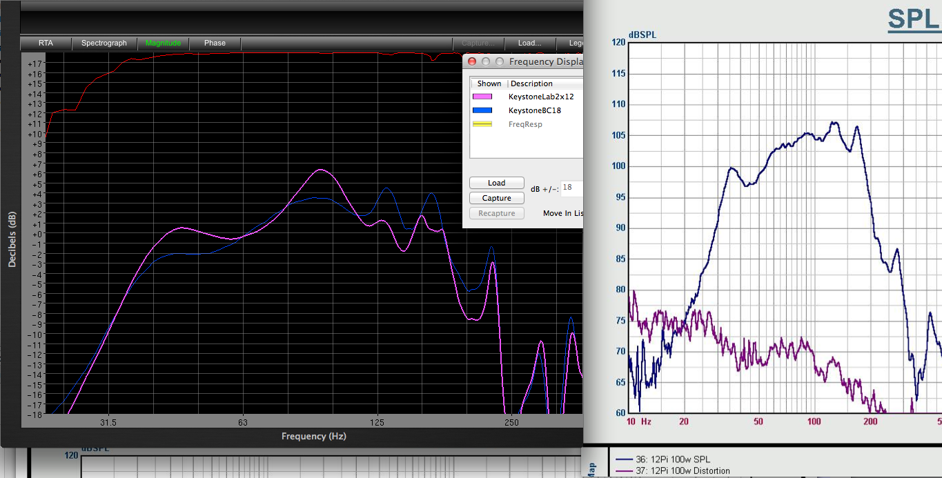

The Labhorn has a big hole right above tuning because a couple of key mistakes were made when it was folded. First, the rear chambers ended up to be significantly smaller than planned and second, the horn was designed as an end loaded horn with the first 6 (or so) inches of the horn considered part of the throat chamber. Both these mistakes contribute to the Labhorn's big gaping hole right above tuning. This is all documented in Danley's own posts while he was designing the Labhorn.
It's easy enough to get flat(ish) response from grossly undersized front loaded horns, there are lots of very petite 20 hz horns that don't have this problem.
The last paragraph (bolded) isn't correct. It isn't the lower (70 hz) hole in the FLH sim in the picture above that a tapped horn fills in, it's the higher (160 hz) hole in the BLH sim that the TH corrects with it's cleverly placed driver.
If what you say is true, then why does the graph show the opposite?
The dimensions of the horn are virtually identical, the only difference is that one is a FLH and one is a BLH. In the frequency response, we can clearly see that the BLH 'fills in' the lowest dip in the response of the FLH.

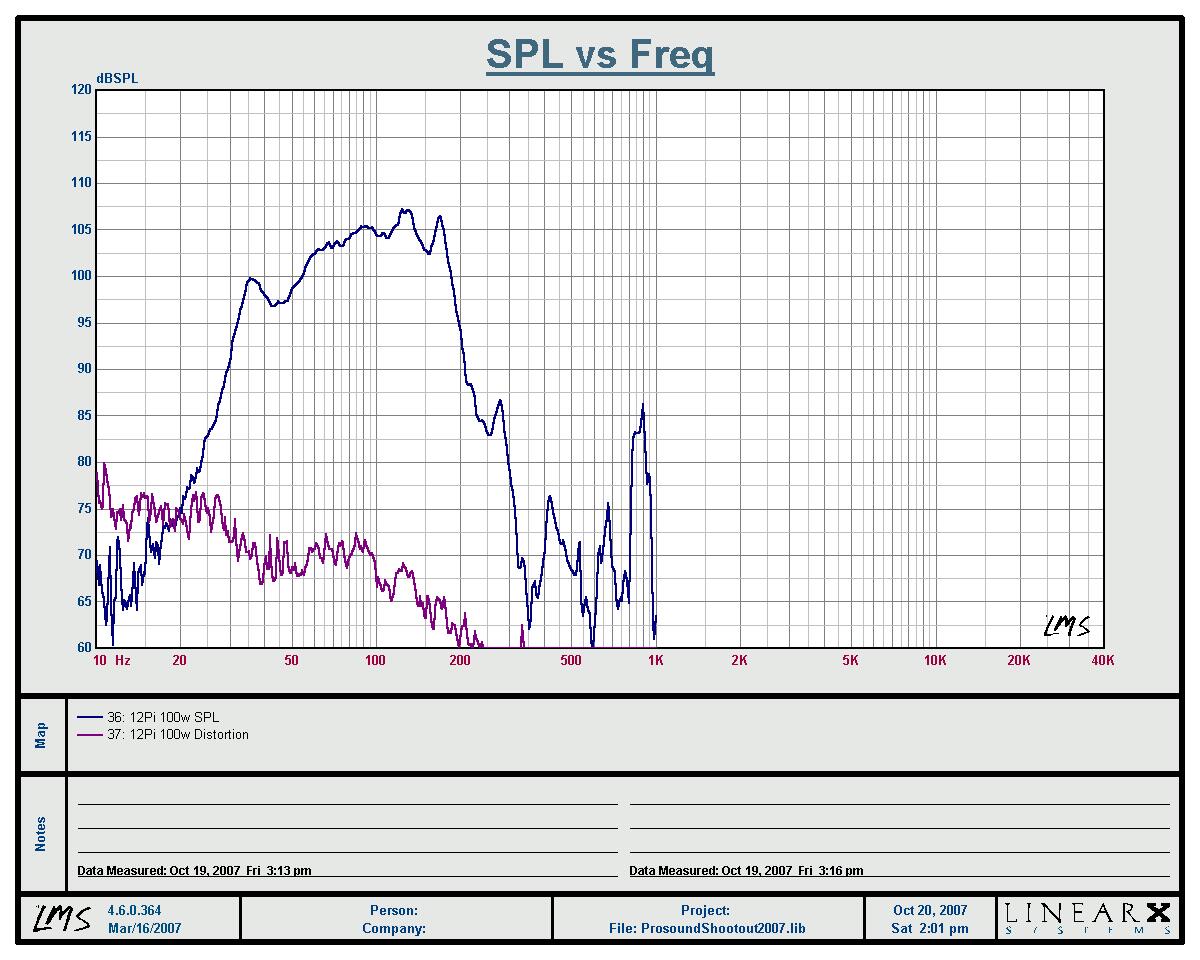

Here's a Fitzmaurice Titan 48. Note the dips at 80hz and 40hz.
Here's one of Waynes horn subs. Note the dip at 40hz.

Here's a measurement of a Bassmaxx sub.
See how the response in it's passband is smoother than many front loaded horns?
And see how there's a dip at 175hz? If I'm not mistaken, that dip indicates that the Bassmaxx is tuned to something around 52hz.

... how much does a 20% change in back volume cause?
Let's start with a simulation of the original design (before folding). The details of the original design (after chopping it up into separate cabs) is as follows:
St = throat area = 80 sq ins (40 sq inches per driver)
Vb = rear chamber volume = 1530 cu in per driver (separate rear volumes for
each driver)
Vf = front chamber volume = 170 cu in per driver (volume between cone & throat)
Flare = 26.4 Hz, hyperbolic t = .5, path length = 126 inches (inc front volume)
... and yields this response.
I think we can all agree that there is no big gaping hole in response right above tuning in the original (unfolded) design.
(Note that this is not entirely accurate, since the first 6 (or so) inches of the horn are included both in the front chamber volume AND in the horn flare, I just input everything exactly as specified and didn't bother to do the math to find out how much smaller the front chamber should be when simulated properly.)
Acoustically the “saddle” in a bass horns response reflects the mouth being too small ...
The saddle CAN be caused by an undersized mouth, but the simulation above shows that this is not the case with the original (unfolded) Labhorn design. There is no saddle.
Now let's go ahead and explore the implications of making the rear chambers 20 percent smaller and simulating as an end loaded horn but folding as an offset driver horn.
I'm going to switch now to an approximation of the folded Labhorn (not accurate but close enough) to explore these effects for a couple of reasons. First, the Labhorn changed considerably during folding (it lost about 100 liters) and second, because I can't sim an offset driver horn with a hyp-ex flare.
This graph shows an approximation of the Labhorn (still end loaded) with a full sized rear chamber (as per the original plans) in dark black vs a chamber that's 20 percent too small in light grey. You have to look close to see the effect. The reduced chamber size makes the peak at tuning a bit bigger and creates a small saddle right above tuning. This by itself is not catastrophic but now let's explore the effect of simulating as an end loaded driver but folding as an offset driver horn.
This is with the full sized rear chamber in dark black vs offset 32 cm in light grey. It's offset too far since I don't have enough segments available in Hornresp to put it where it should be, so again not accurate but good enough to see the effect. Again you have to look close to see the effect, but this also creates a bit of a saddle.
Now one last sim to show BOTH the effect of an undersized rear chamber AND the effect of simulating end loaded but folding offset.
So that's the end loaded Lab with a full sized rear chamber in dark black vs the offset driver with 20 percent undersized rear chamber in light grey. You don't have to look so close anymore to see things are getting quite a bit different than the original design.
The Labhorn's saddle has nothing to do with an undersized mouth, the fold simply just does not match the original design.

Wayne's 12Pi addressed the front and back chamber issues and made the cabinet larger than Tom's Labhorn, it still has a saddle.The key to getting rid of the saddle is to make the front chamber larger or to change the flare to move the impedance peaks closer together, or a combination of both.
The tapped horn was not invented to remove this saddle right above tuning. It's a completely different alignment than a flh. The tapped horn is simply a back loaded horn with the driver placed to remove the first big dip caused by the BLH's natural resonances. A properly designed BLH won't have the saddle right above tuning but it WILL have a deep notch higher up in frequency. THIS is what the tapped horn fills in.
You can see another saddle example below, a pair of Lab 12 compared to a BC18SW115 in the same tapped horn cabinet.
Art
Art

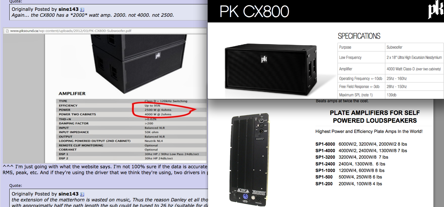

The CX800 uses one amp to power two cabinets.Again... the CX800 has a *2000* watt amp. 2000. not 4000. not 2500.
The amp is likely the DSP version of the Speakerpower SP4001.
The SP4001 puts out 4000 watts in to 2 ohms (two cabinets) or 2500 in to one 4 ohm cabinet.
The SP4001 is rated at 2400 watts at 4 ohms, but the PK actual load is probably a bit under 4 ohms, so 2500 watts is not a stretch.
The SP4001 handles two ohm loads with no thermal problems.
As you have reported EDM music with less than 3 dB crest factor, 1000 watts per cone is about all the average power the speakers in the PK CX800 could handle with that kind of crest factor.
Properly managed, with separate peak and RMS limiters, the speakers could safely handle 2 or 3 times that power, but considering PK is carving it's niche in genres with limited dynamic range, the added expense of more power probably wouldn't be warranted.
As far as any debate over horn vs vented box, the vented box wins by a bit from an output per transport size standpoint, but TH or FLH win from an output per driver and watt.
Considering the horn option can cut the amount of drivers in half, and power by 1/4, from a cost standpoint when transport is not figured in, horns are a big win.
And of course, Hoffman's iron law comes in to play, low, loud or small- pick two.
When comparing two cabinet types, if the low frequency response extension is not the same, the comparison is not valid.
I don't know the details of the 12Pi but as I've clearly shown it doesn't need to have a saddle. As long as you simulate a good design and accurately build what you simulated there's no reason for this saddle.
There's always going to be a bit of a dip between the impedance peaks especially in grossly undersized front loaded horns but it doesn't have to be a big dip. Here's the simulated and measured response of Lilmike's F20 front loaded horn. At about 450 liters it's GROSSLY undersized compared to the tuning frequency. It's got a bit of a dip, you could even call it a saddle, but it's not even as deep as the Labhorn's saddle.
Art
That dip could be fixed right up by altering the flare or dropping in another driver (like a BC18SW115 maybe).
The point here is that you can have a saddle if you want one (although I'm not sure why you would want one) but you absolutely don't need to have one. A mild dip is always preferable (IMO) and always achievable.
Art
I too initially thought that the amps were the speakerpower SP4001. Reportedly they are Powersoft plate amps however. In the 8 times I've experienced large stacks of PK Sound amps, it was clear that they did indeed use 1 powered sub to power itself and 1 passive sub (Every Time). One of these situations (artists Datsik, 8x cx800s) I was actually standing between the substack and the stage, and saw this to be the case (and unfortunatly neglected to take pictures).
All the other shows used stacks of 24 or more PK subs ( sub 2k person) , so they were coasting (amp size irrelevant).
9k a piece (used) has been tossed around for the cx800.

The 12Pi Hornresp sim does not show a saddle, but as built it does, with the average measured frequency response fairly close to the sim.As long as you simulate a good design and accurately build what you simulated there's no reason for this saddle.
Lilmike's sims shows more of a saddle than as built, and comes in 5 Hz higher (1/3 octave!) than the sim (within 1Hz of the driver's FS).
So which is more accurately built 🙄?
