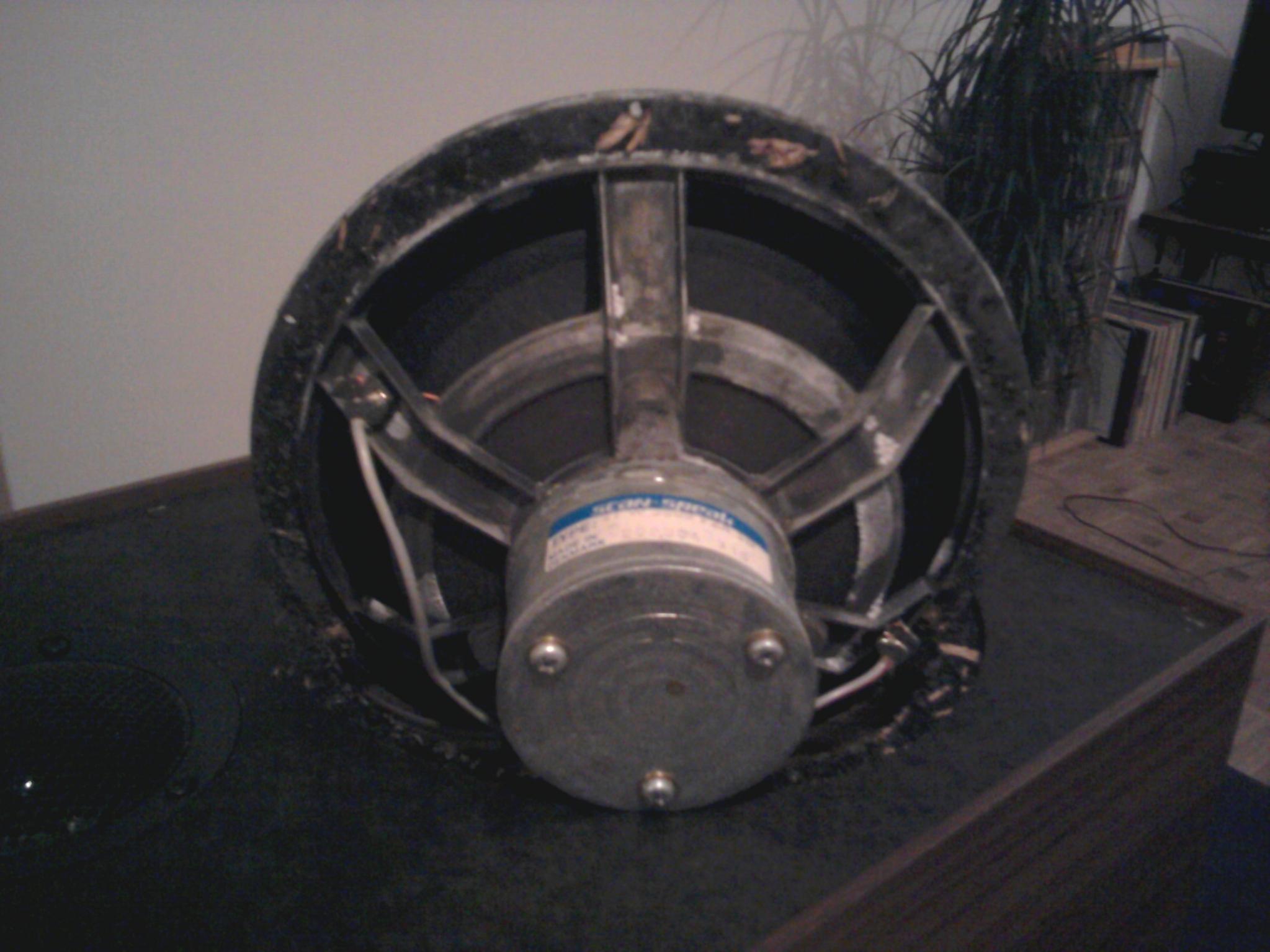

those are 2 lovely sounding drivers. here is another piscure of one i have at home.
sorry for the bad picture. (will try to get a better one later.)

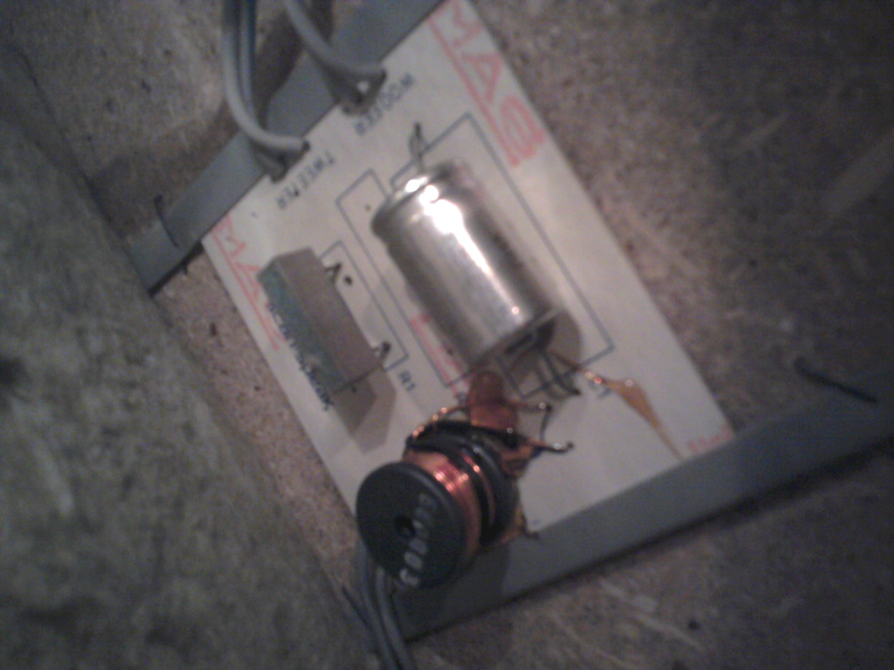

re-cap xovers and trust to your own ears
then , if you're satisfied , measure T/S parameters of woofers , ask for help regarding new boxes for them

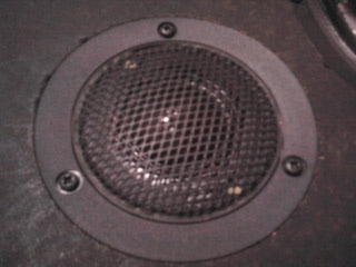

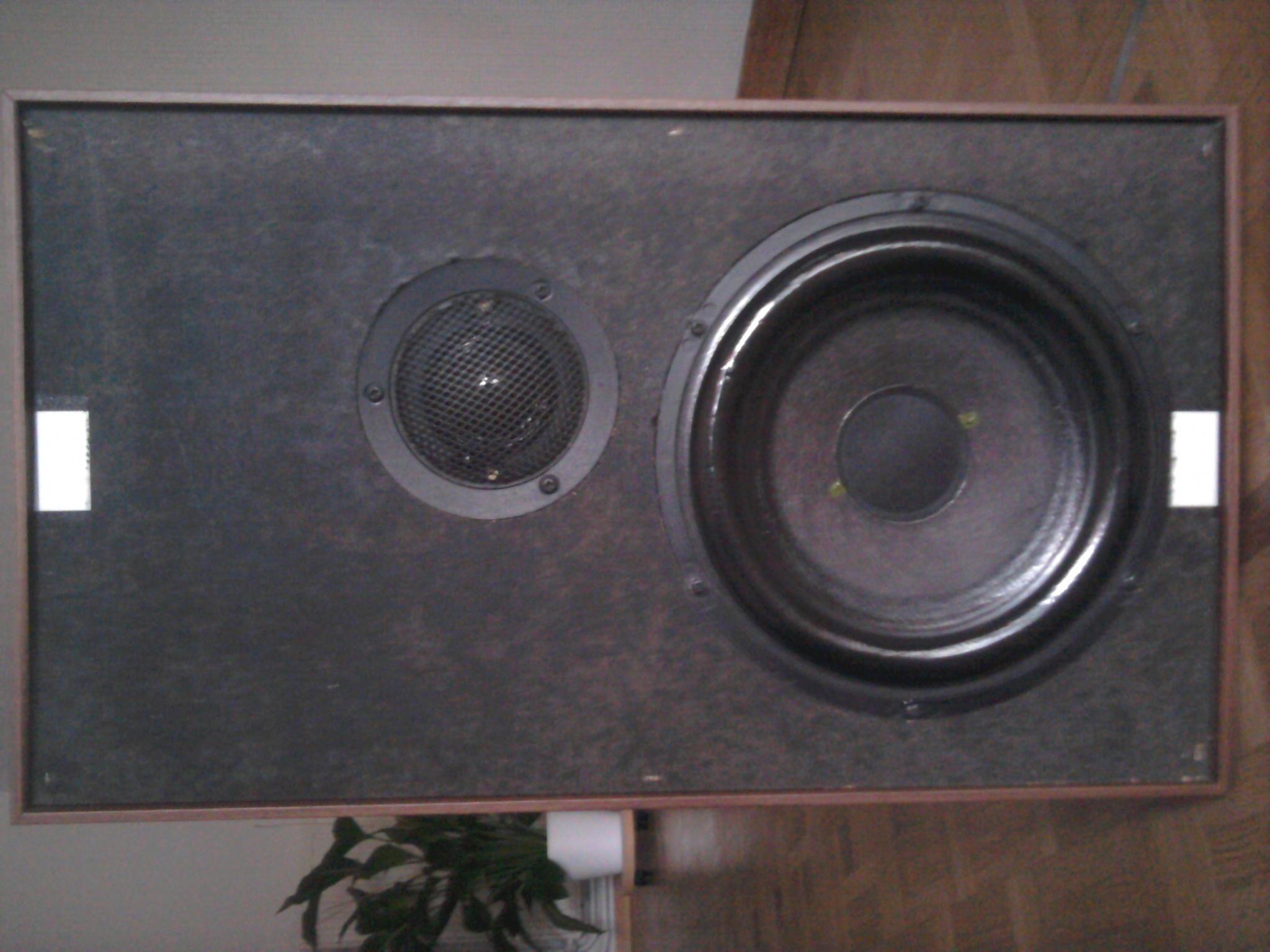

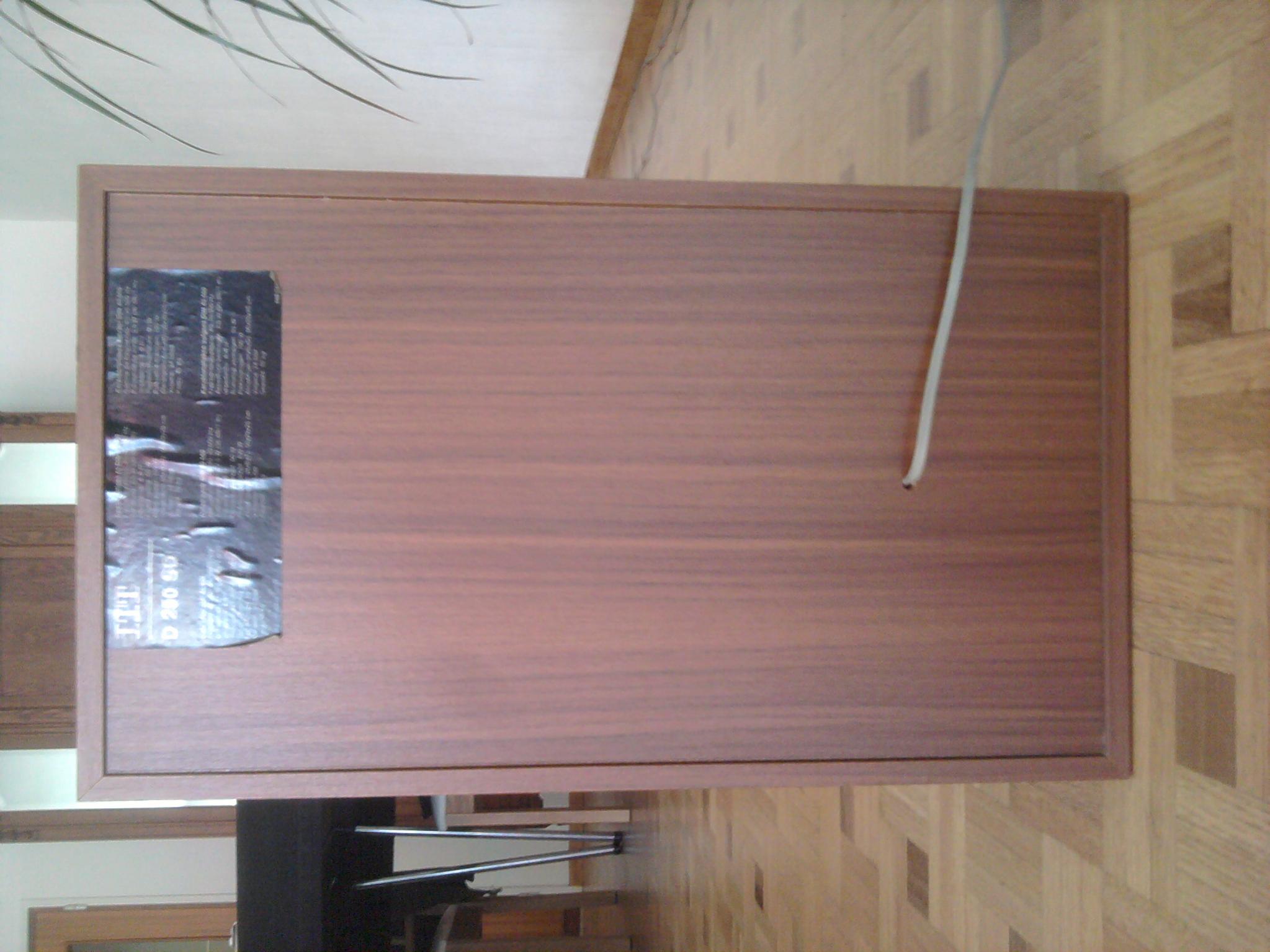

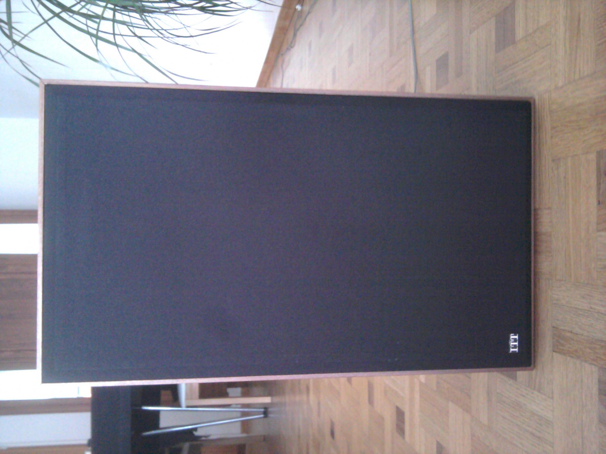

Pic's ITT D250SD
I don't now a thing about T/S mesurements, wikipedia will teach me 🙂
The drivers are a D3804 and a 21W-D3808. Can't see ...µF of elco.
Anyway I don't feel like re-cap yet, so far they sound nice enough to me.
However I dit regleu them afther picture show this time and that really make's a difference in the lower sound. They must be air tight.

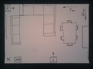

About the low/bass sound, there's a picture of my livingroom. Where the X is U really get a strong bass sound. Not where U want it but breathtaking, massive.
Beware your neigbours.
Bert.

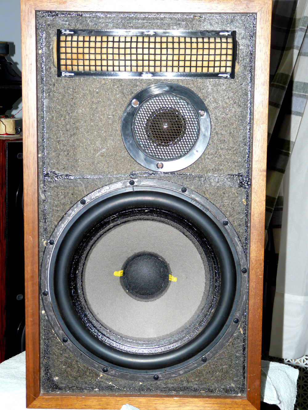

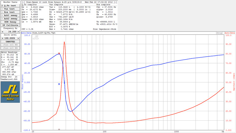

Here are WT2 T/S parameter tests on the vintage Dynaco A-25 SS woofer p/n noted in post #40. Also, a pic of the speakers with it's very early above-the-tweeter variovent slot placement.
