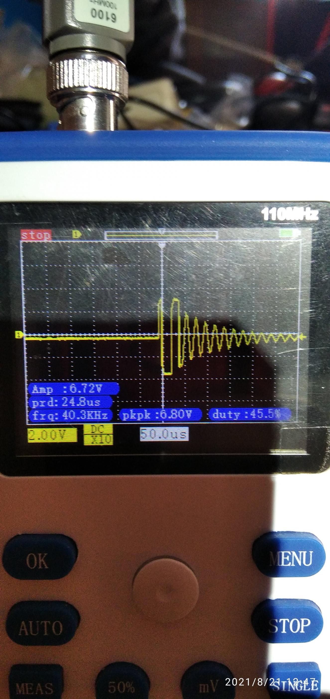

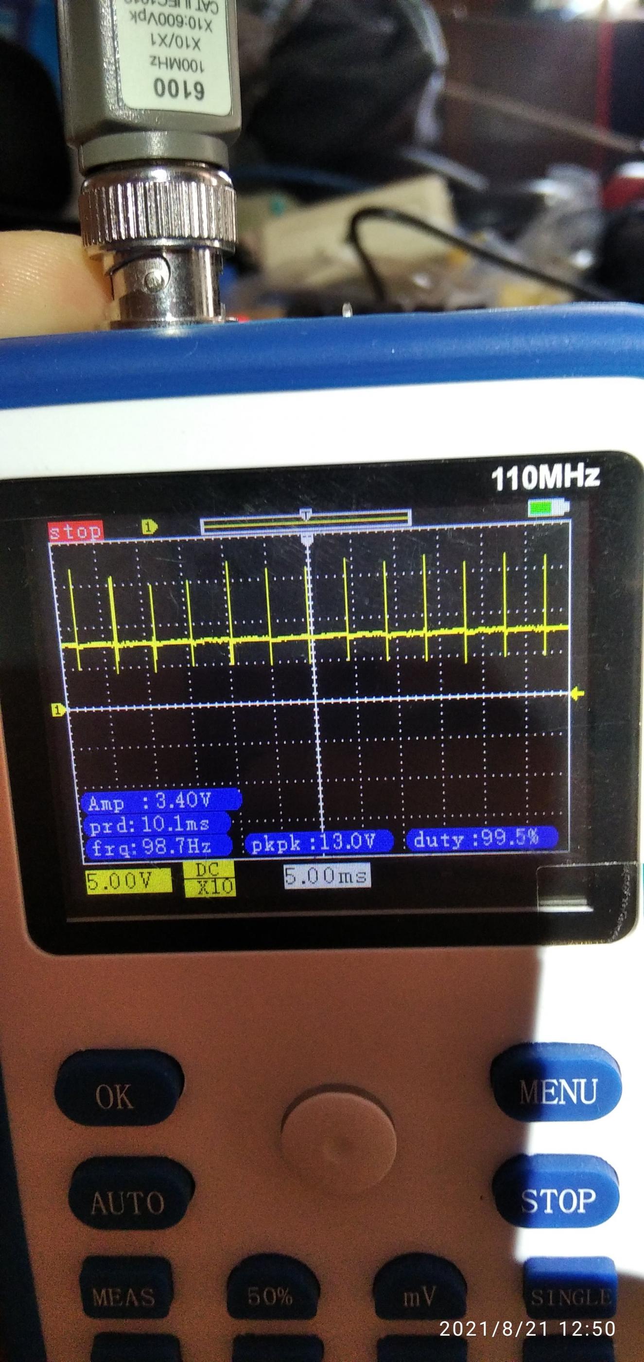

this graph is taken at the Rectifiers
it looks like its turning on then off and trying again

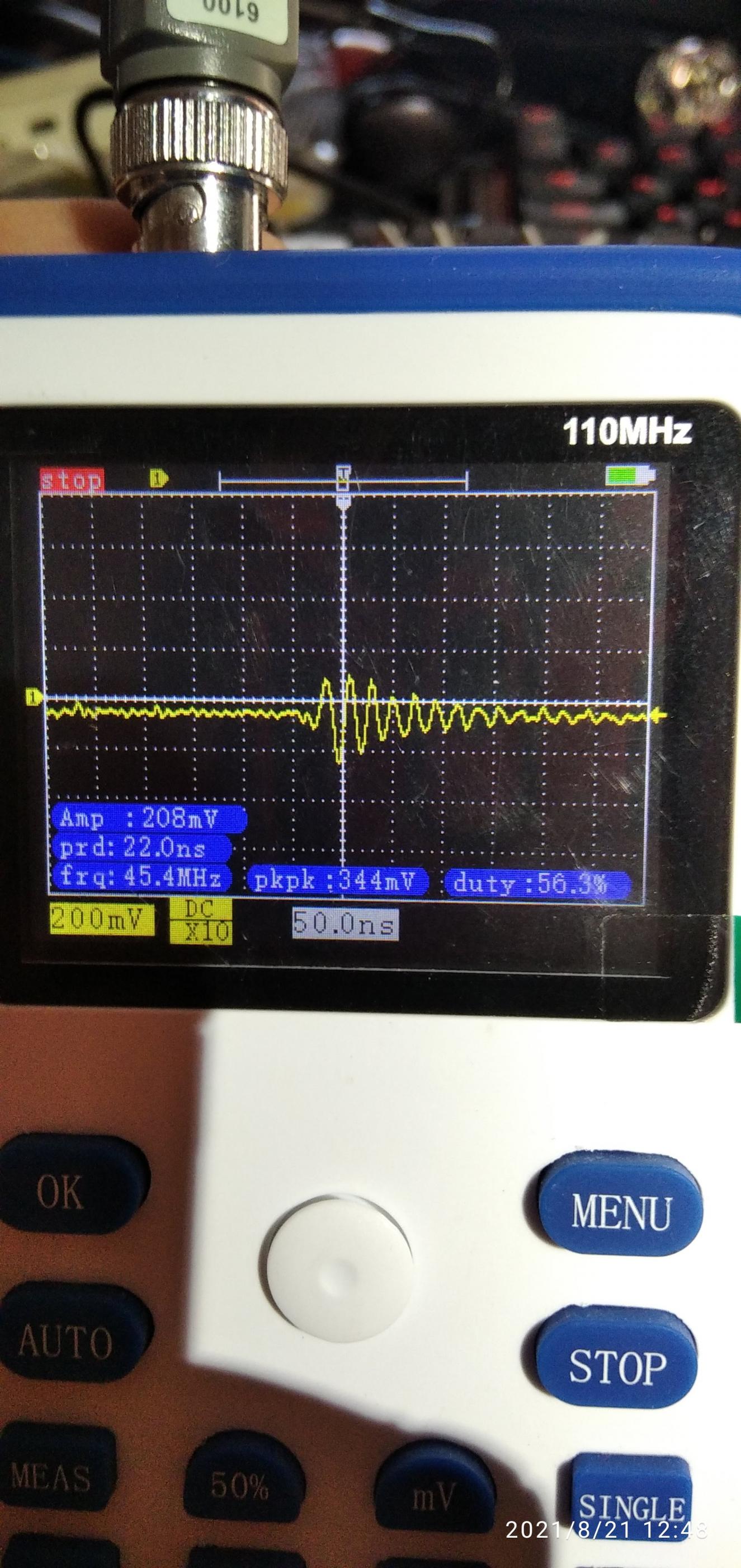

this one is taken at the Gate
and this one is at the drain

i removed the rectifiers and turned on the amp and this is the waveforms at the rectifier pads without the rectifiers
so i tested the Rectifiers MUR810
Datasheet
and they tested ok
this is at the gates without rectifiers
this one at the drains without rectifiers
so i think the irf3205 are good

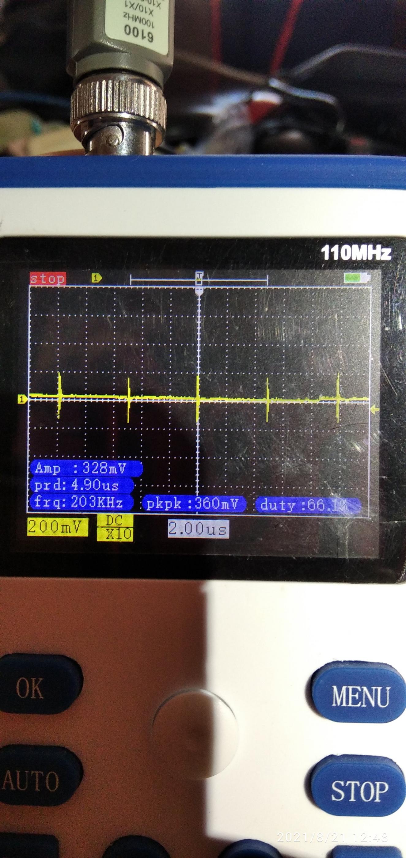

heres the waves of the ic sg3525an
the OSC
PIN1
PIN2
Waveform Yotube Video Waveform Yotube Video
SG3525AN PIN VOLTAGES (FAILING) - (WORKING SIDE)
1 2.57 - 1 2.60
2 5.91 - 2 4.32
3 0.018 - 3 0.020
4 0.341 - 4 0.340
5 2.070 - 5 2.077
6 3.75 - 6 3.77
7 2.027 - 7 2.030
8 4.90 - 8 4.92
9 6.42 - 9 5.91
10 0.000 - 10 0.000
11 0.019 - 11 2.073
12 0.000 - 12 0.000
13 6.93 - 13 6.67
14 0.021 - 14 2.071
15 7.58 - 15 7.50
16 5.15 - 16 5.17

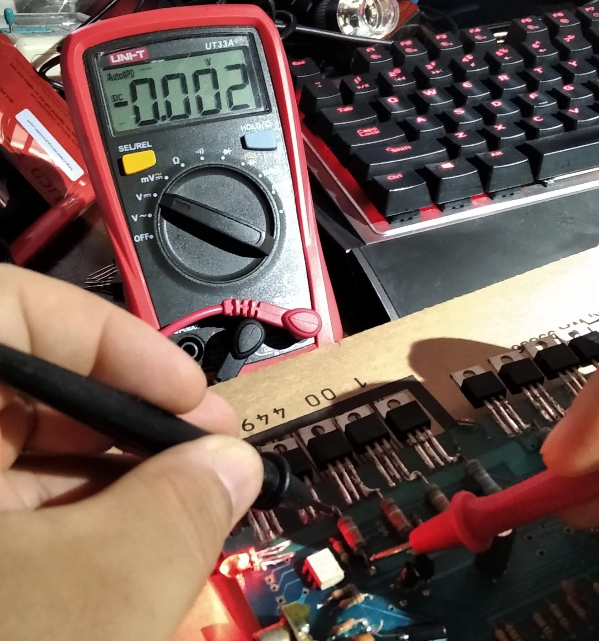

replaced the bad and missing .22 ohm 2 watt M.O. Resistors
remember 1 channel still has the originals the one that is ok
when i remove all the new 2n6490 and 2n6487 power supply goes back to normal
i check the 2n6490 and 2n6487 with the transistor tester and they test ok
i always had te amp wired to a OCP OVP power supply setted at 12v and capped at 1 amp and i have 1 car light bulb in series on the positive line
voltage between + and - wires after bulb 8.15v
all opamps has their +15-15v
it is posible to still damage a part with this setup?
help im stuck

here they are with the 25n05e originals all tested good
left to right drain-gate-gate-rectifier
