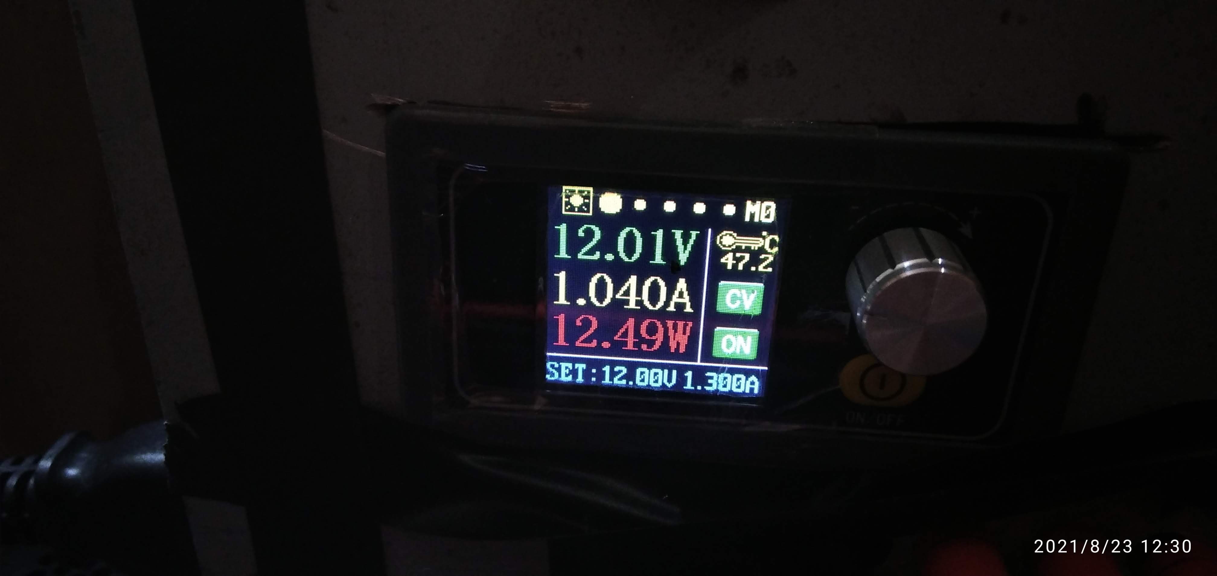

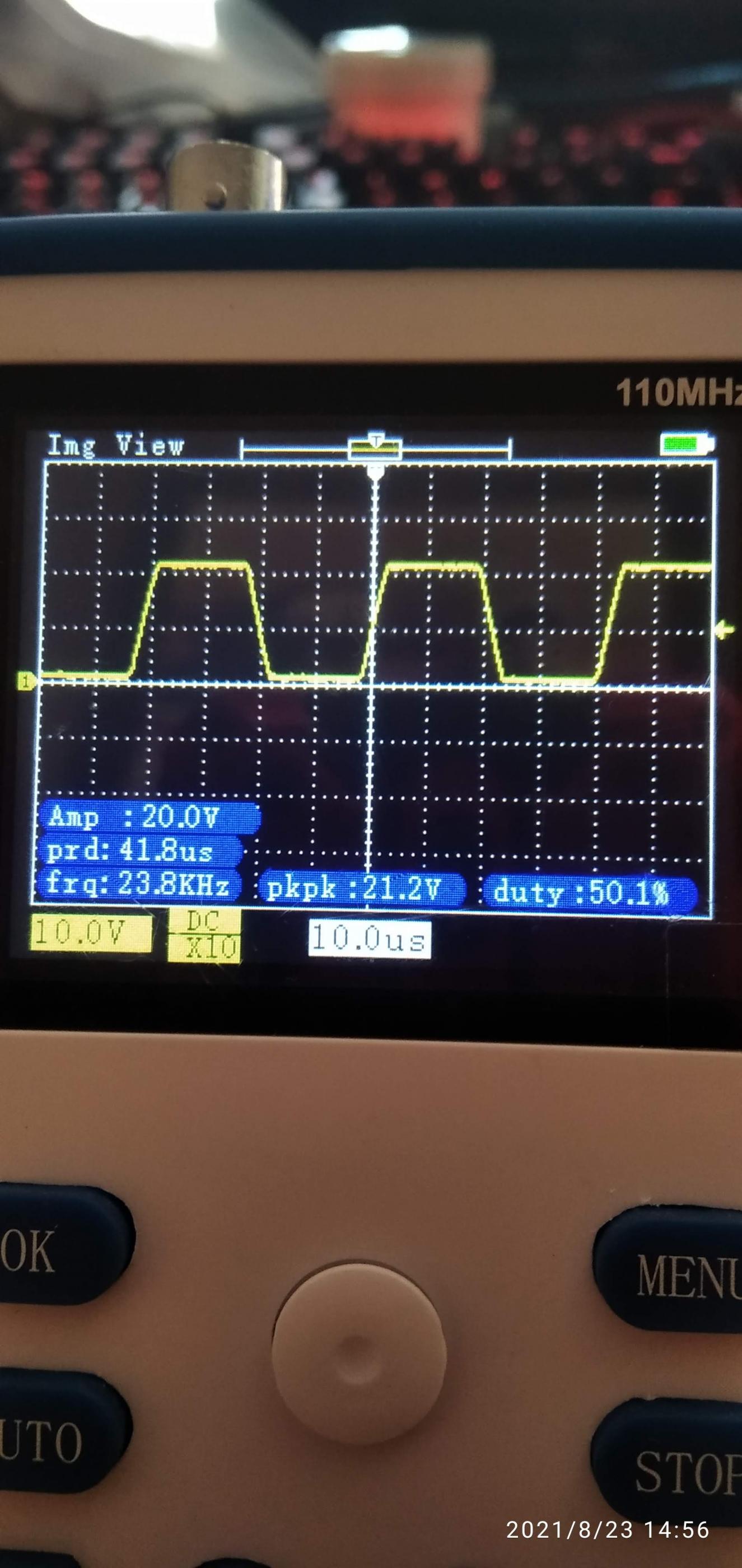

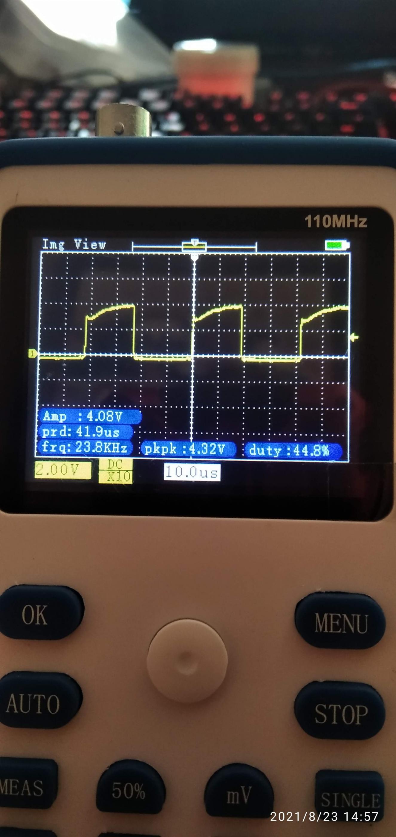

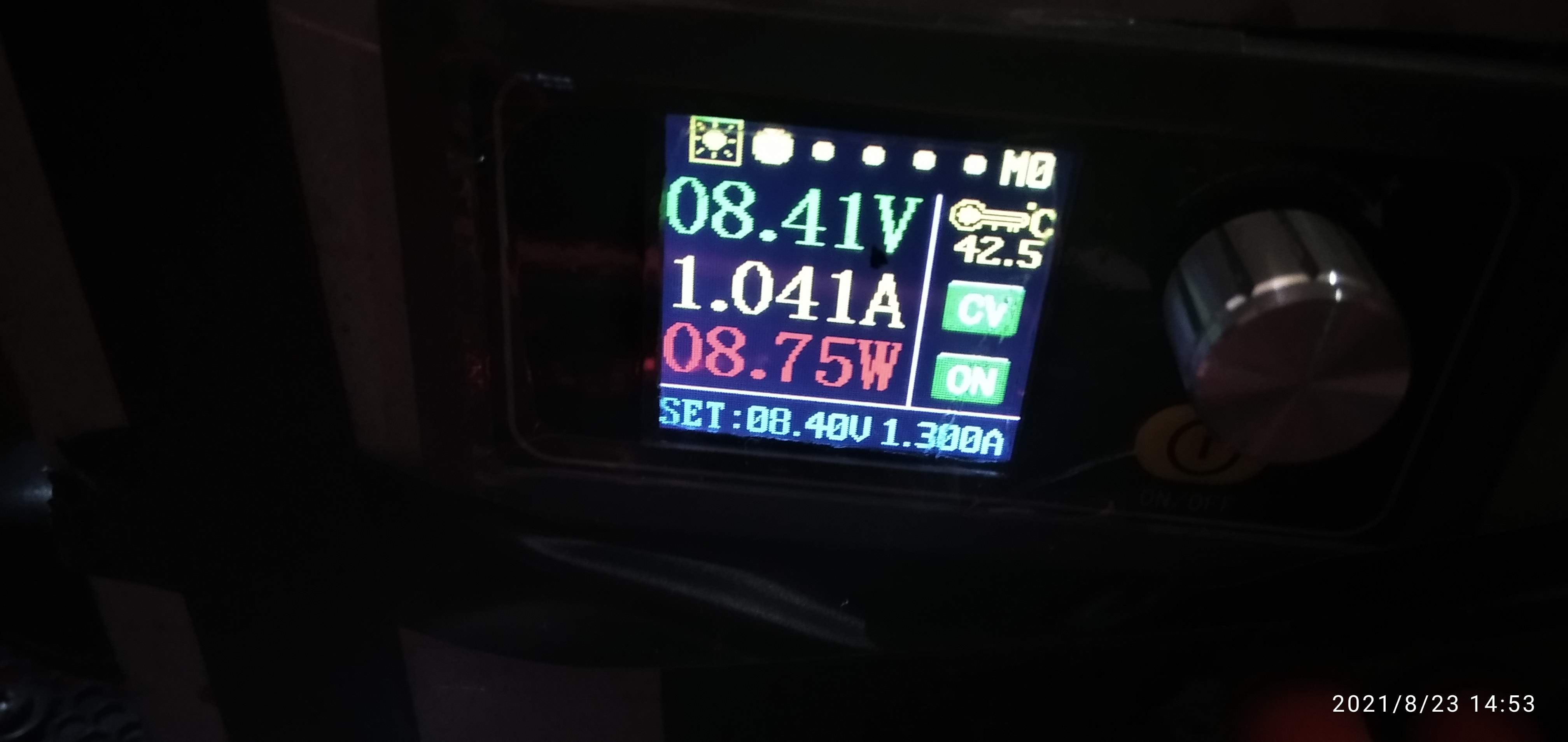

fuuuuk after i checked all to-92 i was a liitle upset because everything tests good so i removed the light bulb, the variable power supply was capped at 1A power and it was activating the OCP me thinking was protecting from a short (before changing all caps consumption was about 800ma on idle) i said **** it lets give it some more room and see what heats up so i setted it to 1.3A and IT WORKS now is consumming a litle more than 1A on idle !!! waveform its the same on both channels now to change the 8 25n05E for the 10 IRF3205
Reduce the DC input voltage as far as you can without the amp shutting off. Does the current draw increase at the lowest voltage it will run at?

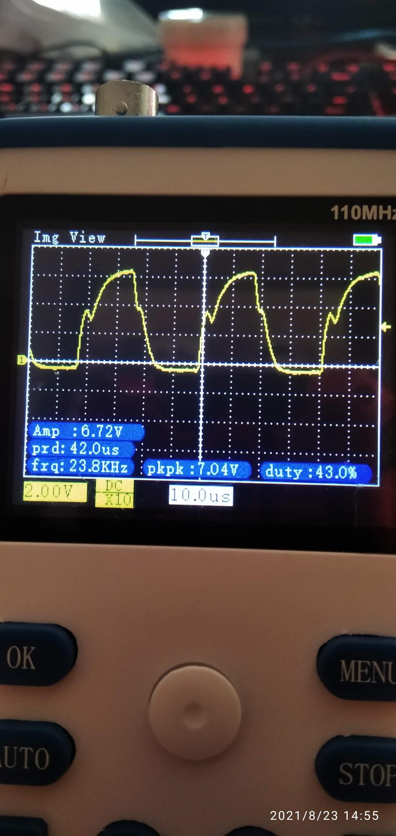

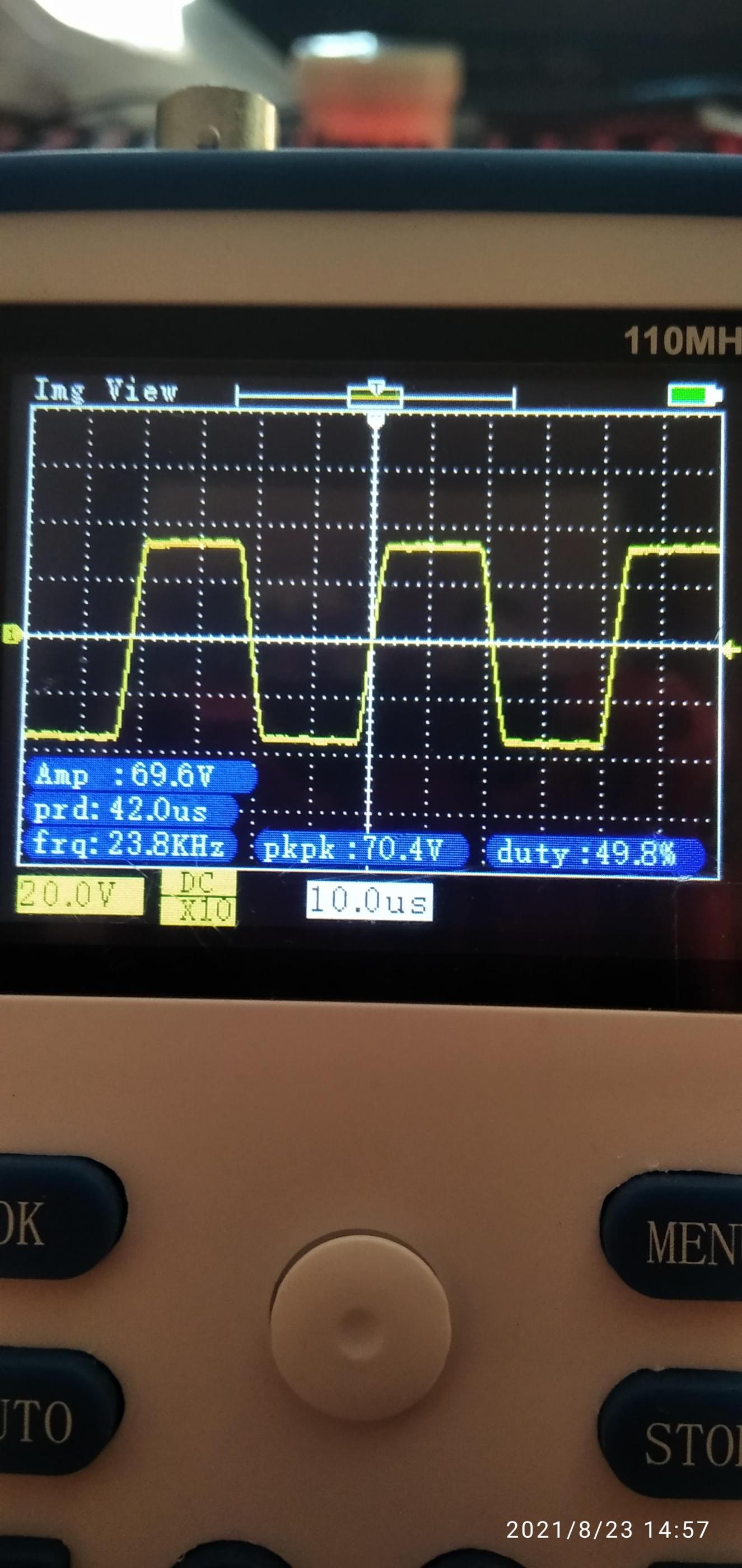

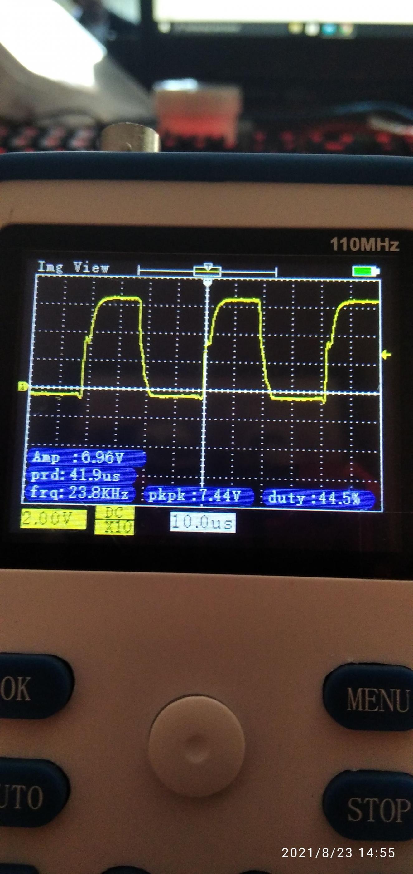

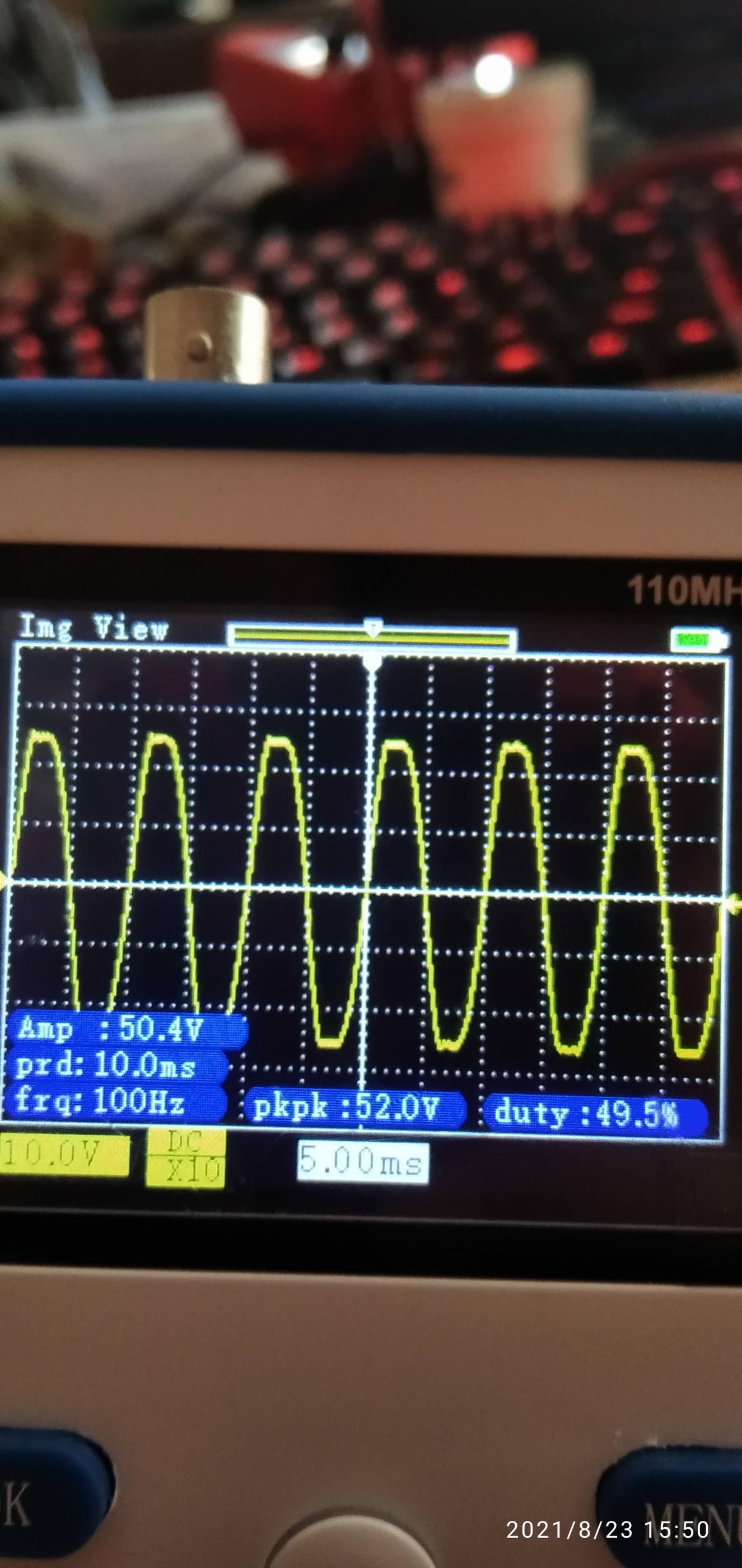

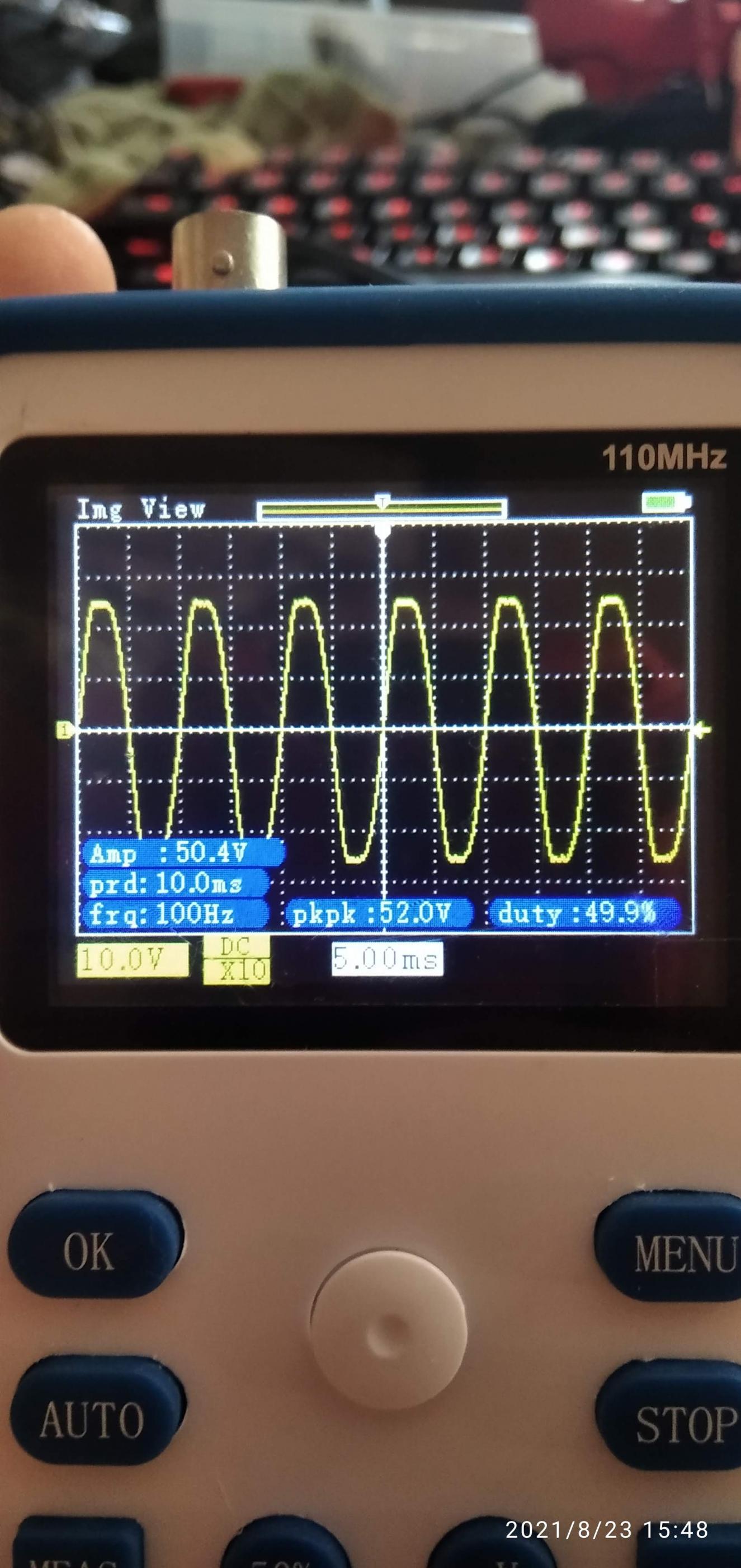

minimum voltage it turns on - wave at rectifiers - wave at drain - wave b4 gate resistor - wave at gate IRF3205 - Wave at 25n05e
it still has the original gate resistor what value should i order
I would expect that the IRF3205s would be heating up more than the original FETs. Are they?
Typically, 47 ohm gate resistors are used with 3205s.
the 2.2k stay like that?
i can get 47 OHMS 1/2W or 1/4W carbon resistance and PRECISION RESISTOR 47.5 OHMS 1/4W not a lot of diference on price
