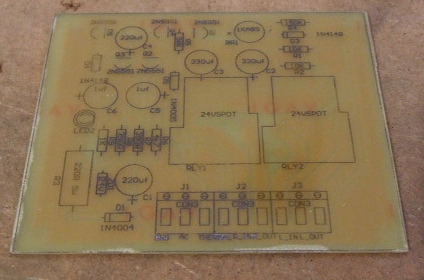

I've never had any need to run it through twice. Just make sure the image is 2 bit, and crank up the contrast.
There is a yahoo group dealing with toner transfer, Homebrew PCBs .
Their database lists various paper and the results

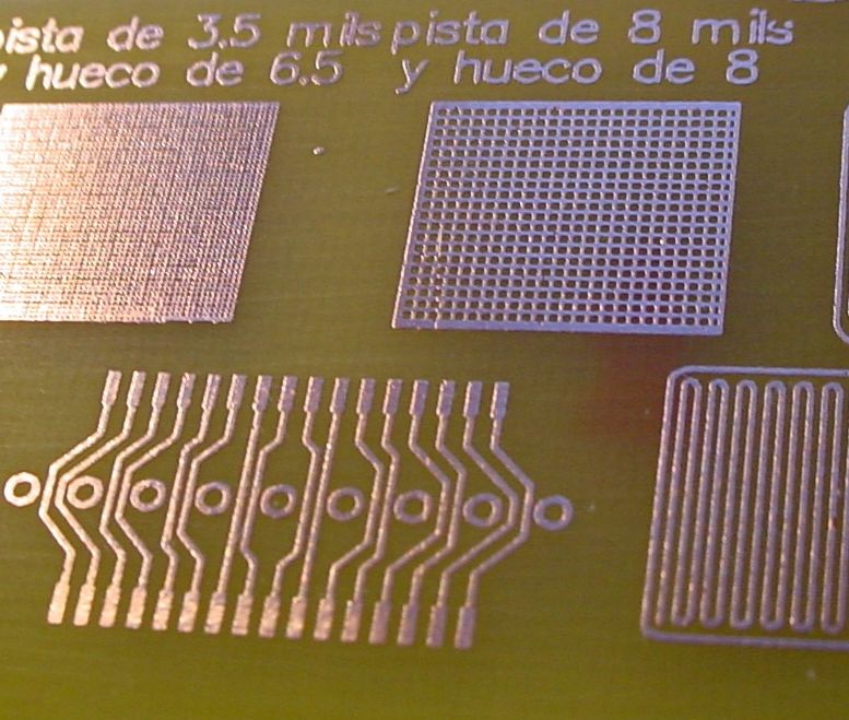

Attached is a pic of one of the groups results for TT.
Regards
James
