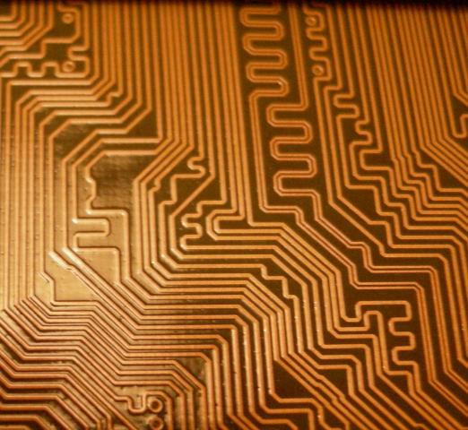

wow...
I wonder if that is to equalize propogation delays?
There are other reasons for doing that though.
poobah said:wow...
There's a lot of such traces, and it is never regular or systematic in any obvious way, so they must have put a lot of effort into it, I guess. I don't know why they do it. My guess is also to equalize propagation delays, or even deliberately modify it for certain signals. But I am curious about what other ideas you have? Deliberate inductance? Questionable.
I can't remember seeing anything like this on my old MB, though, but that one is over 5 years old.
Christer said:There's a lot of such traces, and it is never regular or systematic in any obvious way, so they must have put a lot of effort into it...
Probably the autorouting alogarithm just puts kinks in where it fancies to equalise path lengths.
poobah said:Christer,
What makes a board look 70's is the curved and often crooked traces that were laid by hand.
And the blood stains from the scalpel ....... BTDT etc etc
Yes, maybe autorouters can do this if one asks them to have equal path length. It wouldn't be that difficult, of course, to write an algorithm that inserts serpentines wherever there is place for them if a longer trace is needed. It might have to move things around and try a couple of times though. What made me suspect human interaction is that these serpentines ought to add inductance, but I realize now i was thinking wrong. The way they are laid out will rather cancel the fields to minimize inductance.
That is now standard fare on modern autorouters: Routed pathlength is one of the database parameters and can be set to equal another path or to a specified length (=delay).
Rip up and retry will also push other stuff out of the way to achieve this.
Very common now on PC boards when one is chasing pSecs.
Yes, I suppose all modern motherboards look like that now. The clockspeeds are crazy high nowadays.
